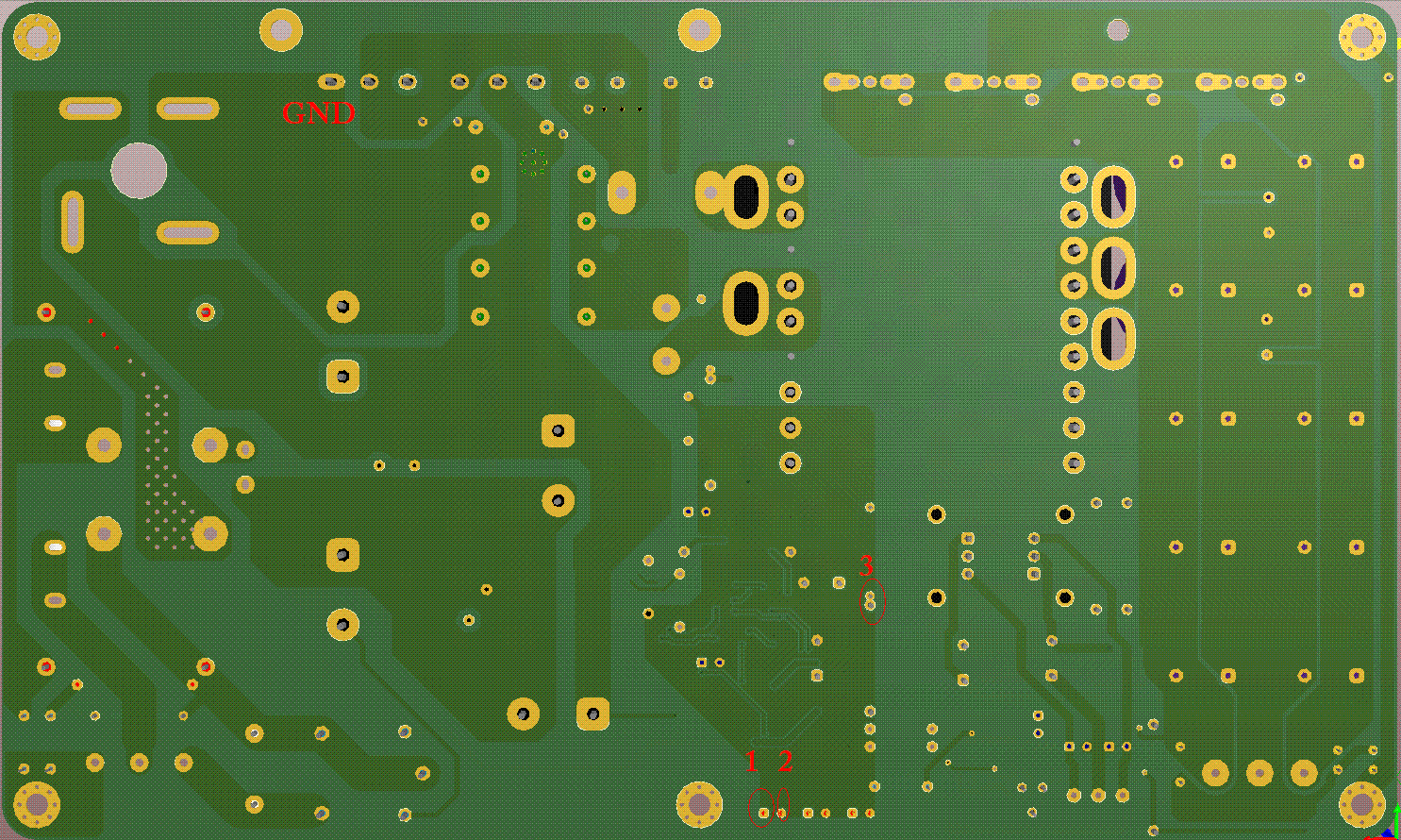

Rarkov, you said that SMPS2000R was for universal mains....are you sure?.....the following article, in the "frequency and gain" section , points out that universal operation is not possible with LLC Resonant converters....
Using quasi-resonant and resonant converters
I think specifying "universal mains" might give the wrong impression. It works at two nominal voltages - 110VAC and 220VAC. Every SMPS2000R has a 0.25" faston tab that can be soldered to through-holes in the board which are located in the center of the primary-side cap bank. By soldering this tab in place you would be enabling the voltage doubler circuit. The switching transistors want to see a constant ~300VDC. If there is a voltage drop here, the output voltage, and thus output power will begin to sag.

Sorry I've been quiet on this subject. We have decided it would be best if the board was sent back to be checked. I should have sent it already, but what with Christmas & work etc. I'm being a bit slow. Hopefully this weekend will see it shipped.
I have to say, the packaging was excellent, although it had been opened by customs and the broken board has some small cosmetic damage to one of the transformers (the plastic has broken slightly). I'd be amazed if that were causing any problems but I guess you never can tell...It may indicate a cracked board?!
I double checked the 110v/220V tab (never saw those despite a hunt) and they are both unsoldered. I assume that's correct for 220v since one of the boards is fine.
