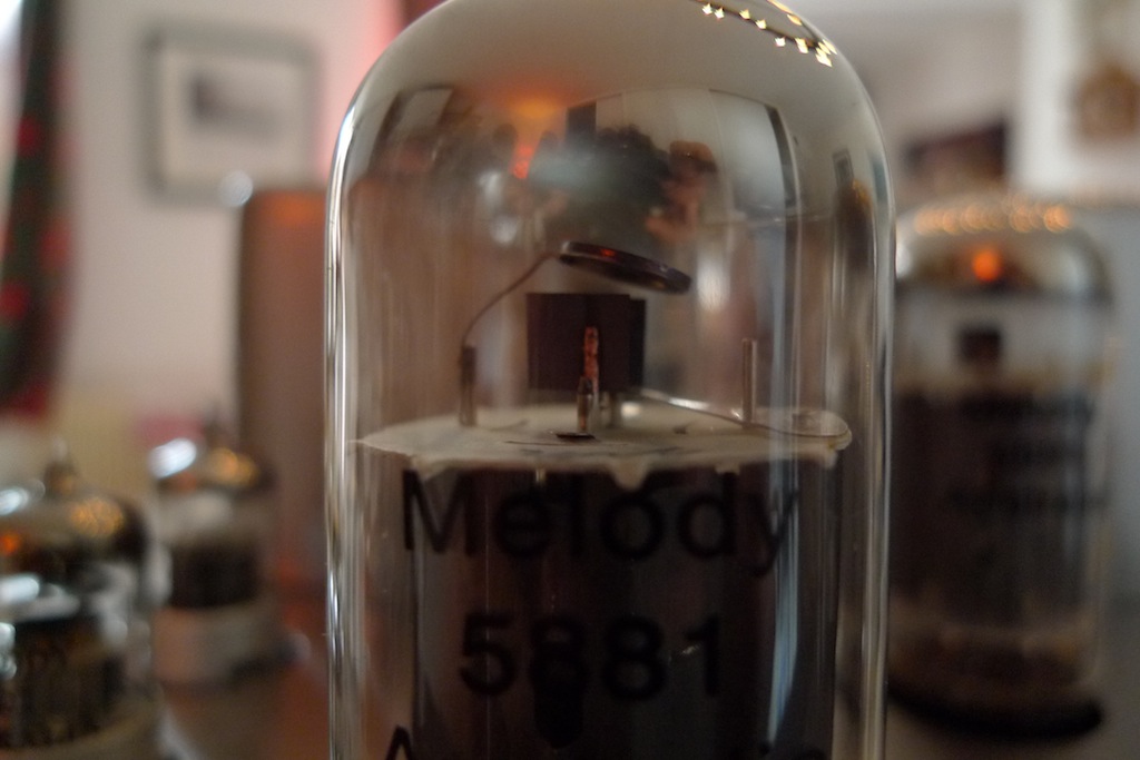

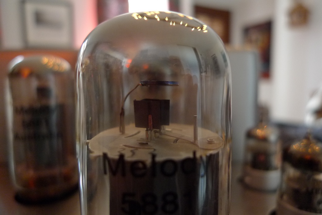

Hi, I received today my Onix SP3 and I have a question regarding a 5881 valve.
As you can see on the first picture, the upper "part" seems to be bent 🙁
Can I switch on the amplifier or the valve has to be changed 😕

The upper part is called the getter.

After construction of the tube, it has no influence on the working of the tube.

Yes, that's the getter mounting structure, and it does look badly built.

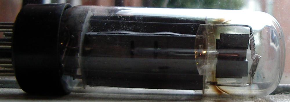

I have seen Chinese EL34s built like this. when one got too hot, the getter arm softened and fell into the 'flags' (grid heatsinks). The getter arm is connected to the anode, so the result was a spectacular BANG!
O, look, I found the photo of it! see how the top getter is shorted to grid1 😱

Actually the weld on the first tube looks better than the second one. Getters don't have to be perfectly straight. In Rod's pic the getter is so close to the grid fins that any expansion of the copper grid support rod could have caused grid cooling fin to getter contact. IMHO you should be fine but if the weld doesn't look good to you, as you are much closer than I, or if it makes you feel better, then by all means you should replace the tube(s)!

the shown 2 tubes are 5881 made by shuguang factory, china and then custom branded. They are a bit sloppy manufactured and their getter is always "thin" and a bit transparent. I abiused them with higher screen grid and plate voltages, about 10% higher that rated, but worked fine.but their life, due to little getter and maybe vacuum problems may not be very long.
