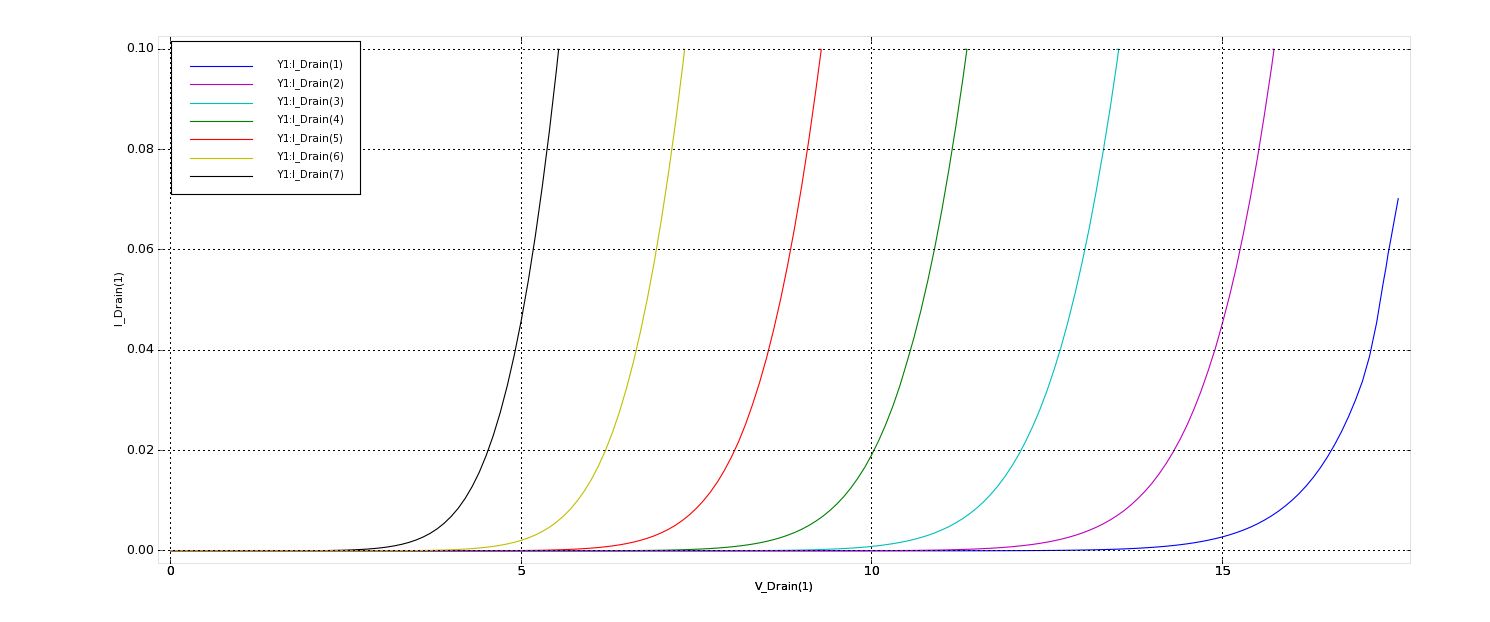

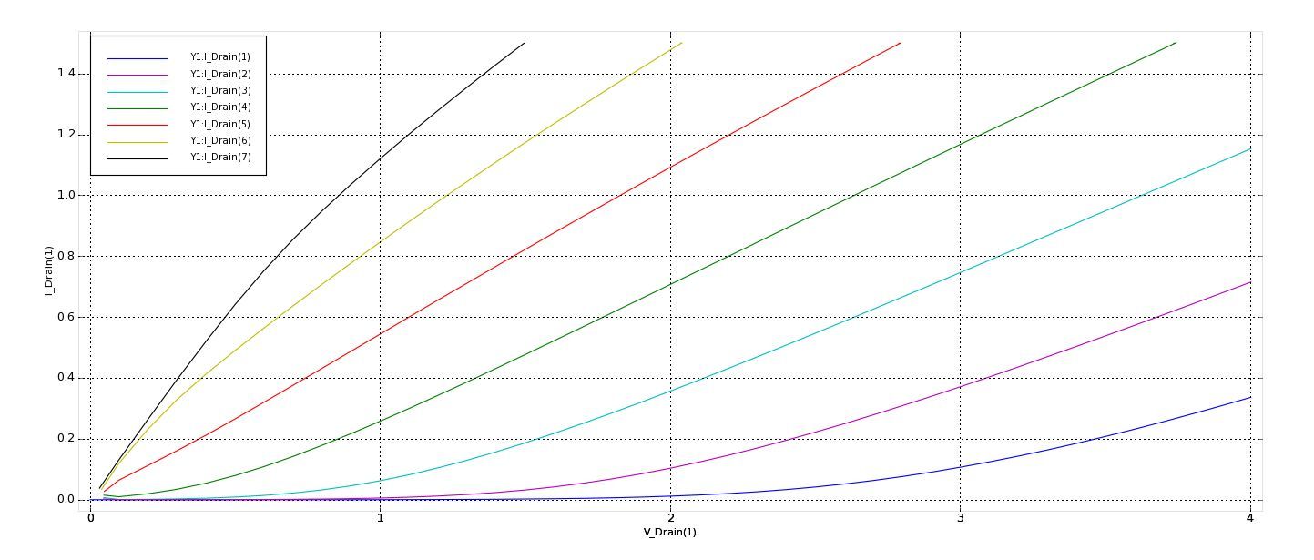

I have purchased some of all of these and confirmed with a curve tracer that they are genuine SIT.
Zen Mod and MR have posted SIT DIY designs that you can build today.
