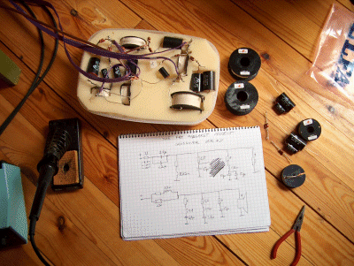

I finished preliminary web page on my Fat Margaret Loudspeaker Project...
http://www.hifiklubi.ee/fat_margaret_project/
The design is closed box standmounter using Seas W17E-002 woofer and Seas Millennium tweeter.

I love the look of the cabinets
what materials or finish did you use?
My current project is only lacking a decent finish.
MDF cabinets , i do not want to veneer.
regards David
regards David
Spray on goop
Looks like Texcoat / Stonecoat available from Homebase . Can be expensive , even spraying a small pair of cabinets with the stuff but gives a nive finish

I used a granite texture spray paint.
http://www.duplicolor.ee/tooted/granit.htm
And no it is not that expensive, at least here in
Estonia. One bottle is approx 10$ and I used 1 bottle per box.....

Choosing baffle width
Hi, Ergo
I read how you did your measurements. I have a question: with your rounded box, how did you decide what baffle width to specify in your baffle step simulation?
Regards
Hi, Ergo
Regards
Lower part of the frontside around the woofer is 18cm wide. So this is the value I used for calculating baffle step.

The small crack started at woofer hole and ran horisontally in the middle of the mdf panel not the line where the continuous panels are glued....
So the wood glue holds the thing together just fine but mdf itself with it's small fiber structure is not strong enough. I suggest it is wise to use metal rods in such box design even if you first don't see any signs of weaknesses. Someone here on the forum also told that a guy he new built a subwoofer box like this, but then dropped it and it broke like an egg.
