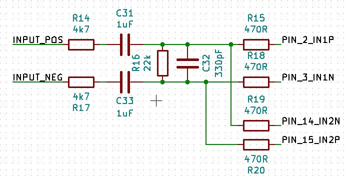

2) Add series resistors to the input pins (2,3, 14, 15) of 470R. This helps keep down RFI from being coupled to the inputs from the output wiring.
Do those go before or after the DC-blocking caps? Also, in BTL mode, where the inputs are wired in anti-parallel, is it necessary to put those resistors in front of all four pins, or is two sufficient?
Also, after giving this more thought, I decided the 36dB default gain (for balanced input) is way too high (for me). I'm copying the gain-reduced input circuit from AN10436, figure 25, page 27. (Similarly covered in the datasheet on page 25.) Basically, it's a voltage divider.
When using an arrangement like this, would you still recommend resistors in front of the input pins? Or will the gain-reduction voltage divider also help with RFI suppression as well?
See attached schematic - you can see those 470R resistors right before the chip pins on the right. Is that right? Or should they be omitted entirely, or moved elsewhere?
The schematic you've shown is the way I'd do it - each pin having its own R. We want the R to be as close to the pin as possible. Yes the external attenuator will definitely help with the RFI attenuation. I see you've added a shunt cap to further attenuate the HF noise.:up:

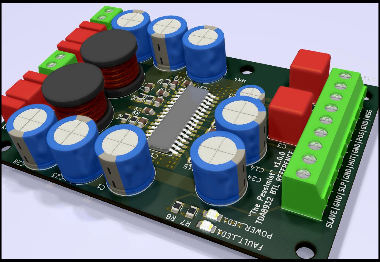

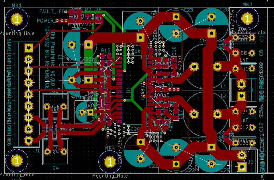

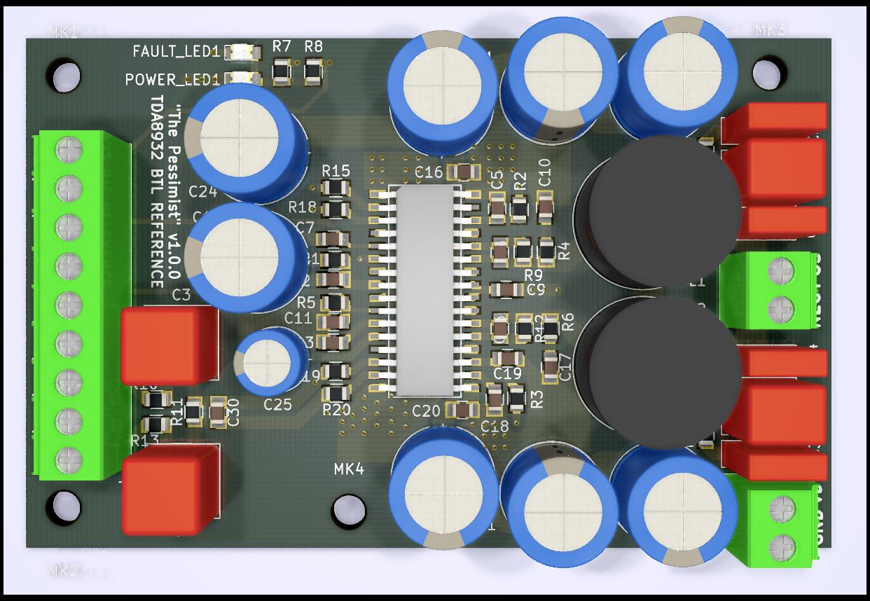

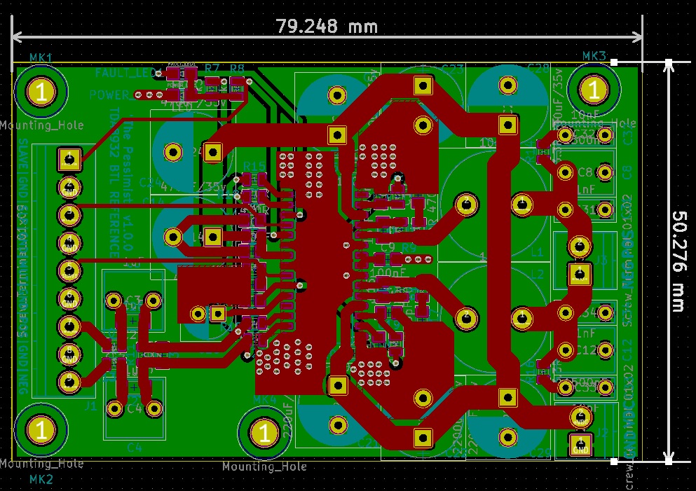

Scope creep got the best of me. Changes from the previous post:
  • I went ahead and added the TI TPA-style RF filter on the output (easy enough to omit or remove if desired).
  • Added the gain-setting resistors. As drawn, this will set the gain around 26dB, instead of the default 36dB.
  • Added 470R series resistors in front of input pins 2, 3, 14, 15 per Abraxalito's suggestion.
  • Added a 470uF/6.3V electrolytic to pin12 (voltage ref).
  • Added two 10mm electrolytic caps for pin8 (analog voltage supply).
  • Reduced input DC-blocking cap footprint. Won't be able to fit polypropylene caps, but can still use smaller film. Also have footprints for 1210 SMD caps which can be used instead.
  • Removed 16mm PSU decoupling caps in favor of two more 10mm caps. Easy enough to add off-board capacitance if this is deemed necessary.
  • Inductor footprint assumed to be Coilcraft RFS1113. The footprint is actually slightly bigger, so there's a little room for experimentation or substitution.

I found your older post saying the additional capacitor to pin12 should go in parallel with the old one and assuming pin8 addtional capacitor should go to pin9 I've made this quick sketch over the photo. Are the connections as pictured correct and rational and is the polarity of capacitors right? Yellow "things" are mimicking the added capacitors. If it's so, I'm gonna get soldering done tomorrow and write back with the impressions afterwards.

1) You won't need the 4 electrolytics ( C1, C21-23) on the main supply. Suggest just one 2200uF and put the two smaller ones where it really matters, on pin8. Or just go with one 470uF/35V on pin8. I'm assuming this is one of your 80/20 designs and you don't want to go to the trouble of a separate regulator for the pin8 supply :D
TPA3118 has a similar structure in that there's an analog supply rail for the signal level circuits (pin17, AVCC) but there's zero additional decoupling for that pin on most boards. TI's application circuits don't suggest it needs anything extra. NXP on the other hand do add a 10R series resistor and a cap specifically for that pin (pin8).
I did mod my first TPA3116 with extra decoupling for pin17 and it gave a substantial improvement. Its a tricky mod to do though as you need to lift the pin from the PCB. Given the 10R resistor isolating pin8 from the main supply on the typical TDA8932 board, the addition of decoupling caps to that pin is much easier. They go from pin8 to GND, the value I'd suggest as a minimum is 470uF.
What is the purpose of that 10R in front of pin8/VDDA?
I assume when you add extra capacitance to VDDA, the 100nF to filter any HF noise that got picked up along the way.
But does the extra capacitance go "after" the 10R (i.e. in parallel with the 100nF)? Or "before" the 10R? In my schematic above, I put the extra VDDA caps "before" the 10R, and now that I think about it, that's probably wrong, as the result is simply more caps added to the main supply.

Together with the 100nF on pin8 it forms a low-pass filter to keep the highest frequencies of supply line noise from reaching pin8.
I meant the extra caps to go 'after' the 10R, i.e. in parallel with the 100nF which is already there. This lowers the corner frequency of the RC filter, which is set way too high in the standard application schematic.
Looks like you found pin12 OK. The cap is physically much bigger than you need here (1000uF/35V vs 470uF/6.3V) but it should still work fine assuming it doesn't fall off under its own weight :eek:
Looks funny even to me, I posted the picture and immediately noticed it by myself :D I already changed it with 2200uf 6.3V Nichicon. I also soldered Nichicon to Pin12 of tweeter amplifier and when my damn head recognized it's unneeded there I tried to unsolder it and peeled off the pcb trace. Luckily, after half an hour of soldering I fit a wire jumper between the damaged trace. Anyways, after that I soldered the 35V 1000uf straight from Pin8 to Pin9.I screwed back my backplate, turned it on - nothing, complete silence. I unscrewed it back, left it open - working as it should be. It comes out it was two backplate screws very precisely snapping the wires of both amplifiers, I guess I am one of those who could win a million in a lottery? Well, after that, happy it didn't go kaboom, I moved the amplifiers farther, and screwed it back together.

Cool, thanks for the explanation. I corrected the schematic and updated the PCB layout accordingly. I went ahead and put in the order at the fab house! I also ordered a couple of the cheap blue Sanwu boards for comparison. The BOM cost for my PCB is over $50 (though i spec'ed expensive organic polymer caps). Still, even with regular electrolytics, my boards will be 10x the cost of the cheap boards from China. I doubt they'll sound 10x better, but knowing I'm running my own design has a value beyond dollars. :)
