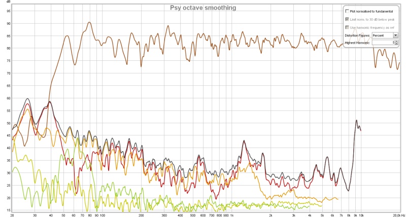

Dear All,
let´s continue with some work in order to get the Fast 5 in a state where it´s listenable.
First the BSC, after some attempts, 1,2 mH and 5,6 Ohm seems to be about right.
Normally, a small cap is also needed to turn this into a contour filter and to avoid too much treble attenuation, but it seems this is not needed here, we´ll see later.
All the best
Mattes
Dear All,
next step: a second parallel notch takes care about the 9 kHz spike. Values are 1,8 Ohm, 2,0 uF and 0,19 mH. The region around the spike is also slightly attenuated, that´s how it is...
Some people prefer serial LCRs for shaping, but as long as we have significant R in series with the speaker, we can use parallel LCRs.
Later impedance measurements will show if we´ve run into trouble with this configuration.
One important hint: all parallel Rs are total R, that means R of the coil and R of the resistor together.

Dear All,
after the 2 notches, we have slightly falling response and not too much treble.
Experience says that due to directivity in the treble, a slightly rising response is favorable with FR drivers.
So, the 2,7 uF cap which was omitted a few hours ago found it´s way back into the filter.
I think that the result looks quite OK, we have +- 3 dB in the room between 50 Hz and app. 13 kHz, distortions are OK, waterfall doesn´t show anything to worry in the mids and highs (for a paper FR driver).
That was the easy part, now we have a base for further finetuning and matching ones room and taste.
I will stop here, I won´t have the time for tuning by ear before april, and even if I had it, my final results will probably be irrelevant for somebody with another enclosure, room and taste.
All the best
Mattes

Dear All,
please disregard my last post, I have mixed up my cables.... shame on me!
I´ve thought 2 minutes about the problem, then it became clear that I´ve attached the cables for the impedance measurement AFTER the BSC and not before it, that couldn´t work...
So, also the final impedance check is OK, as attached, impedance drops to 6.something Ohms in the treble, that should be OK for every amp, and I´m happy as well, as I didn´t have to worry until april what went wrong...
