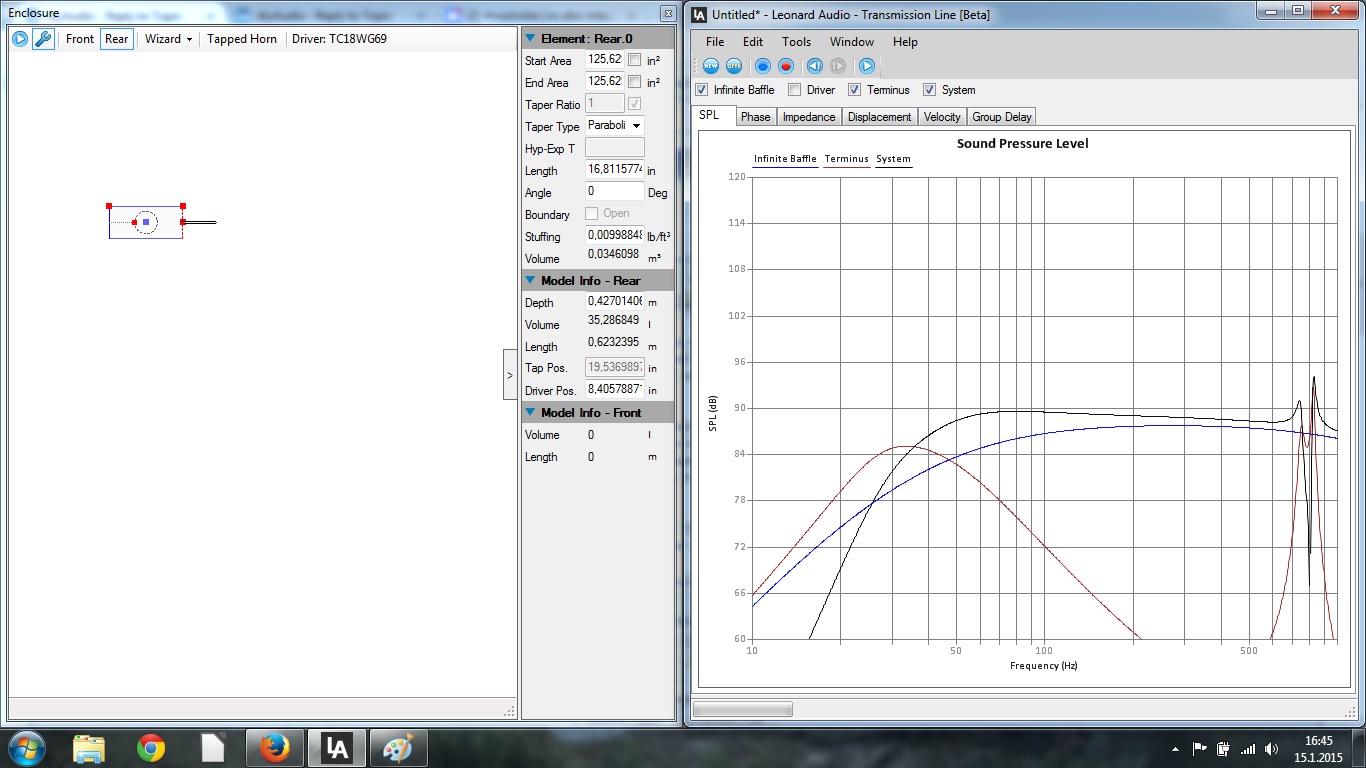

What I'm still wondering is if I should place the woofer on a ported or a transmission line enclosure. I'm using the "Transmission Line" software to model the enclosures. Both yield a large, about 80l enclosure but size isn't a constraint on this build. Building a ported enclosure would certainly be easier, but I'm worried the bass will sound loose and boomy with it. Building a tapered TL would be quite complex as I'm aiming for about 1m high enclosure (and the small enclosure for full range on top), and folding the line along with the taper is a real pain in the *** to design and draw. Also the peaks and dips in response before the crossover in transmission line makes me want to rethink the type. The attached pictures are the enclosure options that cause me sleepless nights 😀

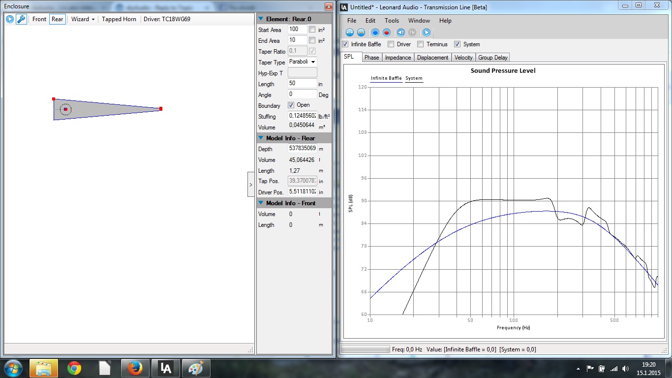

As far as a TL variation is concerned, you could try a 10:1 taper ratio; 100in^2 throat, 10in^2 terminus. Axial length 50in on centreline; fold as desired maintaining the cross-section appropriate for that part of the line. Offset driver (centre) 5in down from the throat. Lag all internal faces with 3/4in acoustic fibreglass, Ultratouch, BAF or similar. Excuse the lack of optimisation, I'm pressed for time, but it should be a decent starting point.

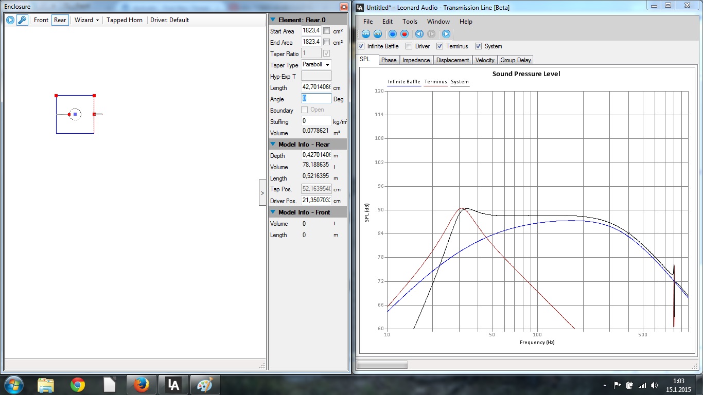

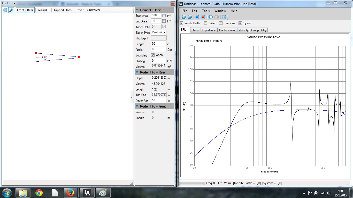

What I don't understand is what you mean by 72l 32Hz enclosure being meaningless? It gives a good response on paper with slightly lifted bass at around 30Hz. On other hand, 35l at 32Hz gives a good slightly dropping curve. Would you consider the bigger enclosures peak disturbing in use? Picture of simulated response attached.
Thanks as well! I simulated this enclosure type, but I fail to see the good points in it. Maybe I didn't understand your explanation properly. Picture of simulated response attached.

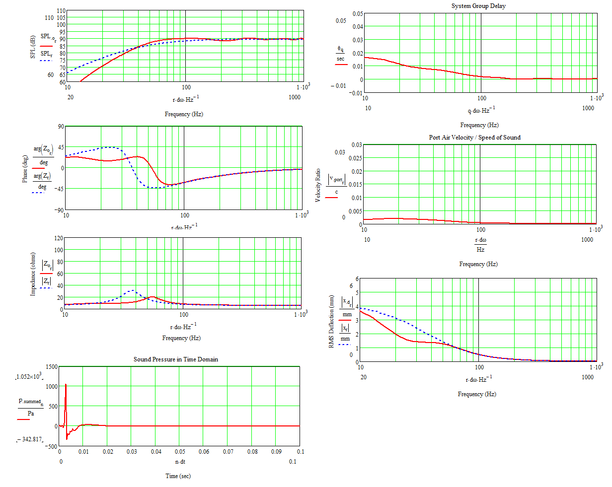

Nor can I in the graph you post with a completely undamped pipe of different CSAs and length to the one I did above. 😉 See the plots I provided; this is with a line properly damped. The 'good points' should become fairly apparent: relatively flat amplitude response with little harmonic ripple, very flat / unreactive impedance load, reasonably well controlled driver behaviour (the two go hand in hand), decent GD with little ringing in the time domain, low terminus air velocity...

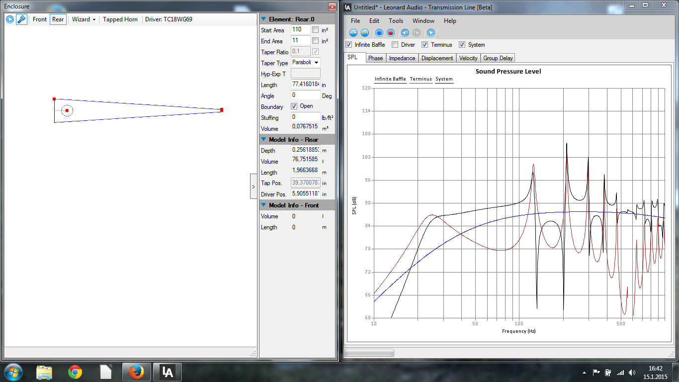

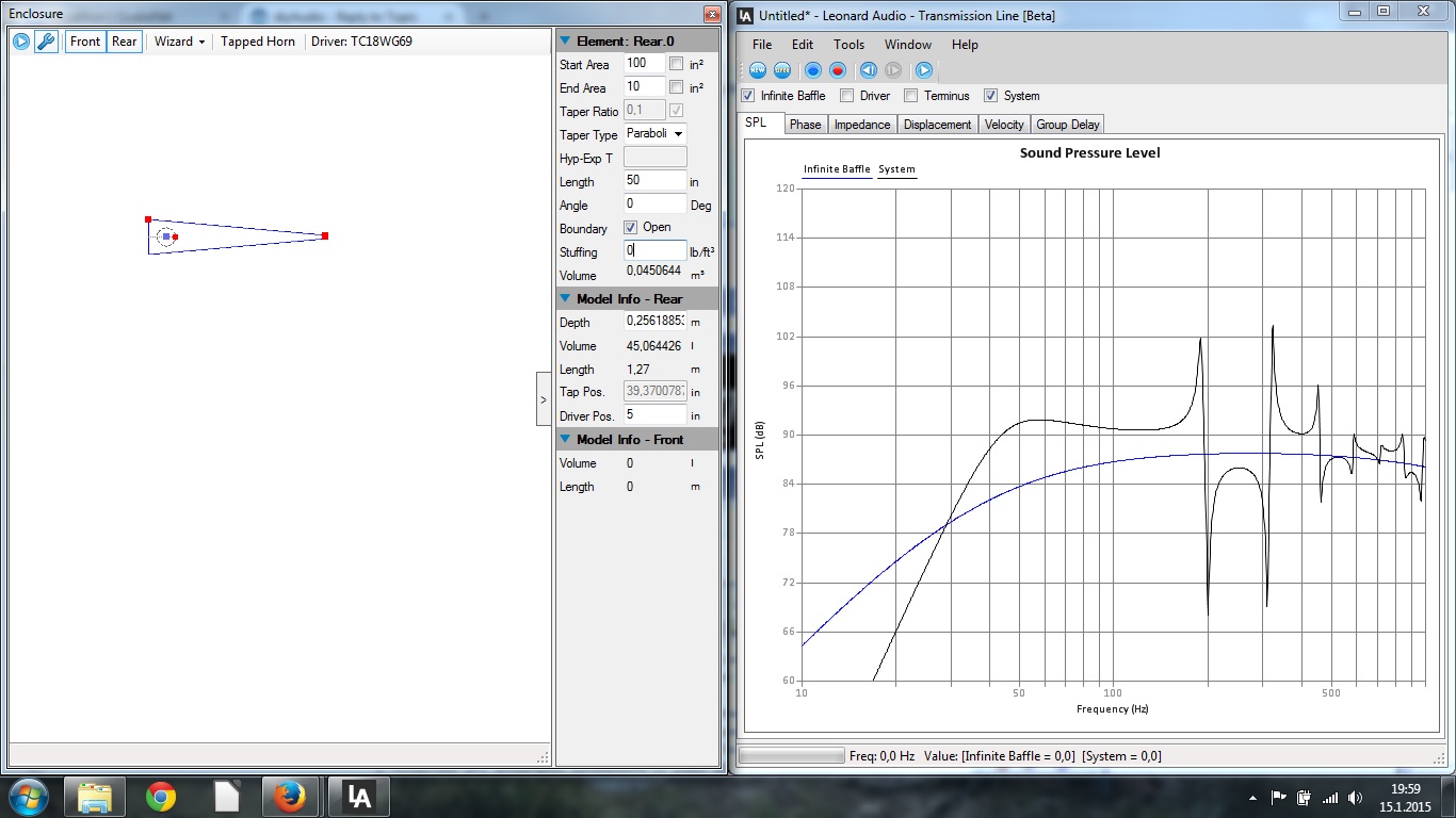

I blame sleep deprivation for my mistakes 😀Nor can I in the graph you post with a completely undamped pipe of different CSAs and length to the one I did above. 😉 See the plots I provided; this is with a line properly damped. The 'good points' should become fairly apparent: relatively flat amplitude response with little harmonic ripple, very flat / unreactive impedance load, reasonably well controlled driver behaviour (the two go hand in hand), decent GD with little ringing in the time domain, low terminus air velocity...

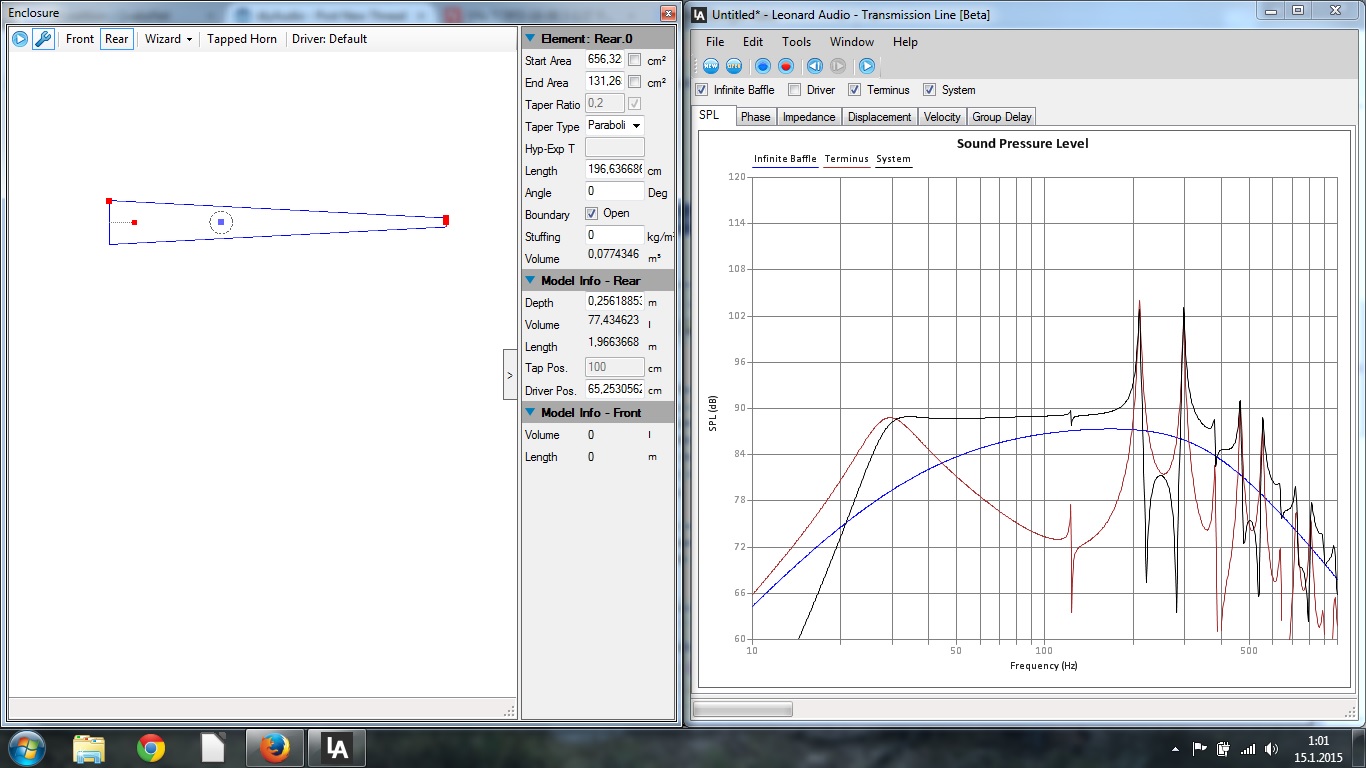

This time the graph is with real CSA and lenght. Looks a lot more like the ones you posted earlier. Damping is an interesting question. Previously, when I made a TL with Peerless P830986, I added damping only to areas that were the quarter wave "opening areas" of the harmonic peaks in the frequency graph. I applied 0,12 lb/cf of acoustic pillow padding. To my ear, it sounded a lot better than damping 2/3 of line lenght as per rule of thumb. I didn't have my measurement equipment at that time so I can't confirm how well it worked with measurements. I wonder if this kind of damping method actually works or was the difference only imagination.
Oh it certainly can -varies depending on design, the materials employed &c. The one I did above is nominally damped throughout for instance.

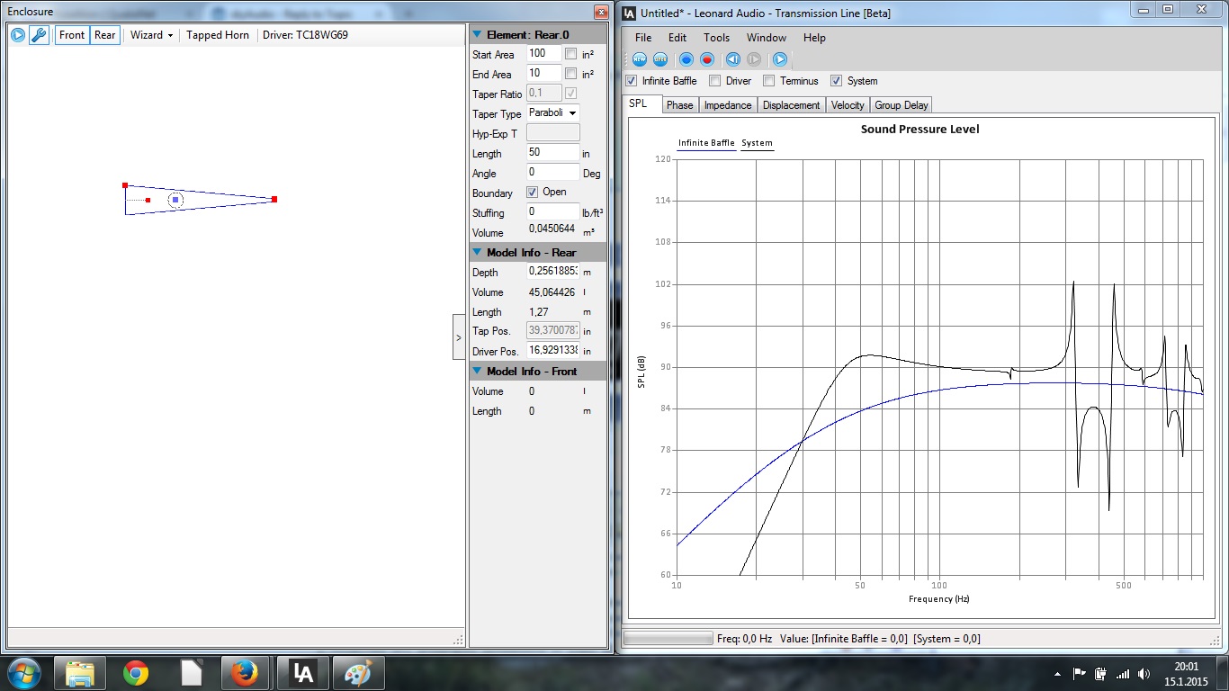

Follow-up question about the 1:10 driver alignment. I have never seen this type of alignment used in TL design (probably because I'm a newb). Why would this alignment be superior over the 1:5 bjohansen favours or the classic 1:3? Attached SPL undamped simulations of them all.Oh it certainly can -varies depending on design, the materials employed &c. The one I did above is nominally damped throughout for instance.
Edit -I see what you mean, you're talking about the driver tap location. Different set of compromises, in this case for convenience. I did say it wasn't a fully optimised design. With that said, there is no one universal 'right' and varying positions have slightly different properties. The 5in location works OK once the line is damped properly, as shown above. I rarely favour a fixed place based on axial length alone.
Ignoring other issues and arguments: a TL 1.27m long is too long IMO, unless it's for a subwoofer. You will have anemic midbass and fatiguing sound. It won't be fun until a random low note comes up at around 50hz, which will sound good.
Interesting. What kind of enclosure would you recommend this bass driver to then?Ignoring other issues and arguments: a TL 1.27m long is too long IMO, unless it's for a subwoofer. You will have anemic midbass and fatiguing sound. It won't be fun until a random low note comes up at around 50hz, which will sound good.
Hmm. 'Anemic midbass and fatiguing sound.' If you say so Greg, but nothing in the design I did above, or 15+ years of designing TL variations leads me to believe that will be the case here. It's a nicely damped alignment to blend with typical room gain, has very little in the way of harmonic issues, and is an extremely unreactive load. Not a bad combination of characteristics.
72L is meaninglessly too big for the driver, It has a Vas of 44L
and would work fine in a sealed and well stuffed 14L/0.5cuft.
You want Vbox < Vas for good bass linearity and to reduce tuning
variations due to driver variability. Like I said, 28L tuned to 34Hz
is a good choice, the droop will work with room gain very well.
28L is still a big cabinet for a 6.5". The bass bump is minor.
rgds, sreten.
