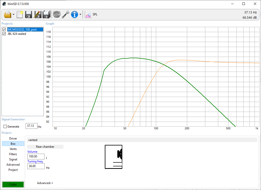

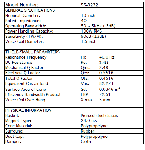

MCM 55-3232 10" woofer

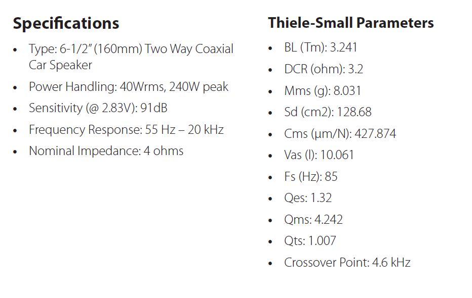

JBL 624 6" coaxial 2ways

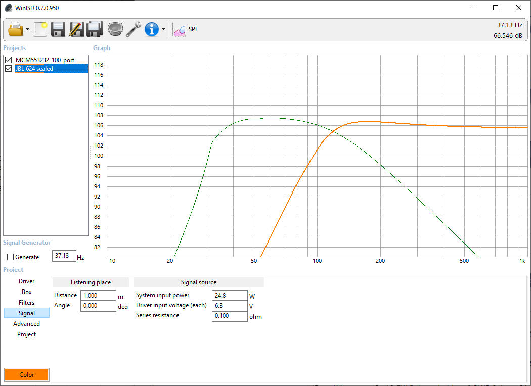

Here are my winISD graphs.
I've put 2nd order butterworth at 120Hz for the crossover.
First question:

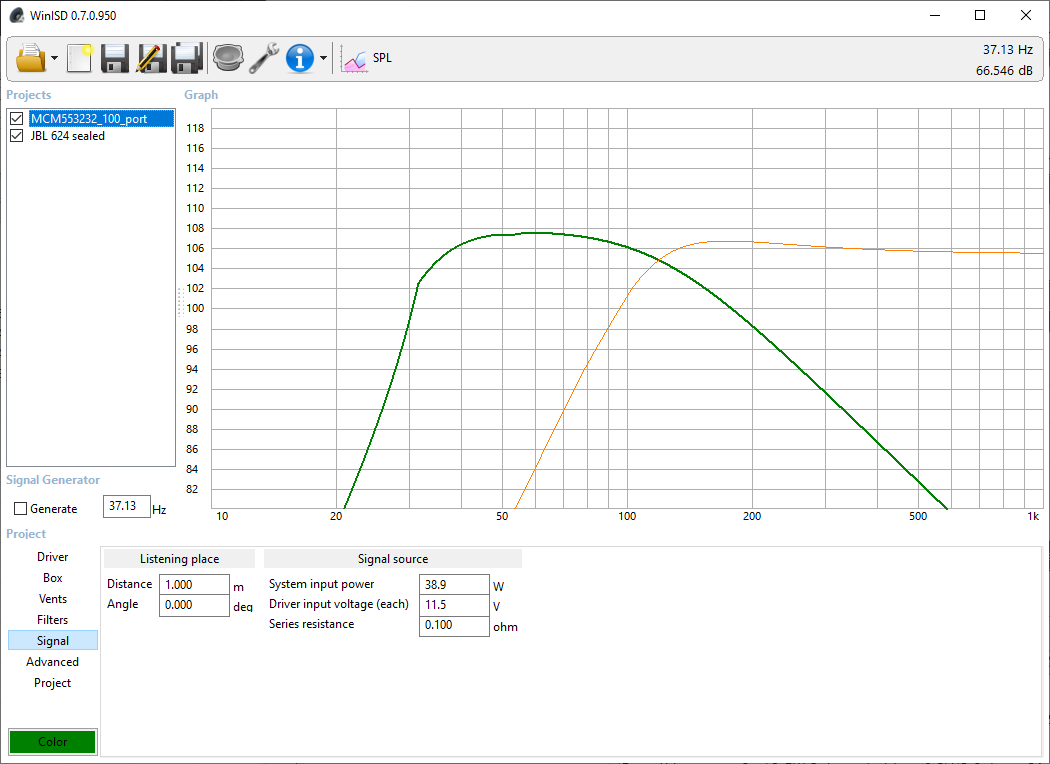

I've set the signal level as 39W for the sub, which is just hitting xmax (5mm) at 50Hz. And then for the pair of JBLs an appropriate level is 25W which gives a driver voltage of 6.3V
Does this mean: 2x 12.5W ? ie each driver 6.3V/3.2ohm =2A ( =12.5W)
and for the 10": 11.5V/3.4 = 3.4A (39W)
Is my 24V 6A power supply deficient in amperage? I chose it looking at the power 150W thinking I'd be running 2x25W + 80W or something like that.
