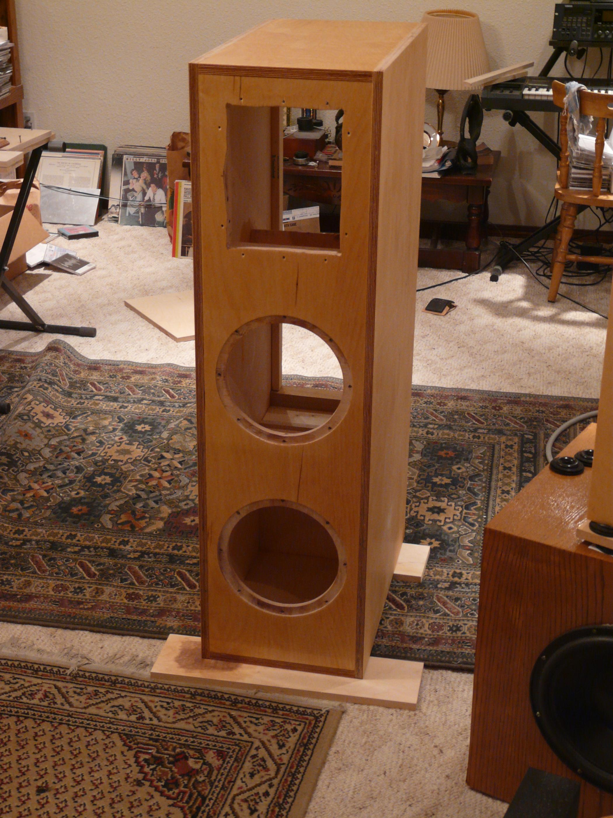

Probably, but won't it also depend on the crossover and the amount of phase shift? No issue with timing so far. No smeared transients. But the woofers are still changing so time will tell.
The boxes were built like this to allow for changing the baffle to accommodate different hf drivers. Just change the baffle boards rather than the full front panel.
Troels recently posted a speaker that actually used this type of setup to time align the drivers. The bass and mid-range were on the same plane with the tweeter set back. One advantage was that it allowed him to chamfer the baffle surrounding the mid-range which should improve diffraction. Dave has largely exploited this technique and has taken it one step further with his new MarKen T. Thanks again for the effort that we will all benefit from.
http://www.troelsgravesen.dk/Jenzen-SEAS-ER.htm
Thiel has been doing that for as long as I can remember. But as this is only a test system, I'm still free to create a baffle with the tweeter set back from the mid. With a low crossover point the wavelength is long enough that the woofer / mid crossover is mostly pretty much a non-event from a timing perspective.
Looks great. Shouldn't the FR be set back from vertical LF plane vs forward?
If Bill is XOing them at 160 Hz then a 1/4 wl is almost 19". Time alignment is a non-issue as configured.
