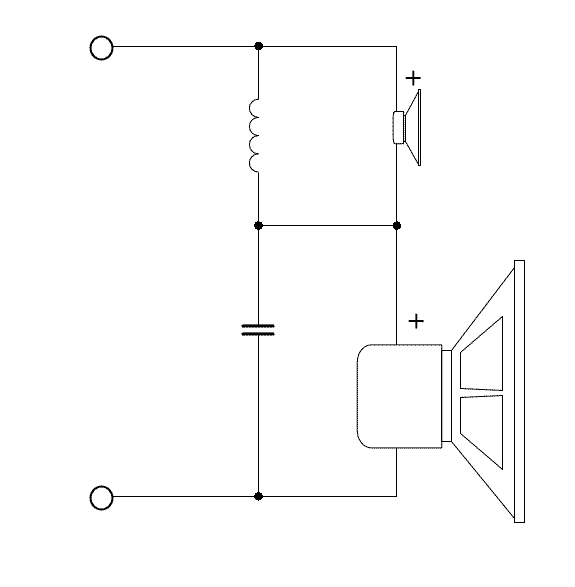

This is a generic series XO. Does not show a Zobel on the woofer (which could be important) and assumes that the resonance of the midTweeter (tweeter) is somehow suppressed (i use aperiodic midTLs to do this, which have other assets as well) or any attenuation on the midTweeter (an L-pad or series R).

Series XOs is a thread in its own right.

Oh I see!
It's a series crossover because the tweeter and woofer are literally in series with each other. And a parallel crossover has the drivers electrically separated at the crossover. Which is why a change in the series crossover affects both drivers' response.
Please tell me I'm right, I feel so smart right now 😎

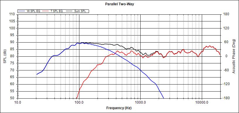

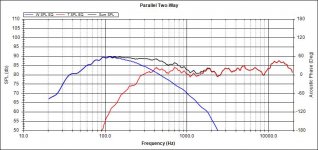

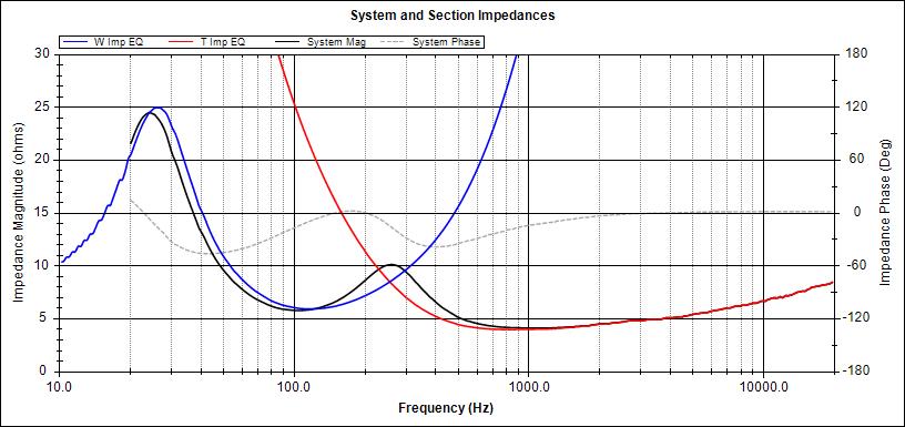

Ok, I'm back; sorry for the delay.
I've been playing with the parallel crossover to get the turnover point to about 350 as suggested. I have a 2nd order BW on both the Alpair 6m and the RS225-8. No zobel as it didn't seem beneficial. I enclosed the winPCD files in case you wanted to play with it.
LP: 6mH 50uF HP: 2mH 60uF
As far as the enclosure is concerned, I wanted to make these floorstanders. So I was going to make a tapered TL (TQWL?) at a 10:1 taper ratio. About 36 inches tall (~0.9m) with a single fold to make a line length of about 70 inches (~1.75m) for an F3 of about 30. I've enclosed the Leonard Audio TLbeta file I used as well.
As before, I'm open to any and all suggestions on both crossover and enclosure!
