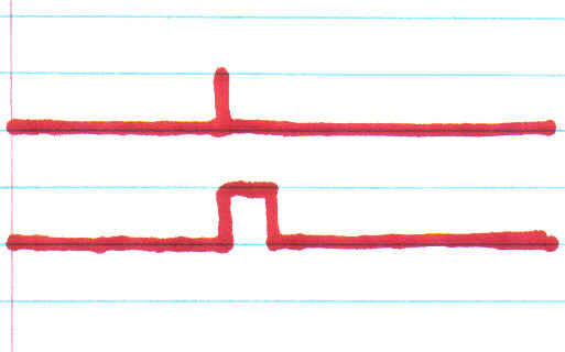

The ideal unit step response is y=0 at t<=0, and y=1 at t>0. It has a DC component. So a speaker cannot reproduce a perfect step response. The response from a speaker will most likely look like this: it goes up very fast immediately after t=0, and then graduately come back to 0 (it may take more than 100ms). Mathematically, it is the integral of impulse response. That means its spectral energy is inversely proportional to frequency. Am I on the right track to answer your question?
Brian Ding
Rythmik Audio
Basically it's just a spike right? I've drawn two ideas of what I concieve it may look like. The first I believed was an impulse or transient signal, the second is more/less a half cycle of a square wave, but mostly just the only other idea I had of what the signal might look like.
OOps, i kinda forgot to attach the picture. Here it was anyhow. I know what you mean now though, Thanks.
