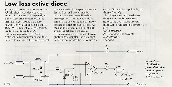

Hallo Bob,
what about a MOSFET rectifier (4 pcs low loss active diode)?
MOS-FET Rectifier
