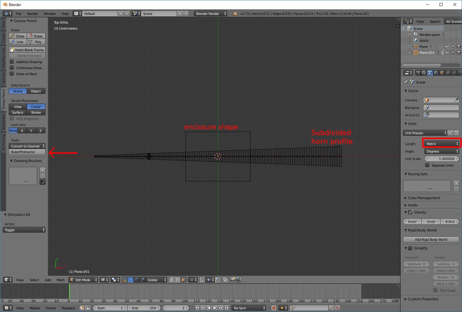

1. Create the horn profile - first it's best to set the scene units to meters (or other real world dimensions) on the right, then I created a basic plane and resized it to 1.2cmx180cm, then I scaled the right edge to 14cm in edit mode, this was my horn. The ruler/protractor tool (shown on the left) is useful to check that the dimensions are correct. Then I subdivided it using loop cut tool in edit mode, but there's also a non-destructive subdivide modifier which works just as well. Lastly I created another plane in the size of the final box (I knew the final size in advance, cheating).
715823d1542405776-fast-preliminary-horn-folding-blender-blender1-png

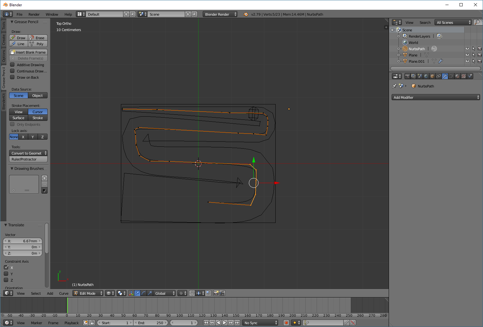

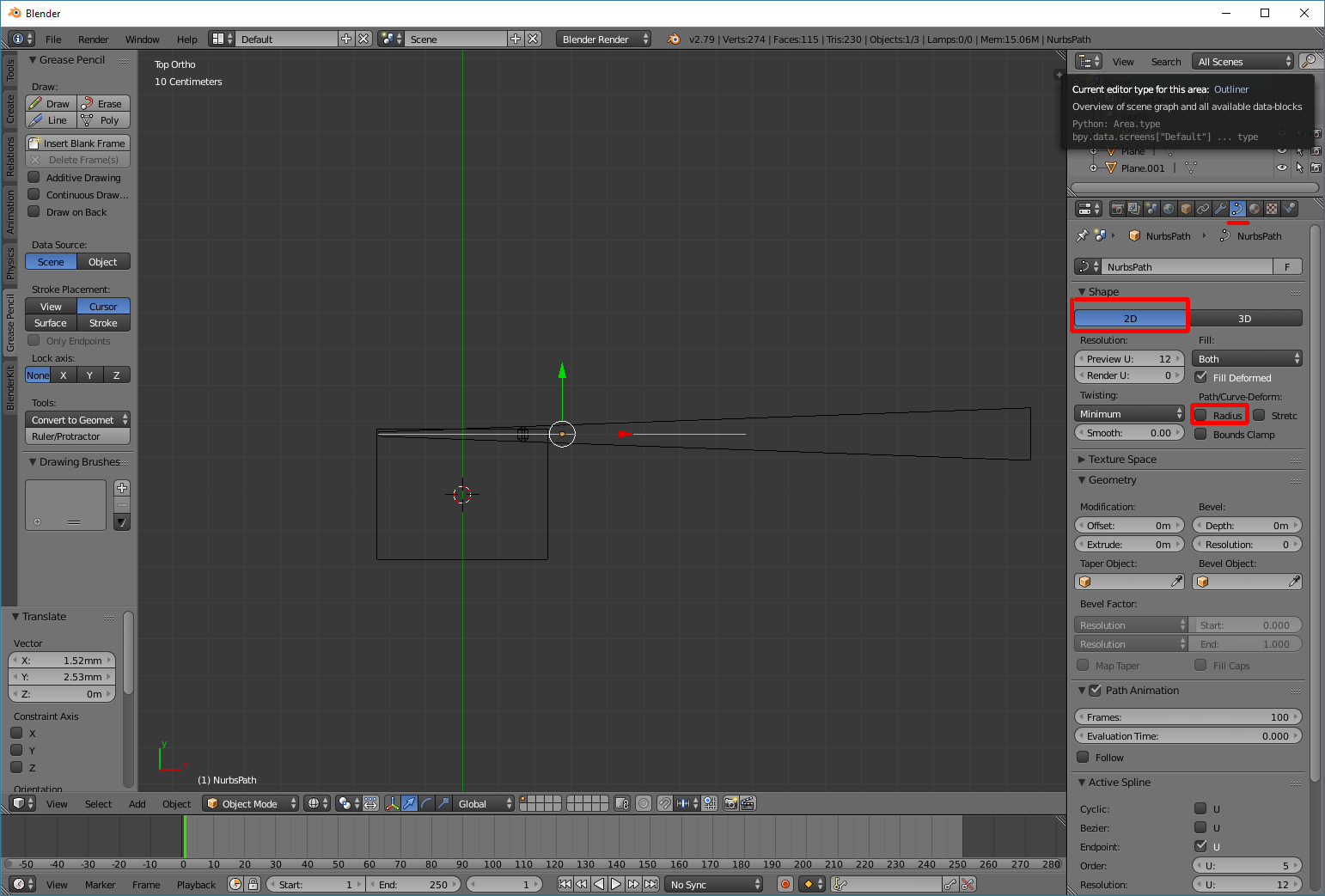

2. Create a path and place it in the middle of the horn (and place both in the proper place in the enclosure). Then select the path and set it up correctly (shown on the right).
715824d1542405776-fast-preliminary-horn-folding-blender-blender2-png

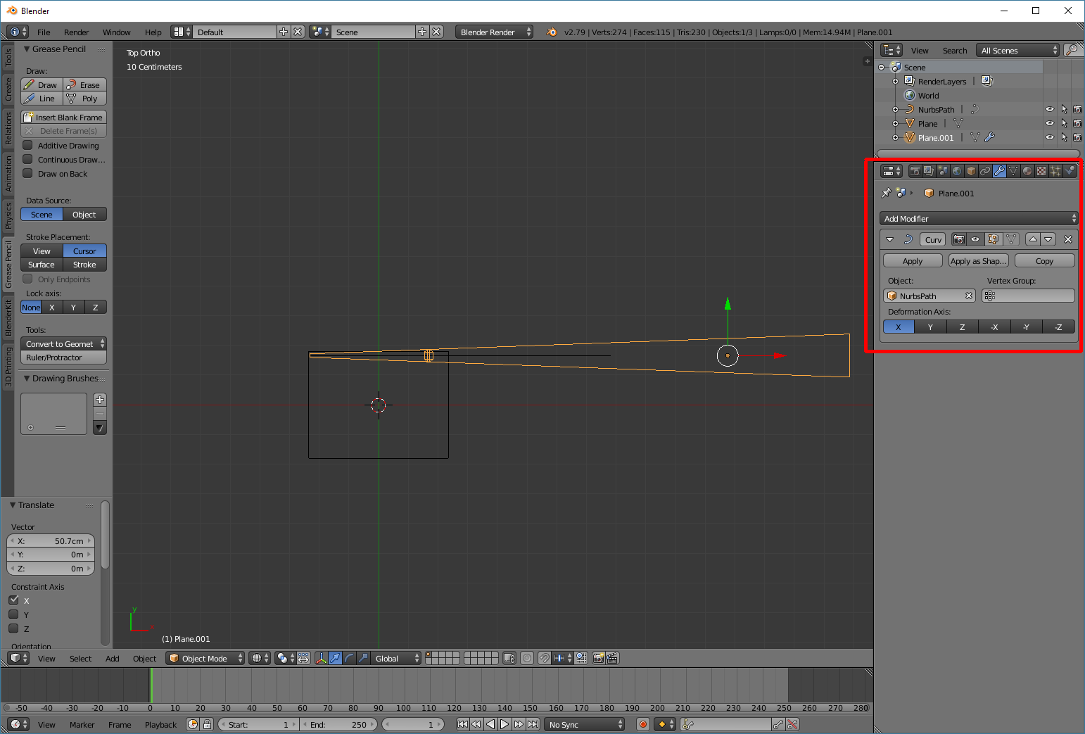

3. Select the horn profile, add a curve modifier in the modifier submenu, set it to use the nurbs path. The curve or the horn will jump a bit because both objects origins must be in the same spot, just move them in the correct place again.
715825d1542405776-fast-preliminary-horn-folding-blender-blender3-png
4. In the edit mode edit the curve and the horn profile should immediately be deformed correctly. You can add more points using extrude, move one or more at a time, rotate them... and the horn should fold accordingly while preserving the length.
715826d1542405776-fast-preliminary-horn-folding-blender-blender4-png
I didn't verify this precisely enough, but it seems that this method preserves the length of the horn, although unless "radius" setting in the curve parameters is unchecked, it affects the width for some reason.

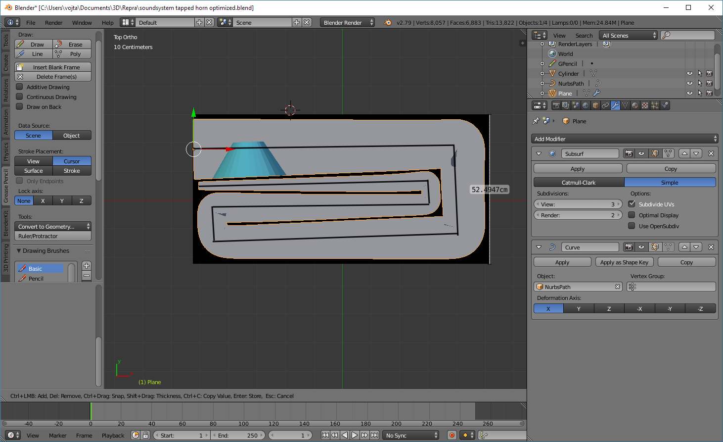

I know this probably looks complicated from my description, but it's totally worth it, here's another example.

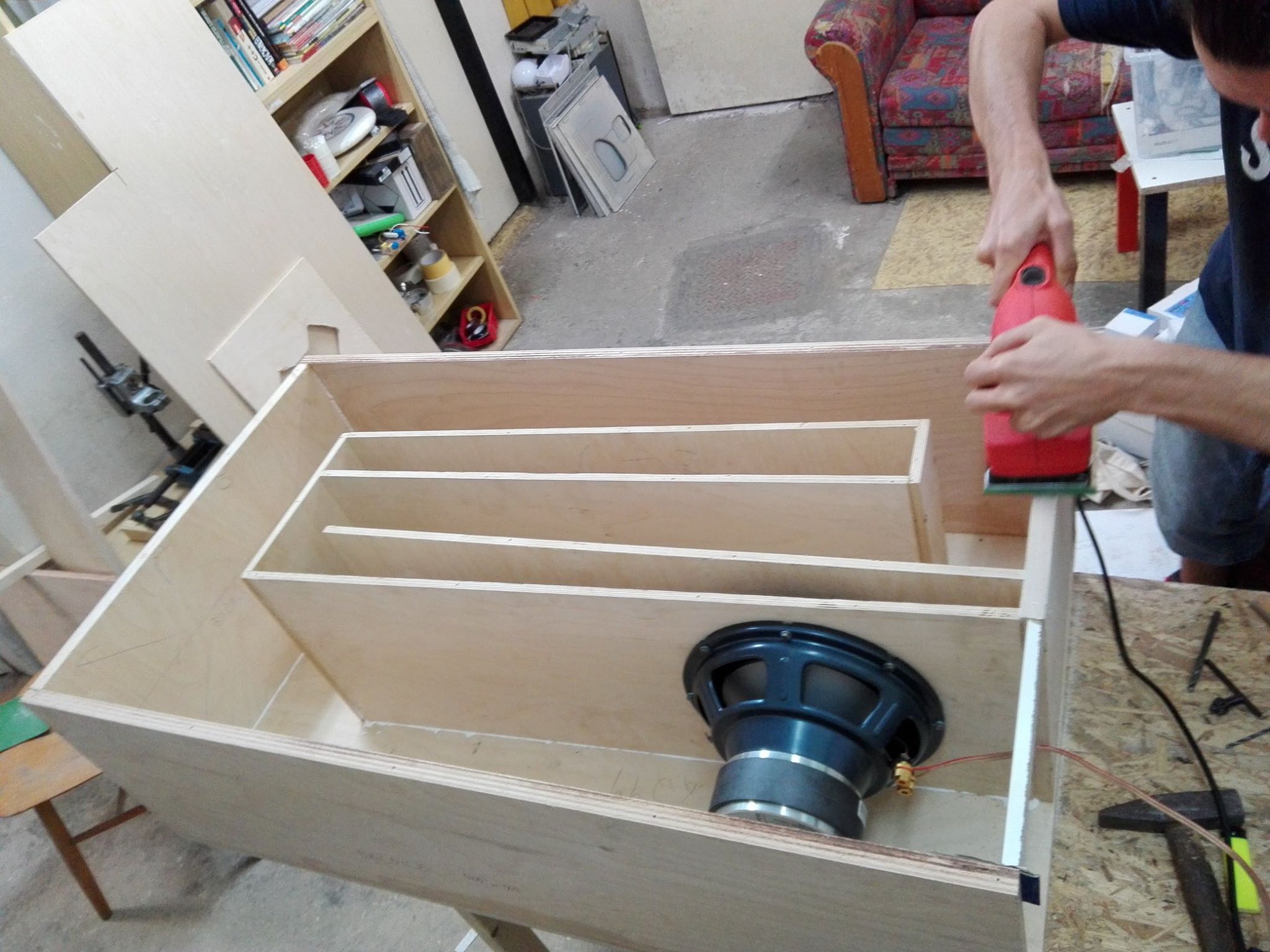

Years ago I was building my first subwoofer. It was a tapped horn designed in hornresp and I had a super-tight deadline, so although I spent half a day trying to fold it properly (something I have not done ever before that moment, learning as I go), the final version had a pocket of useless empty space:
attachment.php
Today I tried to optimize it to test this method, it took me about 20 minutes including setup and, what's best, it was FUN! The black lines were drawn in blender using grease pencil and measured using ruler/protractor tool - the length is correct, +-2 cm (out of 385 cm), although as you can see the black lines I drew as measuring guide are quite imprecise, so the reality might be a bit different. It would need to be redrawn in a CAD first to check everything properly but for getting from hornresp model to having something to draw and finalize this method is awesome.
attachment.php
