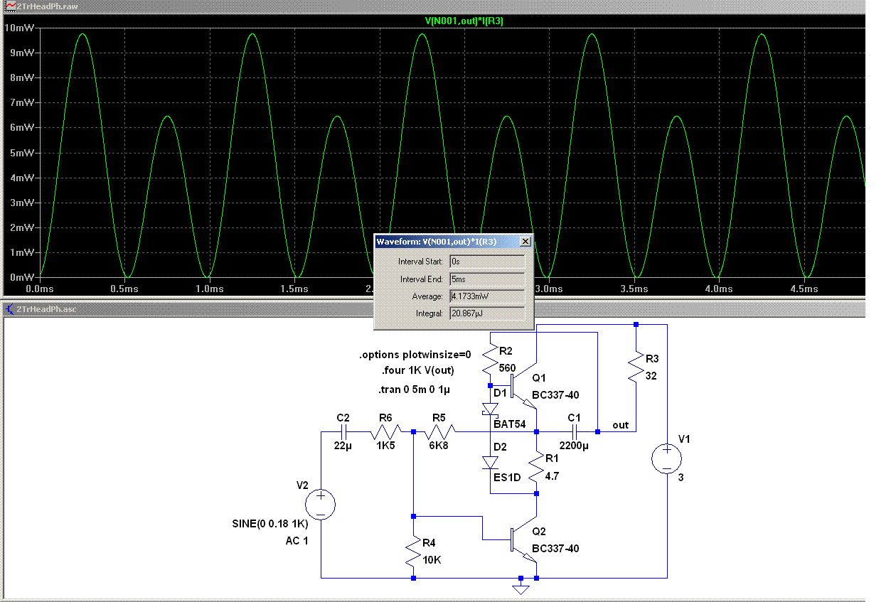

Since we also talk here of plotting formulas like v(a)-v(b),
Would it be appropriate thread to ask if we can integrate
or average power v(a)*i(B) over time?
The function is native in LTspice:Since we also talk here of plotting formulas like v(a)-v(b),
Place your mouse pointer over a component, press Alt, the pointer changes to a thermometer, left click, you have a display of instantaneous power, then place the pointer over the trace name, press Ctrl, left click and you get the average + integral:
That answer is just way too simple to be true, its like cheating!
There has to be a more needlessly complex and difficult way???
Of, course: you can do it all by yourself, using the nuts and bolts available:That answer is just way too simple to be true, its like cheating!
