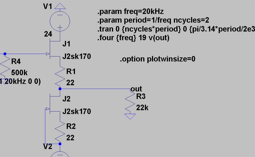

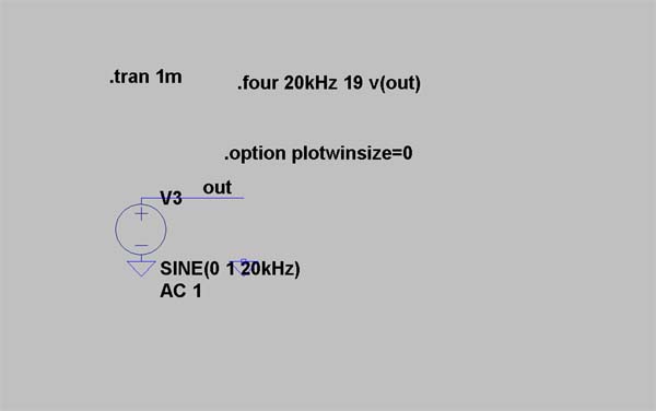

I don't get it.
I tried to compute distortion measurements with LTSPice, but got very odd (=way to bad) numbers of known-good circuits.
I tried to track it down. The following minimal 'circuit' gives me an distortion (via error log) of 0.67 %!
What can I do to get it right? For dummies, if you don't mind, as I obviously wasn't able to exract the relevant bits out of the various threads concerning this theme.

Hi Rüdiger,
looks like two basic things, in order of importance:
1) turn off data compression (can be done in control panel-->compression or include a ".opt plotwinsize=0" command. (EDIT: saw you did that already)
2) use a small maximum timestep in the .tran analysis, something like 1/1000th of the test freq period. This can easily be parametrized:
.param freq=20kHz
.param period=1/freq ncycles=2
.tran 0 {ncycles*period} 0 {pi/3.14*period/2e3}
.four {freq} xyz
that last value in the .tran is the max timestep, here about 1/2000 of the period length. I make it a little odd with the 3.14/pi stuff, to avoid some spurious harmonics from computation with exact integer multiples. If you want to sim at sub-ppm THD levels, you have go down to 1/10000 or even less.
3) use the alternate solver (also in control panel), this sometimes improves accuracy (ususally rather complex circuits).
".four" takes (by overridable default) only the last period (referring to the freq. it calculates the FFT upon), so usually 2 periods are enough to simulate (assuming that the circuit stabilizes quickly)

Klaus,
thanks *a lot*!
Now my distortion numbers are unbelievable low ;-)
(yes, I'm aware that this would most likley not match the real circuit performance)
with the attached arrangement I get 0.000058% harmonic distortion. No discussions regarding load and source impedances for now, please ;-)
