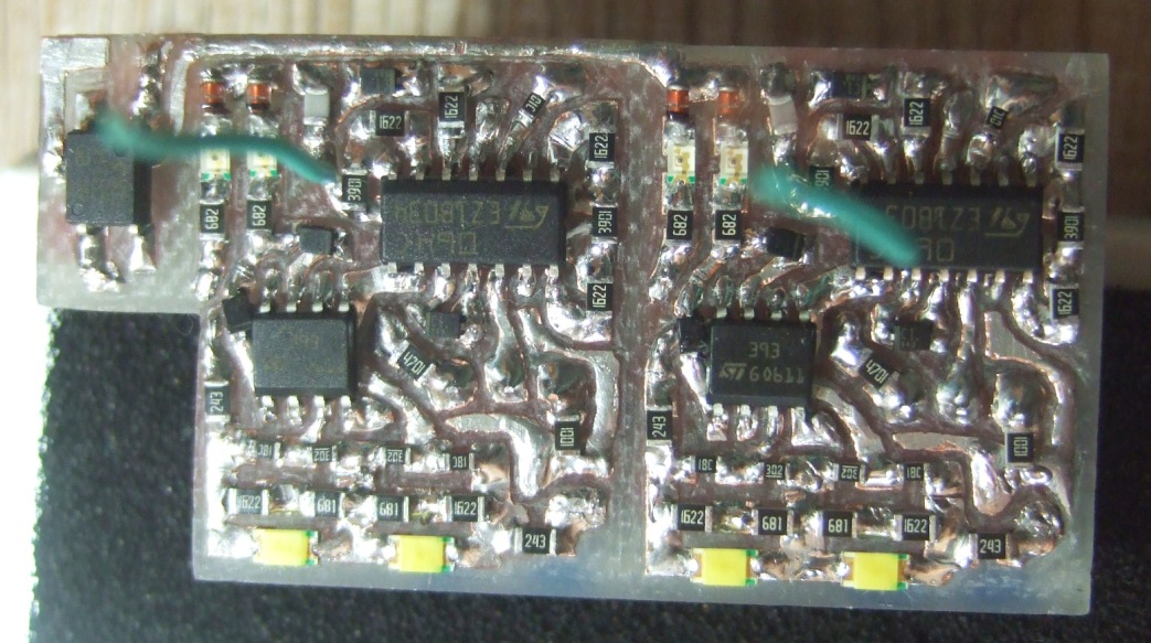

Well , more than a year further and I have some experience with these kind of DC
detectors. First I made a test circuit with the inamp , and it performed ok but not
100 % like I hoped . The object is still to have the best protection for expensive

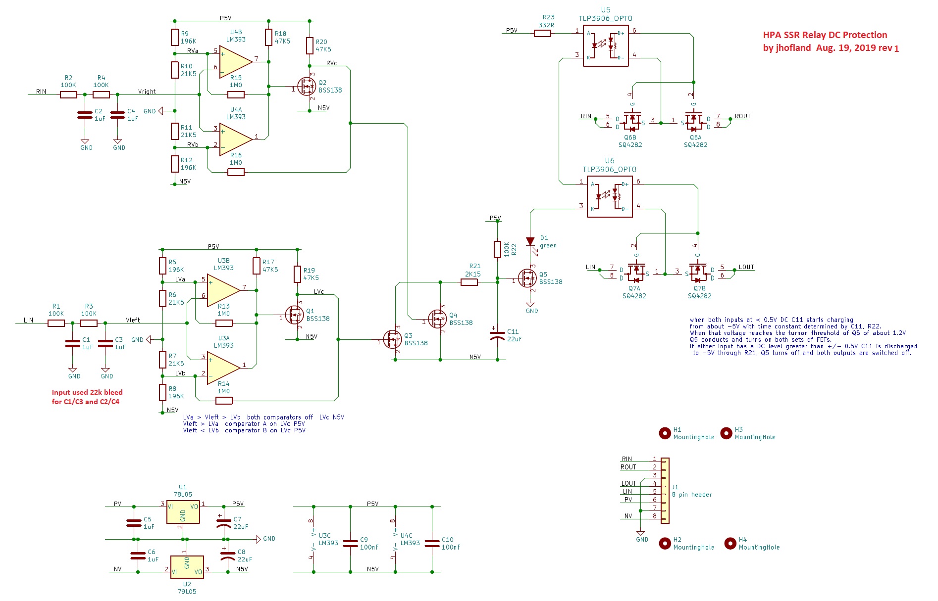

HP's and to be sure , I decided to make and use both DC detectors . The Jhofland
type of DC protection (see post #8) for low level , but slower DC detection and the
faster Inamp in/out comparator for bigger DC's .
First the Jhofland type with double RCRC.
Mine not exactly like on that schematic . Because mine triggers a SR flipflop , no
hysteresis needed , and different trigger levels which has a disavantage , also his on
2 x 5 V mine 2 x 15 V. Plugging in a source via HP jack such as a computer or
mp3 player output with the HPamp on , triggers the SR flipflop. Also the thump
when switching the mp3 player on and off or even touching the contacts on the
jack , triggers. Now I know why Jhofland type uses a clever hysteresis instead of a flipflop. A timer could be used also. The Jhofland switches at about 0,56 V and
through hysteresis back at 0 V ! (if I calculated right) . This is clever and deletes
the need for a timer ( or a reset with a FF) at events I just mentioned , thumps are
just a short time and it engages the relay automatically after the "event" .
What I don't like is 2 x 5 V : in case of a serious fault , a voltage higher than 5 V
can be on the LM393's inputs and at power down with a higher voltage on the last
cap of the RCRC , can damage the LM's input . I feed them with the same voltage
as the HPamp, after a diode, AND put 2 protection diodes.
Another thing I don't like is the 560mV threshold , this is way too high for a HP DC
detector using 32 ohm HP's , maybe ok for 300 ohm ones. Of course it will be not
as sensitive and be more tolerant of thumps/pops and in/out plugging.
Some mentioned the RCRC is slower than 1 RC , but speed for me is not that
important here (because of the fast inamp type) and with 1 RC , the AC of large
low frequencies
is too high. A second RC reduces this low freq AC a lot so not to
trigger when you have a lower threshold.
So I kept the double RC , no hysteresis , higher voltage supply , protection diodes
and for me a lower threshold of 100mV. Mine does trigger a SR flipflop which was
already build on the control PCB with an easy accesseble reset button.
This type is also easy to test , with a trimmer like a servo , it's easy to inject an
offset at the input x the amp's gain to get > 100mV on the output to make the
LM393 comparator switch. Although the threshold accuracy is not that important I
used white LED's as reference (2,52V) for both comparators, these cost nothing and give an indication that the divider works and the power is ok.

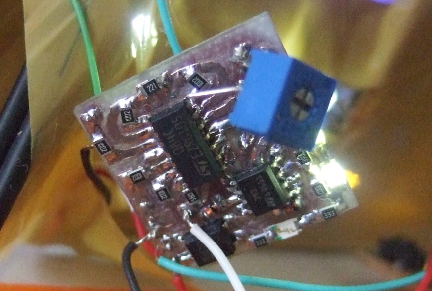

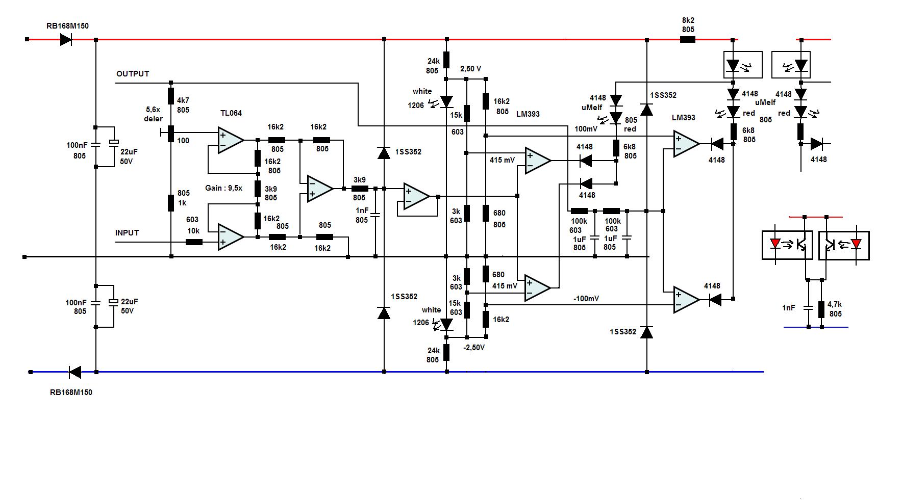

The InAmp type .
Despite the comments here against InAmps, I still wanted a fast one , comparing in
and output , as a second protector but less sensitive and for higher voltages. Both
circuits together consume about 2mA per channel and cost near to nothing , so why
not ? (TL064 & LM393 are cheap and low power but still fast enough, no need for
more expensive and performant opamps like OPA4197-OPA4196).
Low gain (9,3x) , means low offset (-14 and -9 mVdc) and low AC on the output
of TL064 and less sensitive as not to get false triggering with normal signals.
I wanted it triggered for a difference of 250mVdc between input and output .
The 100 ohm trimmer is for adjusting the R-divider to match the amp's gain (here
5,6 x), important with bigger Inamp gains ( which I used with the test circuit) , to
get as low ac on the opamps output .
Harder to test because injected offset on the input will be the same on the output .
It worked with the test circuit and feeding it voltages above the compartors
thresholds so with a signal it should do the same. The red LED's give an indication
which circuit triggers the FF through the same optocoupler , but because of the
RCRC the Jhofland type will keep the LED longer on at a small event like a thump
from switching source on/off.
The Inamp reacts to the same events as described above and also to distortion
when the mp3 player is full volume . The HPamp is a test amp with only 1 NE5532
with 2 opamps parallel , barely able to drive a 32 ohm HP at that point so the
distortion triggers and maybe it is because the HP is way over its head (overdriven)
and causes the output to differ from input.
