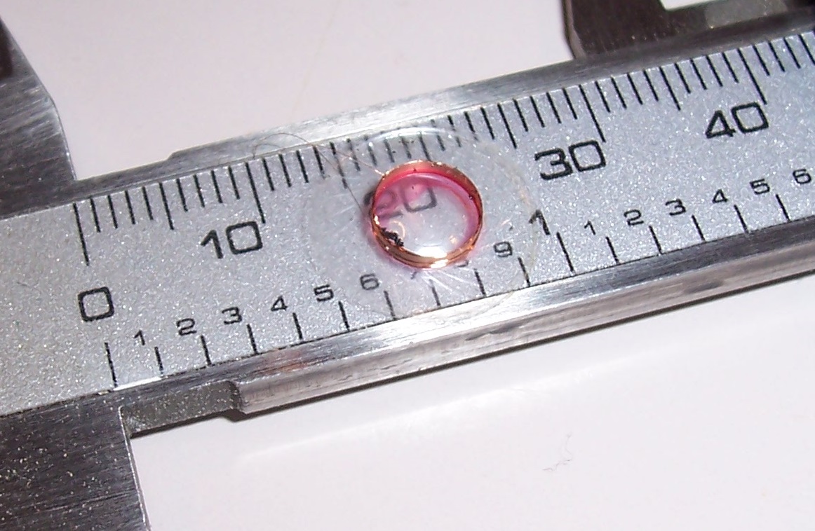

I made a quick estimation on a real-world example, a 6mm dia. VC:
attachment.php
The gross volume is about 2mm³; let's say for convenience that the actual copper volume is 1.1mm³.
Since its density is ~9g/cm³, the total mass is ~10mg.
With a heat capacity of 380J/°K*kg, this means that in order not to exceed a temp rise of 150°C for a single pulse in adiabatic conditions, the energy must be < 0.01*150*0.38 = 0.57J, or 570mJ.
The estimation is conservative, and a number of heat sinks, like glue, varnish or mylar have not been taken into account.
With a 7W input, about 80ms is required to reach 570mJ.
This puts things in perpective (and with 80ms, the conditions will not be adiabatic anymore)
Mechanical stress could be more problematic, depending on the construction
^ So we're pretty safe with the 5 ms it takes the relay .
