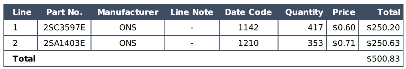

Rochester has a few thousands in stock of the 800 MHz / TO-126 2SA1403E and 2SC3597E. They will only quote prices by email so I sent a request this morning. Their MOQ is usually $100 per line item.
Mark, I know that the site says $100 per line item, but I was informed here on this site that
they accept orders where the total order is $100. Have not tried it but I am planning to.
For me it appears to be $250 per line 😡.
I'm told that you should do a request for quote, with whatever you want per line.
I'd probably try to do at least 10s and 20s per line with a total of at least $100
then send in the RFQ. I'm told that this works with them.

My recollection was also that they did a $100 minimum, but as noted, it now seems to be $250.
Perhaps coincided with the new website, launched 1st March, damn, missed by a few days.

If it really is $250 per line item, you'd need 10 x $50 for a $500 total.

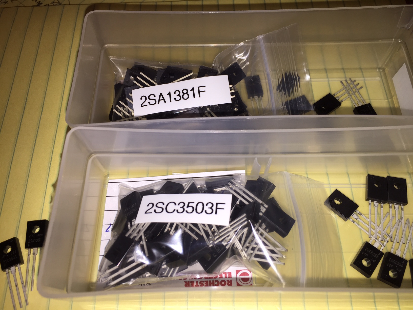

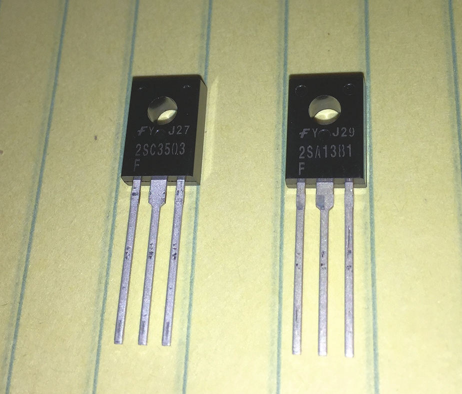

I found some 2SA1403E / 2SC3597E with minimum hFE of 100.
The data sheet had a code for F but that doesn't mean they were available.
There appear to be no F bin for any of the fast Sanyo transistors.
Even the F bin 2SA1381/2SC3503 were rare, and they are slower, the yield of F for the faster transistors must drop close to zero.
So I wouldn't hold out for F bin.
