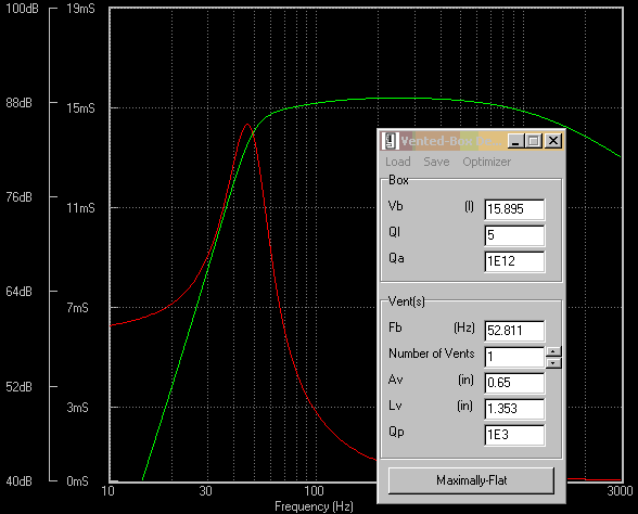

After wading through this thread and finding myself sometimes agreeing, and sometimes laughing in disbelief, I decided it's time to post a few pics to help illustrate what I think on the subject.
Picture 1 shows a simulated response of the 14cm (5.5") Vifa BC14SG49 mid-woofer in a box that was automatically chosen by Subsim as being an optimal size for the flattest amplitude response. Note that the plot of the group delay indicates that there will be substantial drum-like ringing at around 45Hz, because there the delay is a lot longer than for adjacent frequencies....

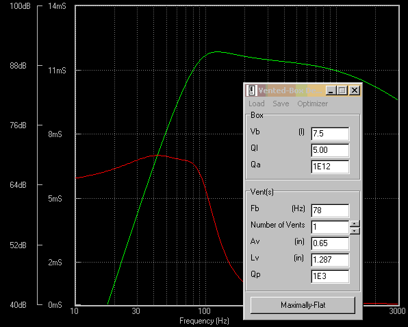

Picture 2 shows the same speaker tuned to a lower frequency, and with a lowered box Ql to simulate the addition of extra damping material. Note that the group delay is actually worse, however the ringing will occur at such a low frequency and a reduced amplitude that it's unlikely to be audible. It may sound a lot "tighter"....

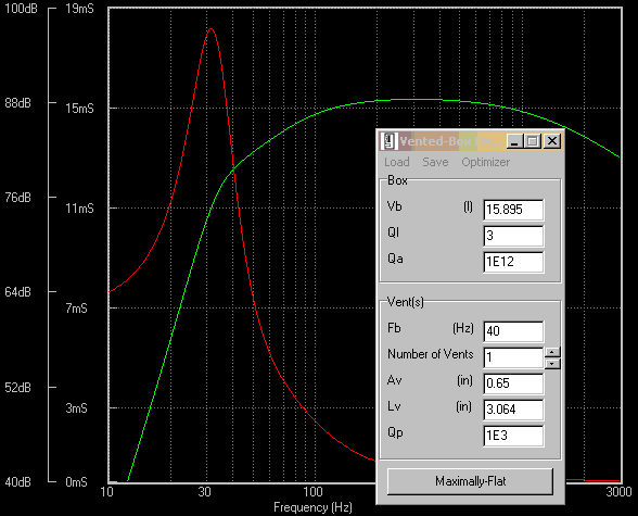

Picture 3 shows what I believe to be the crux of the discussion. The box is undersized, the port is too short, and yet... the group delay is almost flat and very well controlled to practically eliminate any ringing. That sort of group delay is usually associated with Bessel filters, and they produce no ringing when applied to transient waveforms. On the other hand, the amplitude response has a mid-bass peak and quieter low-bass, which may either be seen as a bad design, or seen as a useful transition to a subwoofer + passive baffle-step compensation.
Lech
