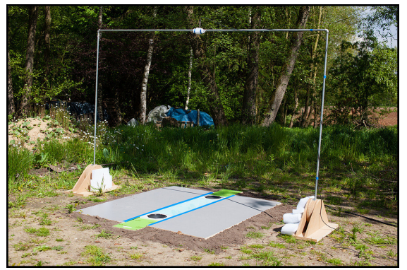

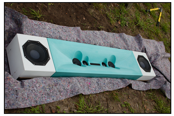

Speaker buried in the ground is one way to do it like Nils Ollerer did here
Aries M Dokumentation - PDF Free Download
