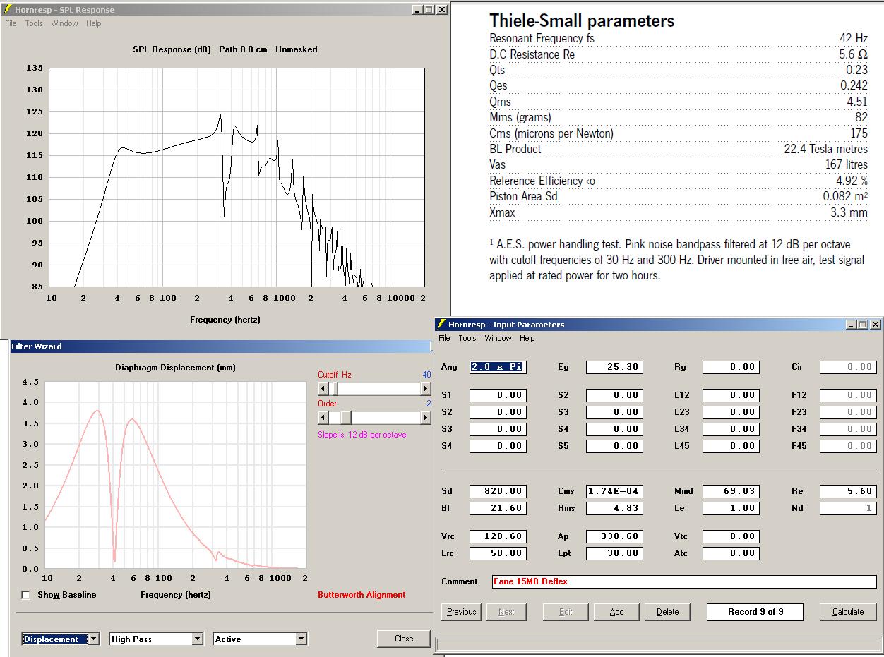

I think a simple reflex cabinet would be best this would allow the speaker to reproduce the bass harmonics properly.
The cabinet would be easy to design in Hornresp from scratch.
The fly in the ointment is the low Xmax of the 15MB. This speaker would not be able to take a lot of power. Have you a bass amp that you want to use with the speaker?
I would not push this speaker much over 100W in a reflex cab - even then I would be looking at a high pass filter, but that would really depend on the characteristics of your bass guitar amp🙂

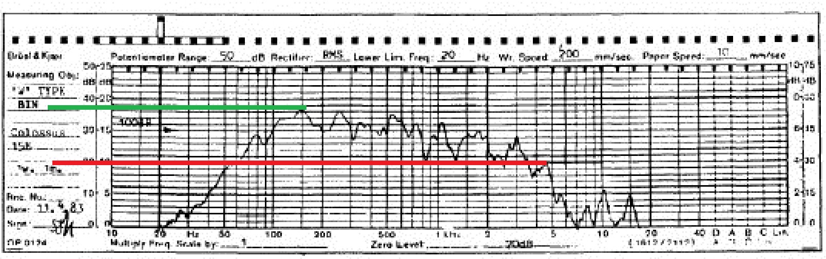

From analyzing the picture you posted in #5 it shows ~90dB's with frequency from 60Hz to 4.5KHz, with a peak of 108dB at 150Hz. This for a Fane Colossus 15B, probably another driver. I'm not saying it doesn't work just mentioning it to clarify the fact.
Fane Project - Compact 125 Litre Cabinet for 1 x 15” Driver
In this other project they say ""Frequency Response: 35Hz – 1k5Hz"", why?! 🙂

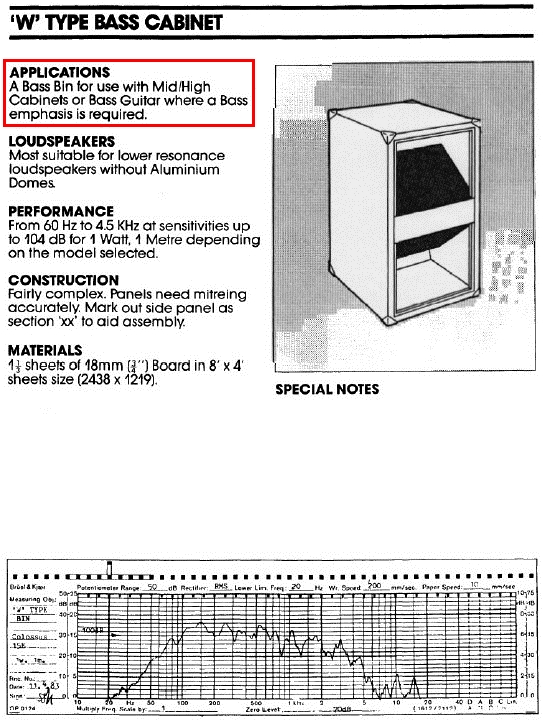

fyi,i simulated the fane w-bin(top graph)
it is poorly designed.
i would change the inner layout a bit to get a better responce in the top end(middle graph)
or you could go for the bottom graph ,wich i designed for someone a while ago.
