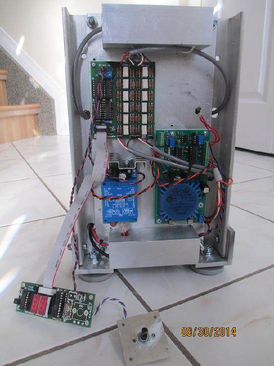

The board makes use of two IC temp sensors (Dallas D18B20) and starts spinning the fan at about 40degC and maxes out the fan speed between 50 and 55degC and will try to maintain it. It has hookups for three LEDs for power ON, fan ON, and Overheat (and other fault conditions if blinking etc.). It has auxiliary functions for remote turn on (from preamp) in parallel to momentary pushbutton turn on off the front pannel, soft start function and speaker DC protection.
The speaker protection function is the only one I am currently not using since the filters need refinement. I would add that to the board but for this function you would be on your own (the trimmers are there but I have no time for tuning the threshold for tripping protection relays vs. playing loud bass etc.).
The board is designed for pwm control of NF-S12A PWM. it makes no use of fan speed feedback and if the fan fails for whatever reason it will only react to temp rise. the board tests temp sensors for sending feedback though and will throw a fault if not working properly. I still recommend the use of temp switches as the last safe (my disclaimer ;)).

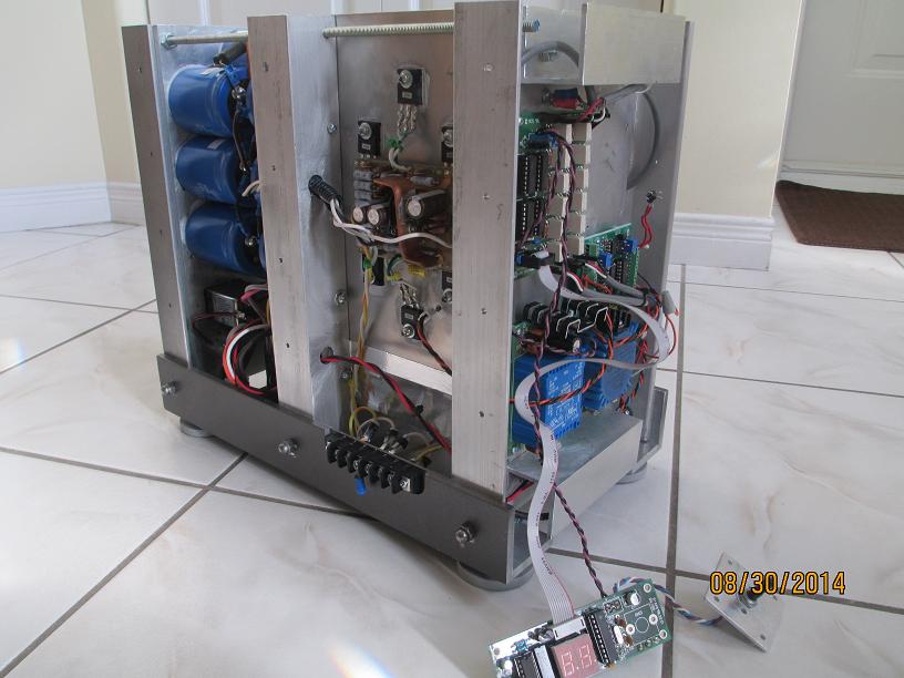

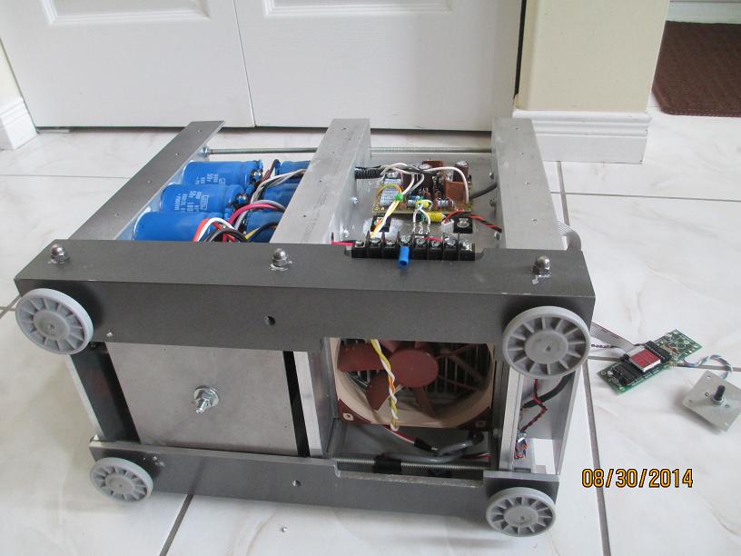

as for any reference to the fan noise: don't bother! I CANNOT hear the fan with no music on and have to look through the 9inch heatsink to see if it is spinning. For the proper arrangement check out my Aleph30 pics (you can see the control board in the front next to Dantimax vol attenuator).
I would supply the board with a flashed controller, brief instructions and I give you the source code in case you want to start changing anything (it takes Microchip PICkit3 programmer to flash it).
