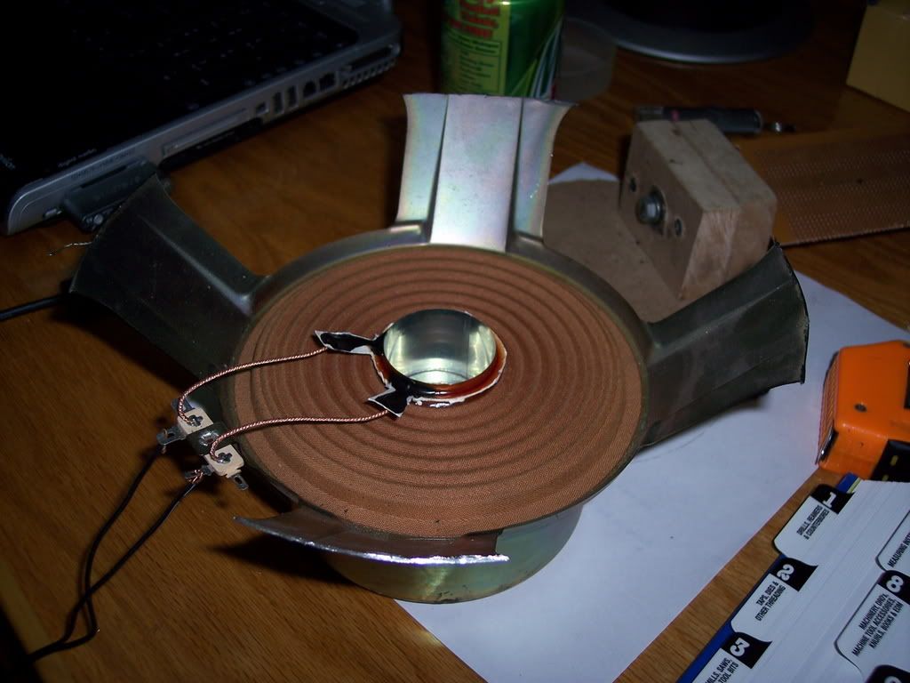

Ok, I took some pictures and uploaded to a Picasa album. Be sure to read the comments.
What I've got (or rather, had; I had to take it all apart to drill the back plate) is not very practical for actual operation. The center post has to be long in order to give a good angle for the push rod to operate the axle. I've got a couple of different designs I'd like to try for this, I'd like to use a rack and pinion drive (with nylon anti-backlash gears if I can find some) instead.
See the pictures and the video I posted, it'll be clear. Yes, on the fan motors output shaft I will need a couple of copper contact rings that spin with the shaft. These would be connected to the speaker inputs to drive the voice coil. Brushes would ride on the rings to transfer in the signal.

Well, as you can see, this is a very rough prototype. At this stage I'm just trying to check what ideas might work and which are just stupid 🙂 It's already clear that the blades need to be very light, once the cone gets them going it needs to be able to stop them again. Any extra weight will make the suspension resonance worse.
I'm not sure if I'll bother reassembling all four blades, to make it work I'd need to sink some more effort into improving the push rod mechanism. I'd rather move on to a more compact and linear design.
An advanced version of this thing would probably benefit from a voice coil position feedback circuit to provide better position control. Along this line, it's probably also quite reasonable to use hard-disk head positioning motors to rotate the blades. It might be necessary to rewind the voice coil for the necessary power, but the force available and the speed of operation are both very high. Each blade could be directly driven by one coil and magnet set. This obviously would require either a mechanical centering mechanism or a feedback system for positioning. Again, a project in it's own right.
I'd love to see the arrangment you have of a functioning four bladed fan assembly.

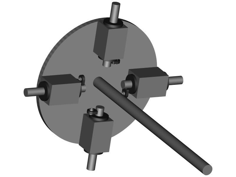

I don't have a prototype yet, but I did (partially) draw up some ideas. The speaker magnet/VC will sit around the shaft (stationary). The swash plate will ride on the shaft in between the VC and the blades. I'm planning to use rulon bearings to reduce rotating mass on the fan blades. I will also use a rulon bearing between the swash plate and the shaft to align and support the VC. The bearing will be fixed to the shaft, and the swash plate will slide over the bearing. This will once again reduce the moving mass. I will be using the motor from a 12 inch woofer. I will post more drawings as I get them done.
Congratulations! Of the hundreds posts on this thread, you are the first to post pictures of an actual "work in progress". You deserve a pat on the back!
xplod1236 said:The speaker magnet/VC will sit around the shaft (stationary).
I look forward to seeing more of the design. Will the connection of the voice coil to the swash plate provide support to keep the voice coil moving linearly? As I understand it the speaker surround provides a significant amount of the support needed to control the movement of the voice coil.

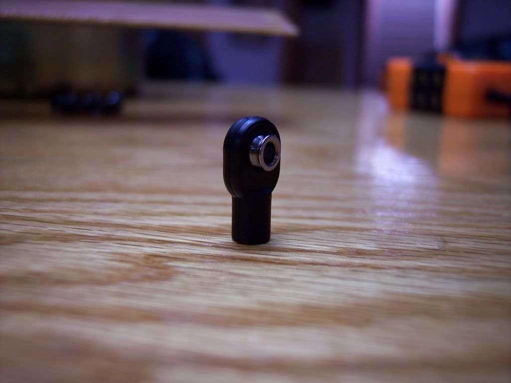

To eliminate the play in your design, look into using RC car tie rod ends. This is what I'm using for my design. I picked up a 6-pack for $4 The overall length is just under 3/4". They're plastic and fairly lightweight, and if they don't break on RC cars, I don't see why they would break on a fan.
I was thinking about those too, I agree they should be more than adequate to the task, considering the shock loading they endure in their designed use. Alas, the only set I've got are currently serving their intended purpose 😀 They are manufactured to fairly close tolerances and run pretty smoothly, so I don't think they'll generate any noise. In my prototype the only concern would be the friction they introduce, they can tend to be pretty stiff when new, my little driver will have trouble making them move. Maybe I can spin the ball with a drill to free them up a bit.

The VC from the driver that I'm using scrapes even with very little power input. The speaker had a deteriorated surround and probably sat for a long time (before I acquired it) with the cone twisting the VC out of alignment. So maybe now the spider is twisted a bit. The swash plate should straighten that out though.
The ones that I picked up came in 2 pieces. I had to snap the hollow ball in place. The ball moves around so freely, I thought there would be play, but there's none to be found. But if yours are a bit tight, spinning them to loosen them up should do the trick.

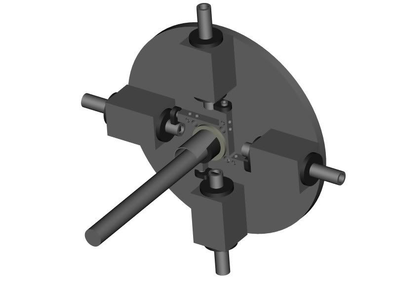

Here's an update for my project. The shaft will rotate the whole assembly. The swiss-cheesed swash plate will rotate with the housing (as should be obvious). The flanged bearing (black) combined with a thrust bearing (tan) and the sleeve (cut away for clarity) will make up the rest of the swash plate. The bearing and sleeve will be stationary (not spinning but free to move up and down the shaft) while the rest spins around it. The sleeve will be connected to the voice coil. In my opinion, this should work, but I'm always open to criticism and suggestions.

xplod1236 said:Here's an update for my project. The shaft will rotate the whole assembly. The swiss-cheesed swash plate will rotate with the housing (as should be obvious).
It's totally OK to think outside the Swash Plate model, by the way. In a helicopter, it is necessary for banking left and right and for tilting forward-downward and forward-upward.
What a helicopter needs to do that we don't need to do:
A helicopter needs to make the blades have different pitches at the same time. If you want to lean to the left, the swash plate tilts and the blades rotate to a greater angle of attack on the right and then lower on the left. So each blade bites more air on the right, then flattens as it comes around to the left. In this way, more lift is generated on the right side than on the left consistantly, and the the copter leans to the left.
We don't need this. We need all blades to advance and retreat together. We should never need to have the fan blowing on one side and sucking on the other.
This doesn't invalidate the swashplate concept at all; it's just that we don't need all of the flexibility of a helicopter mechanism, so don't need to stick with that model completely.
If the linkage from voice coil to blade twisting starts to get heavy, we will get reduced performance. You don't want to use all of your power wiggling masses that don't contribute to the sound.
If the moving mass of the linkage starts to get heavy, why not just put a voice coil at the base of each blade? Coil goes up, pushes a lever and twists one blade (times 4). The four magnets will not be moving masses, just the voice coils.
CodeSui, your picture reminded me of this. Actually one of my earliest ideas was simply to put a servo motor on the axis of each blade (where your bearings are) and then send these the twisting signals. No voice coils and huge magnets, just 4 small servomotors--one on each blade. That's what your picture reminded me of.
Just to clarify: I'm calling it a swash plate, but it will only move back and forth. The bearing it's riding on will not allow it to tilt like a helicopter swash plate does; so all the blades will tilt together. Is there a better name for it?
neededandwanted said:CodeSui, your picture reminded me of this. Actually one of my earliest ideas was simply to put a servo motor on the axis of each blade (where your bearings are) and then send these the twisting signals. No voice coils and huge magnets, just 4 small servomotors--one on each blade. That's what your picture reminded me of.
I considered that early on, but decided against it, at least until I decided that a voice coil version isn't workable. I like the simplicity of driving it with a simple amp instead of a servo controller. To run a servo controller I'd need to convert the input signal into movement commands for the servo controller. I don't know of any off the shelf equipment to do that.
xplod1236 said:Just to clarify: I'm calling it a swash plate, but it will only move back and forth. The bearing it's riding on will not allow it to tilt like a helicopter swash plate does; so all the blades will tilt together.
In your design it appears that the arms attaching the rotating part of the swash plate to the arm on the blade is a ridged X shape. If so, how does that part of the swash plate track the rotation of the arm on the blade?
It's not rigid. The arms on the blades have hollow balls where they connect to the swash plate. I just didn't take the time to draw it up.
