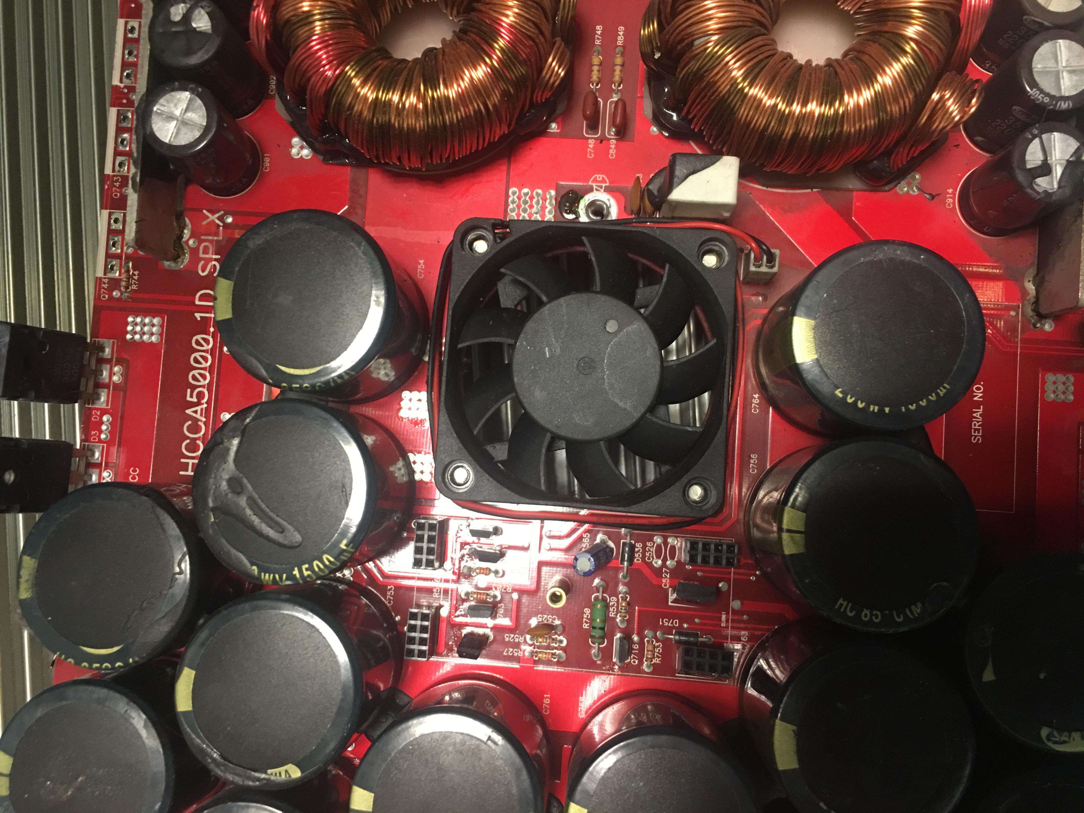

Sleeve bearings will get dry (lubricant dries) and they will wobble which can make them noisy. You can clean and lubricate them. TechTips 5, item #13 if you have the tutorial.

If you pull the fan and it has a label on the other side, it may cover the shaft and retaining slip. Remove that and the impeller will slide out. Clean the bearing and shaft and lubricate with a good lubricant (not WD 40).
