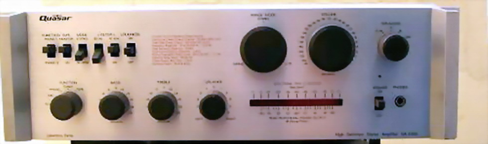

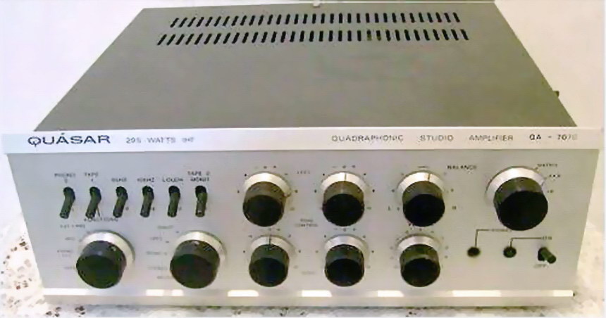

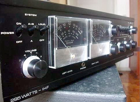

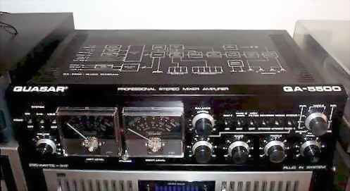

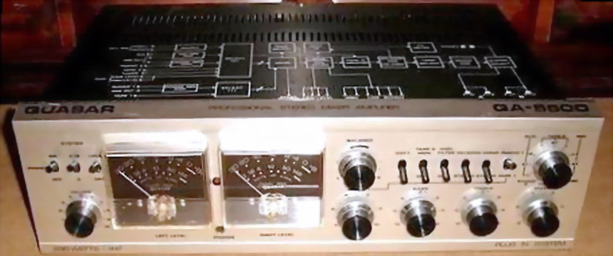

We had a Quasar factory, a Quasar brand in my country
here, down in South America, the Quasar was very famous, in special in Brazil, and also known in other countries of this continent.
They have operated from the mid seventies to mid eigthies when they close their doors because of hard competition.
They have made interesting amplifiers, with technologie advanced to the seventies.

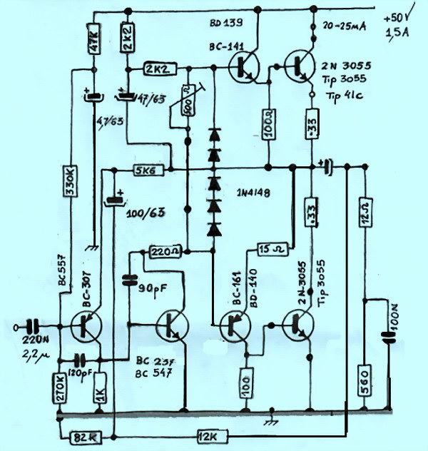

Here a sample of one of the last models... the schematic.
