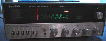

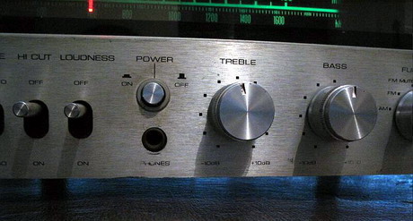

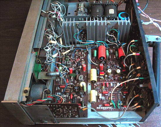

I'm starting with Gradiente STR-1250.
This is a small history of this.
This vintage Gradiente Model 1250 was made in the seventies... people turns
crazy with it’s panel ligths and colors, and the power was the average power
for those days..something alike 30 Watts RMS each channel over 4 ohms.
It was a result of agreement with JVC, as those days Gradiente was constructing
JVC models in my country.

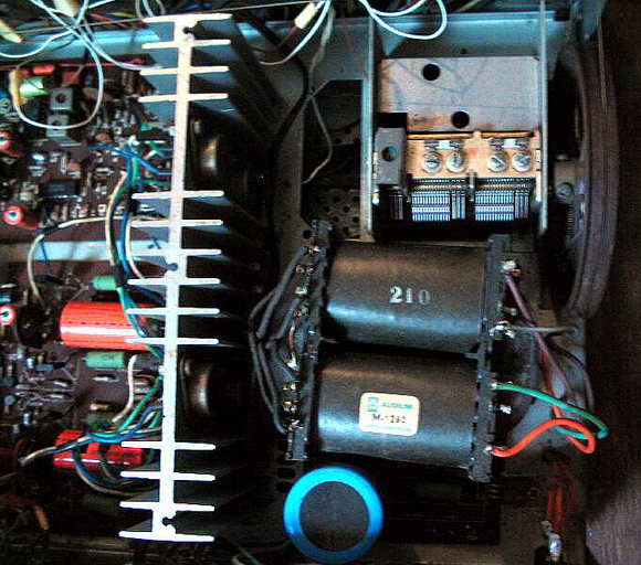

The supply is not simetrical, voltage around 45 volts and condenser was used in
the output.
People fast increase the output electrolitic condenser to 6800uF and a 100n
capacitor was placed in parallell with it....also the input condenser was increased
Quiescent current, bias current, stand by current was increased to 50 miliamperes,
and some guys modified the transformer to 60 volts DC including another transistor
pair in the output.
Brazilian home parties where made with those units....normally connected to bass
reflex speakers, and also there was one unit with an active speaker and the other as
a passive sound damper.
I will post in this post, some Brasilian amplifiers...

It's nice to see gear from, at least for me, unknow brands.
This one looks highly modded.
Thanks for sharing.
/Hugo 🙂

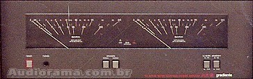

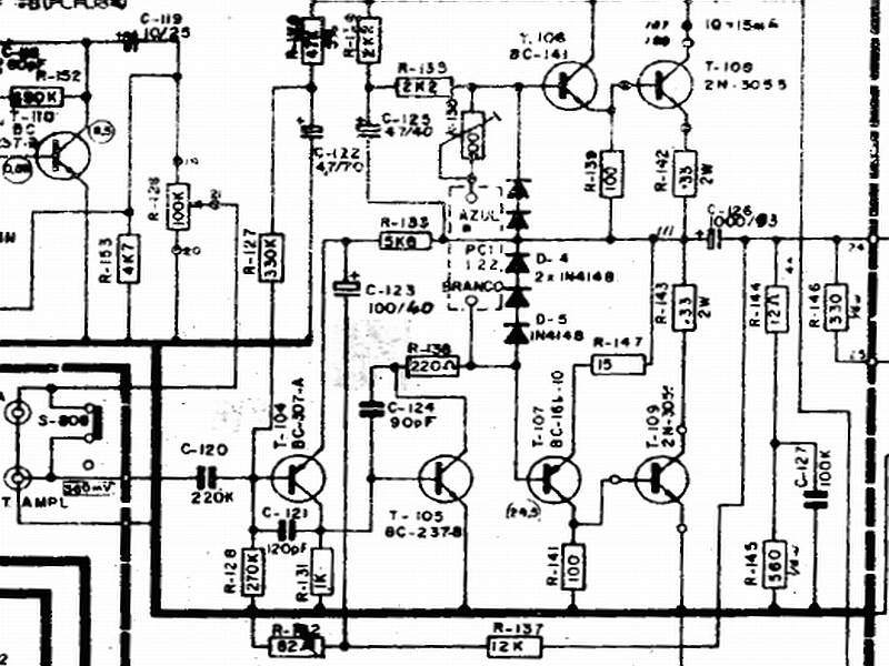

In this Post, i send to you the Gradiente HA-II Schematic... The amp consists in two monoblocks... This is tested for the biggests Brazilian audiophiles...
A photo of Gradiente HA-II

The Schamatic of the HA-II
Schematic

Looks a lot like the Harman Kardon gear of that vintage too.
Circuitry looks a bit like an HK630, cosmetics a bit like the HK430.

Are you sure you have the model right?
The HK630 service manual I downloaded for that model (a receiver) has no resemblance to the Gradiente amp.
To start with the HA-II has symetrical LTPs at the input and a DC servo for the offset. The HK 630 has just one LTP and a blocking cap on the feedback.
In fact I have never seen an HK amp using a servo, but I don't know them all. What they usually do, and I think it's clever, use a trimming system injecting DC at the input to adjust the offset, like what they do on the HK770. That amp sounds very well (a friend of mine has it) and never seems to show any DC offsets.
Carlos
I supposed DJK was referring to the HA-II.
Shame about the 470 pF caps, probably needs it desperately with that much power coming from 6 *120 watts devices.
Swapping the LM741 DC servo opamp for an OPA627 i can not imagine either. An LF411 or an AD type would be a radical improvement, maybe an OPA132.

The HK630 I was refering to was ca 1970, I didn't realize they were re-cycling old model numbers. The HK330/430/730 look similar to the Gradiente STR-1250, but have direct coupled outputs, the earlier HK630 was cap coupled like the Gradiente STR-1250.
Here is an old HK630
http://cgi.ebay.com/VINTAGE-HARMAN-...819507055QQcategoryZ67799QQrdZ1QQcmdZViewItem
Here is an old HK330 with only one row of push buttons like the Gradiente.
http://cgi.ebay.com/VINTAGE-HARMAN-...ryZ67799QQssPageNameZWDVWQQrdZ1QQcmdZViewItem
The schematics for GAS/SAE look very similar to the Gradiente HA-II. The GAS Son had a tiered supply, the GAS Grandson a DC servo.
The newer HK Citation gear has the fully complementary push-pull design from input to output, and a DC servo, very similar to the Gradiente.
[/B]
Now that's different. The GAS used to have DC servos using 741s and were fully complementary.
The Gradiente looks like interesting equipment. [/B]
