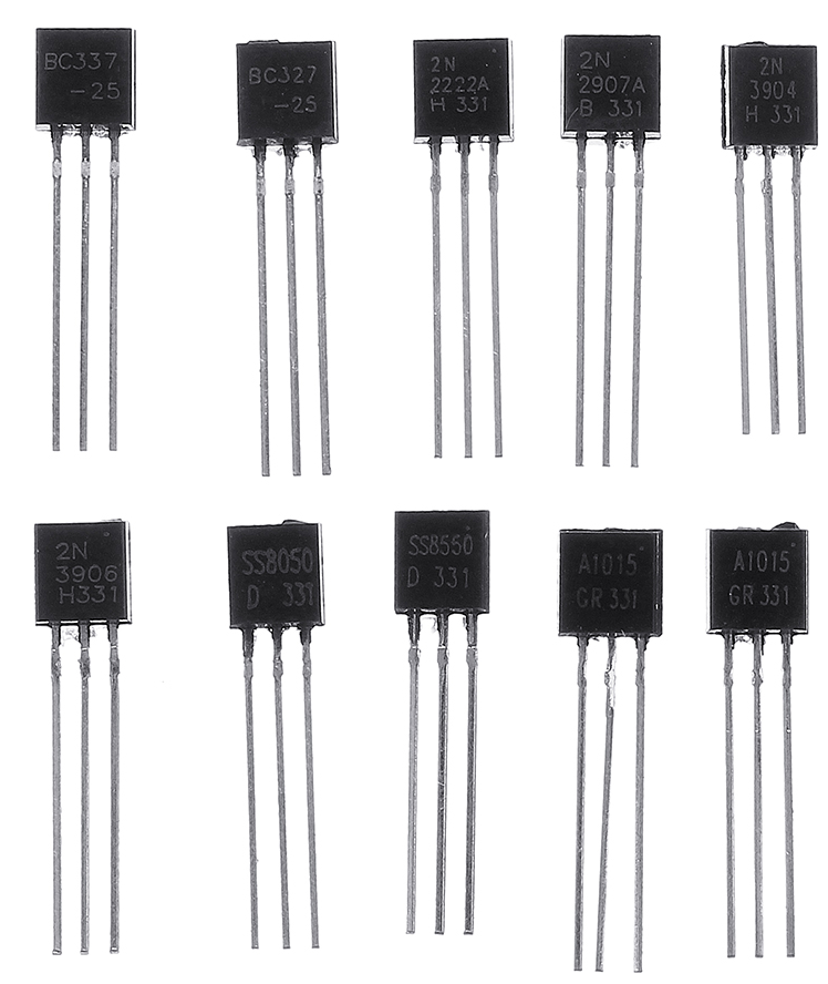

Hi everyone.
I thought I'd pick up some misc small signals for repairs and playing around. I found kits with typical used transistors on Ebay/Banggood for almost no money.
But I am worried they are fakes, because almost all transistors have the same datecode/batchno "331" even when they are very different types. Also, i do not see any manufactorer markings.
I bought some 2n5551/2n5401 that also have this same marking. Unfortunately I noticed this too late.
Should I be worried, or is there an explanation for this. Please see the attached picture ( from banggood )

I would rate them as very likely fake ¯\_(ツ)_/¯
Did you receive them yet? Are they shipped?
I bought and payed for the 2N5551/2N5401 yesterday. They will probably be here january. See attached picture ( from Ebay )
At first I thought that since most manufactorers are moving more to smd, they might want to empty their old stock for the most common parts. I am probably wrong here 🙂

for almost no money
What else did you expect?
Ever heard of Mouser, DigiKey, Farnell and similar "serious" suppliers?
I buy nowhere else, period.
"hey, but these were 1 cent each, with free shipping"
Then live with it.

After looking a bit more into it, i stumbled over a posting of 2sa733 that has the same x331 marking as those in the picture above.
According to seller, these are made in China, by a company called "Wahkitsing"
They have a homepage here: 华捷盛电子有限公司
I tried to find more info without much luck. Maybe one of you know more?
Their online order system looks funny...
I have bought the same, from the same source, not expecting too much considering the price, but I have been pleasantly surprised: it could be that most of the types differ only by the laser marking, but basically they are generally up to their specs: I have used them in projects (they are posted here, you can check for yourself) for more than 1 year, and I didn't encounter real problems.
In fact the opposite might be true: since they are one-size-fits-all, they are overspecced compared to the real, original parts.
The basic ratings are right (voltage, current ...) but secondary parameters not directly specified in the DS are generally much better than the originals: transition frequency, Early voltage, etc.
This could cause problems in some circuits not designed for such performance.
In fact, they are a modern process, having nothing to do with the original, but broadly complying with the DS.
As an example, I have tested a S8050 in the Nonoiser project, and it did better than an authentic Philips BC337 on noise, I have built a HV power supply (Elektria) using MPSA42 and 92, a discrete HV opamp working from +/-135V with the same, etc.
They might be a bit weak on dissipation, because the amount of material in the case and leads is minimal, but other than that, they are OK, if you know what to expect (if you use them as a replacement of older devices, you might have problems due to the higher gain and Ft).
These observations are for transistors of one source, and it does not mean that everything you find on Ebay is going to be similar: in fact members sent me samples because they suspected they were fake -and they were-.
They were medium power transistors mainly

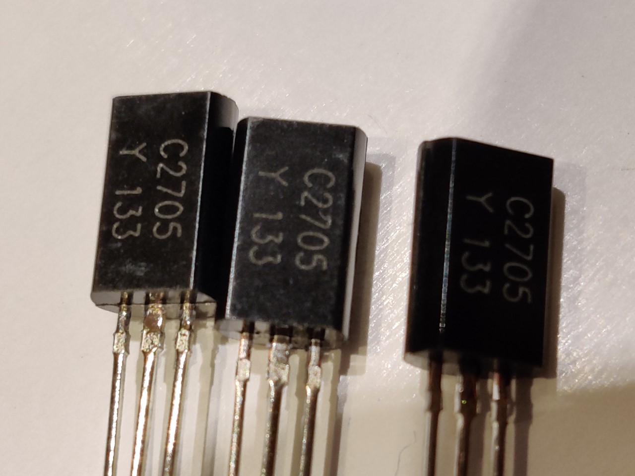

Hi. Hope you all had a good xmas/newyear.
Before xmas i also ordered some 2SA1145 and some 2SC2705.
They finally arrived, and look like you can see in the images.
Comparing to Toshiba's datasheet the mechanical measurements are
within spec. So are the markings. Hfe is also within spec ( done with a cheap multimeter )
What bugs me is, that npn and pnp have the same batch no. I have actually never seen this, and can't tell if they are genuine or not.
Anyone?
