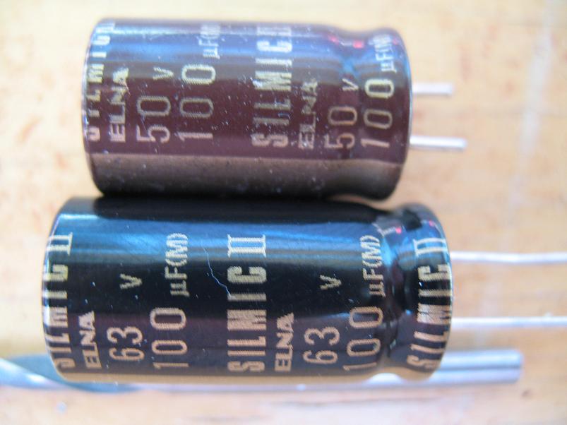

I used many different value Silmic II capacitors but all had brown sleeve in gold letters .
I just purchased from Ebay 100uF 63V Silmic II and it has black sleeve with gold lettering .🙄
Unfortunately I didn't found at Parts Connexion 63V 100uF Silmic II .
Did someone ever purchased Silmic II in black sleeve???
Please let me know .
If I mount them I can recognise the sound but after I'm unable to return them .
Thank you very much .

Hello
The brown is orig that sure ! The writing look the same on both.
I only never met Silmic in black sleeve .

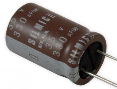

The original Silmic's where brown with gold lettering, RHOS compliant units changed to white lettering, the same for Silmic II's. I have never seen black silmics only tonerex.
Hello
You right , these is fake Silmic . I just look up at the Silmic side !
To return it with tracking number it cost me almost as much how much I paid for the 4PC Silmic !🙄
All I can do I will leave negative to the guy and warn the people not to buy these fake Silmic II capacitors .😡
Here is what I found about the Silmic II on their site .
Elna Silmic (ROS Series) & Silmic II (RFS Series) Electrolytic Capacitors
High-grade Silk fiber capacitors for Audio.
The SILMIC series are Elna's highest grade audio capacitors that exhibit superior acoustic characteristics. An entirely new type of electrolytic separating paper is used, containing silk fibers. The extreme softness of silk can mitigate vibrational energy (generated by the electrodes, by external vibrations and by electromagnetic fields). Due to it's new electrolytic and foil design the signal propagation speed has increased (the ESR is reduced) and a more powerful, yet-mellow, sound is possible than before. When these capacitors were subjected to aural evaluations, the high range peak and mid range roughness were reduced substantially. Also, the low range richness and power were increased in the obtained high-quality sound.
Capacitance Values: 0.47uF - 6800uF
Voltage Values: 6.3Vdc - 100Vdc
Technical specifications:
temperature range: -40 to +85 degrees C
tolerance at 20 degree C, 120Hz: 20%
endurance at 85 degree C: 1000hrs
oxygen free copper leads
Red gloss sleeve with gold markings (non-ROHS)
brown matt sleeve with silver markings (ROHS)

Hello
Yes I purchased from jims audio !
I mounted in my PC board , 100% these not Silmic II capacitor !
One side the amplifier I have brown Silmic , the sound total different .
Much deeper bass , more control over the speaker , more authority .
These sound much thinner , somehow has a bit more detail due to the missing bass .
I used close to hundred of Silmic II , I recognize the sound right away .
These huge difference between the two capacitor is not because one is used 100 hours another new !!
Please do not buy these capacitor , you waste your money .

Hello
Please read post #6 that from the official Elna site !I have to say these not bad capacitor but not Silmic that sure !
Some cheaper Elna got new sleeve .
Even the bottom where the two leads come out not 100% like the Sillmic .
I will use it a couple day , it is not worth to return it . I loose all my money on the postage with tracking number .

Hello
I ask Parts Connexion , they sell Silmic many years !
These is the answer I got from them !🙂
Answer
That is old stock...our stock is the ONLY way they make them now.....they changed to plain heat shrink jackets, to save money.....less types of inventory to keep.
Those other caps are a minimum of 5 years old...maybe 10.
Sincerely,
Chris Johnson, President
PARTS CONNEXION
5109 Harvester Road
Unit B2
Burlington, Ontario
CANADA L7L 5Y4
So jims audio say on the Ebay these is less than one year product .
It is a big lie !
He will get the feedback he deserve .
I will buy from Parts Connexion 100V type , not cheap but better than fake (garbage) capacitor !
I wrote to jims audio to .
I wait on his answer after he get my feedback .
Thanks guys for the help .

If it is old stock, it's not fake. Maybe capacitors get better with age (up to a point) like wine? You may have quite a find there! Mouser has silmic ii, but pricey in the larger values.
He is claiming 2009-2010, so it may be a dishonest listing. Wait to hear from Elna, I have contacted Panasonic regarding fakes and got an answer.
Hello
To replace the brown Silmic these would be a big step back . Even do it not bad but the amplifier was put together with the brown Silmic capacitors .
I just want to use a better bigger transformer which 39-0-39V sec. .So the 50VDC capacitor it would be under rated .
I need min. 63V.
Any way if he is a dishonest person he should get the feedback for that .
I wait one or two day for his answer if not he will get what he deserve .
He sell orig Silmic to , if I could see the pictures clearly these caps are black I would never buy them .
If you look at his listing the second picture look like the caps are brown .
The truth is not bad capacitor but very different when I com pair one side to another .
One side brown Silmic another side these (what ever it is )
