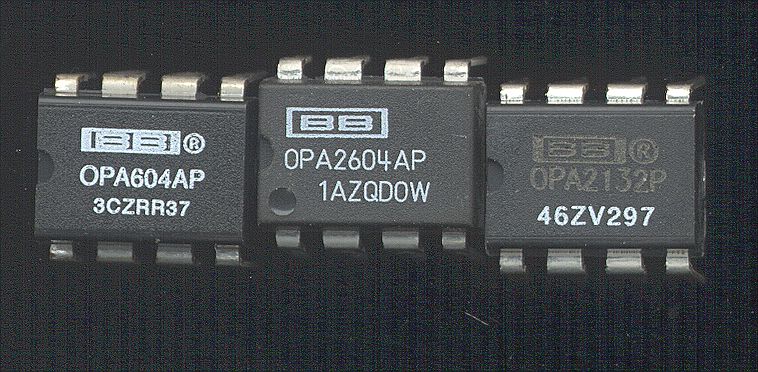

I've just bought some OPA627APs from Farnell in the UK and I'm a bit suspicious of them. The BB logo isn't quite the same looking as it is on all of my other Texas/BB opamps and there is no registered trademark sign (R) after the logo. I've never seen this before, surely the (R) symbol will be on all genuine Burr Brown parts. The datestamp is 49ADON7 and is printed in slightly whiter ink than the logo.
In the past I've had OPA627APs where the logo, registered trademark symbol, and part number are printed on the package in light brown and the datestamp is printed in white. The light brown printing looks genuine enough but I'm worried about the use of different coloured inks.
I've emailed TI to see what they say but I wonder if any of you have come across fake OPA627s. Their cost must make them a prime target for counterfeiters?

These are all authentic parts from Digikey...
There is a lot of variation these days as all the companies
change to new Pb-free/green materials at new assembly
sites, etc.
The "brown" marking is laser marking. I would guess that
the parts receive the generic laser marking when assembled.
Then when they are tested and graded out to high and low
grades, the white marking is done -- looks like a manufacturing lot
code is inked on. The lot code would be different for the
high and low grade units that came from the same raw
batch of parts. Thus it could not be put on before testing
and grading.
Thanks for the responses everyone, particularly EchoWars with the photograph showing all three variations. That's certainly put my mind at rest. I've had a few fake transistors in the last couple of years so I guess I'm getting a bit paranoid ( but then didn't John Le Carre say "believe your paranoia" in one of the Smiley novels )
