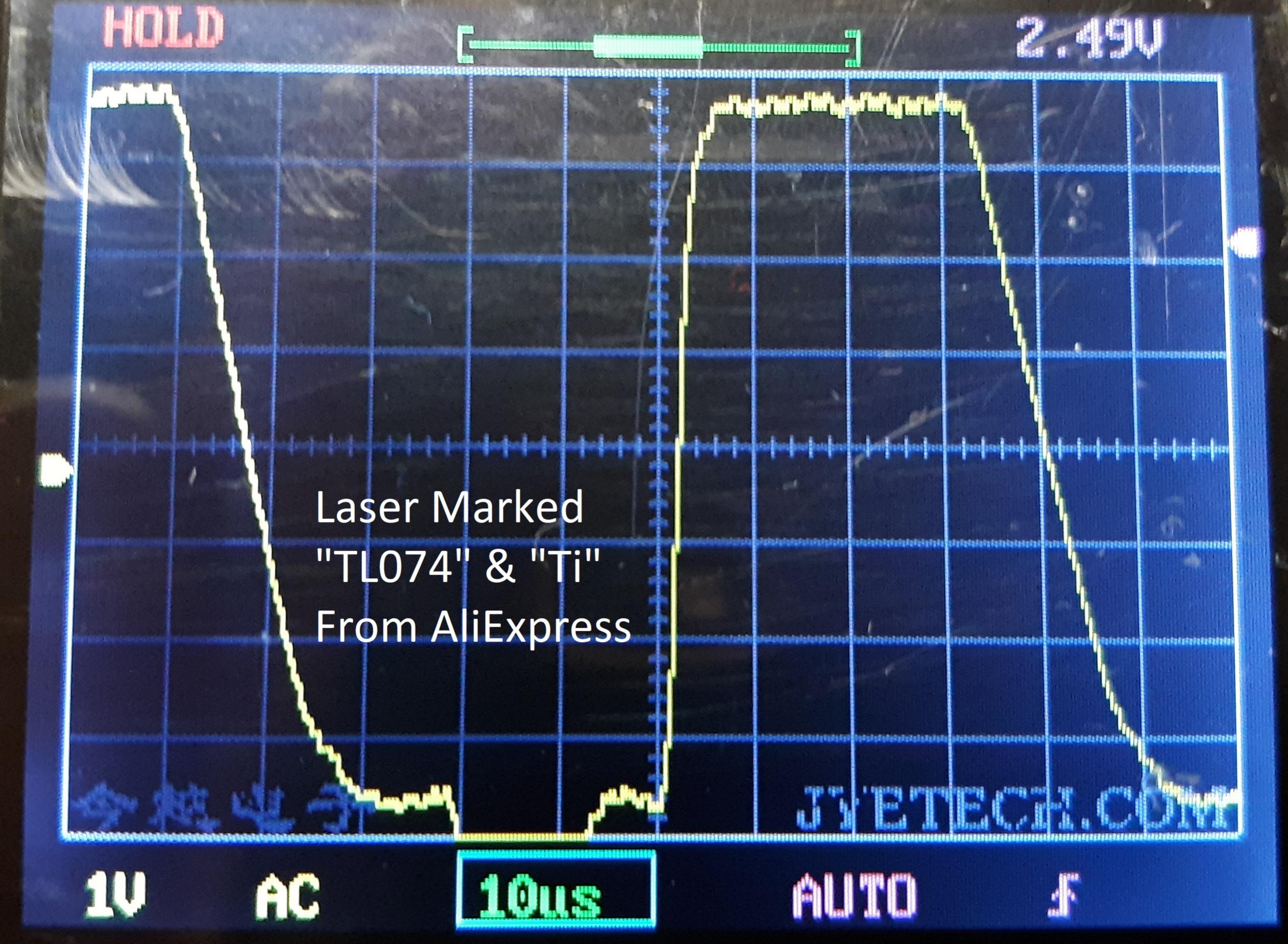

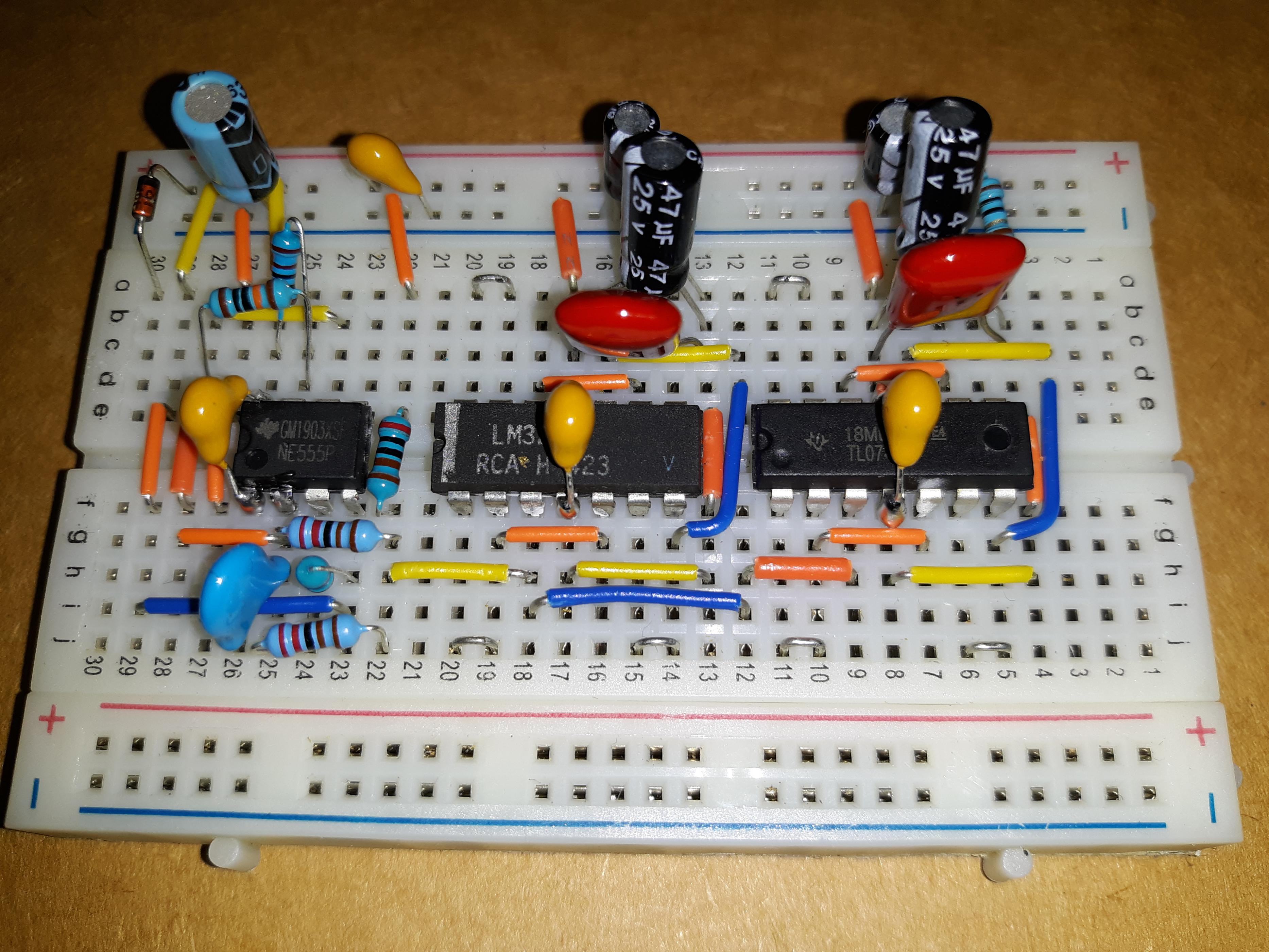

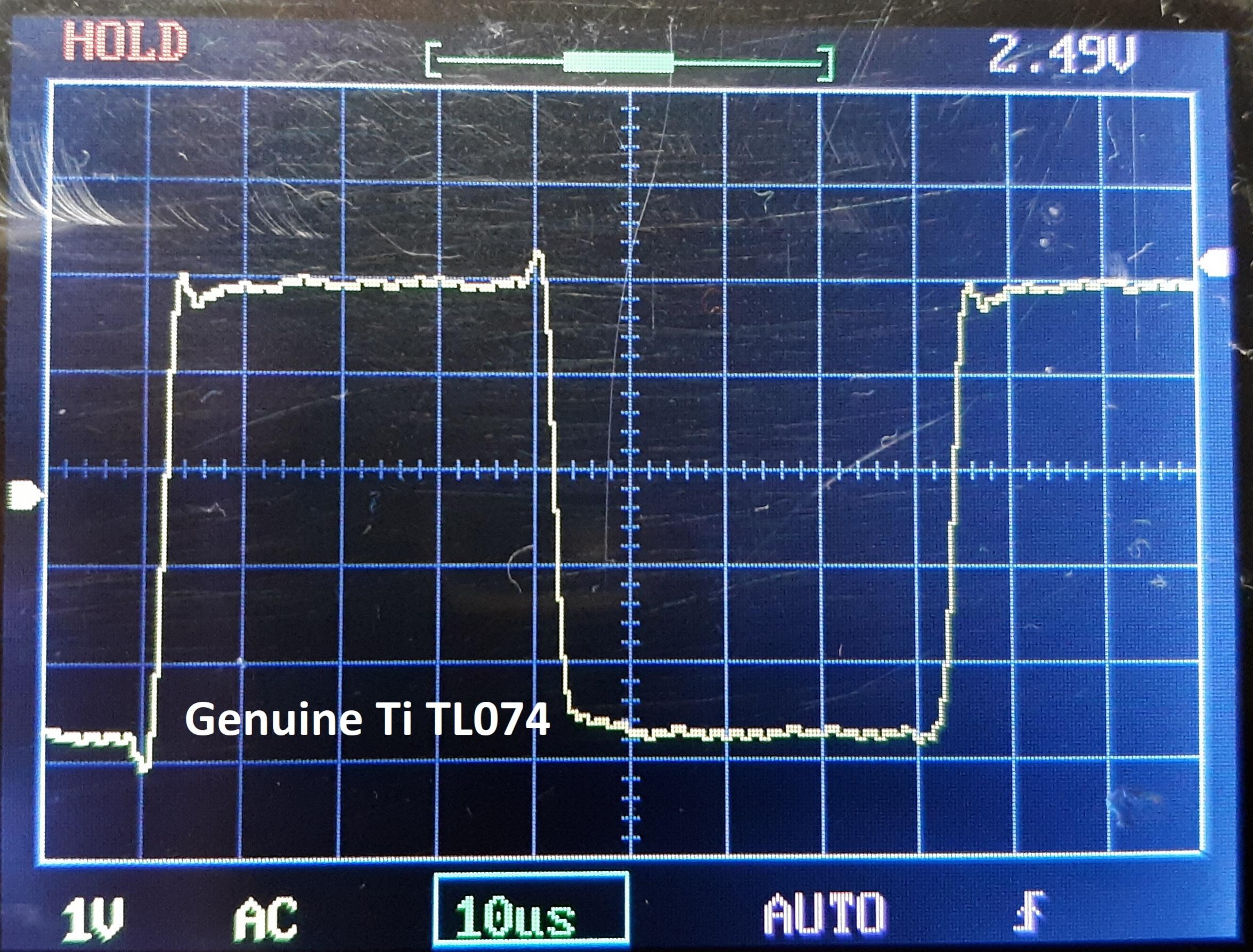

I recently bought TL074 from AliExpress and they are not performing as expected.
Can you help identify if they are genuine or fake based upon the voltage follower waveform (square wave input) and the laser marking?

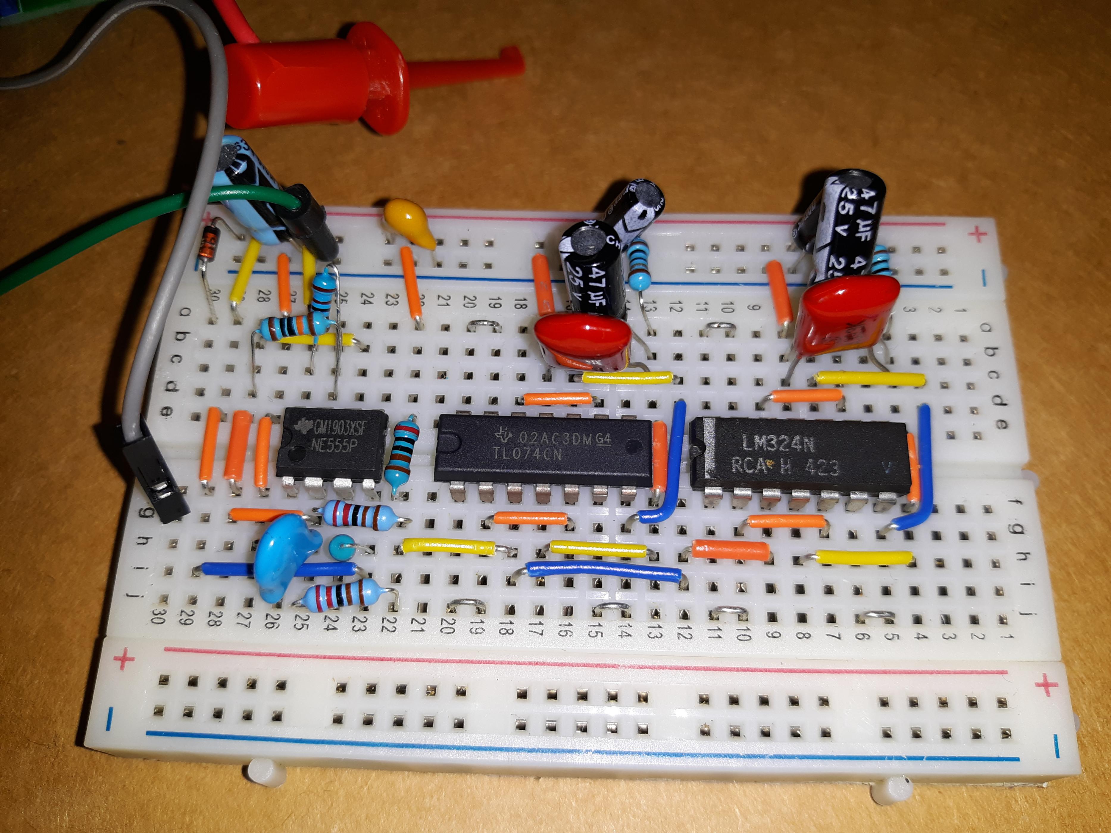

I created an square input signal with an NE555. The output is connected to the TL074 through a 1.1k Ohm resistor. Then for a little level shifting of the input square wave the input of the op amp is connected to Vcc with a 2k Ohm resistor and to GND with another 2k Ohm resistor.
The output is viewed with a $10 DSO138 oscilloscope. An LM317 is used to provide 15V for Vcc.
Outputs from the AliExpress purchased sample (laser marked Ti TL074) are compared with a reference genuine Ti TL074 sample purchased from an authorized distributor. The authorized distributor is Mouser.
The slew rate does not look the same. The AliExpress purchased sample is very very slow. Also the maximum and minimum output voltages are different too. So the voltage follower output signal "signature" is quite different for these AliExpress purchased samples.
Perhaps this simple and low cost test setup can be the basis of a basic fake op-amp detector? Many other DIY members have access to a scope of some sort plus NE555 to create a database of signatures and to compare their own questionable devices.

What are your own eyes telling you... But also double check all your connections on that board as something seems very off with that 2nd waveform.
I get the same result if I swap the positions of the genuine "reference" and "under test" op-amp. So it appears that it is the op-amp not the board. Also this is the second test board. The first test board was not as neat looking but gave the exact same results. The other test board is more complicated and holds single, dual and quad op-amps.

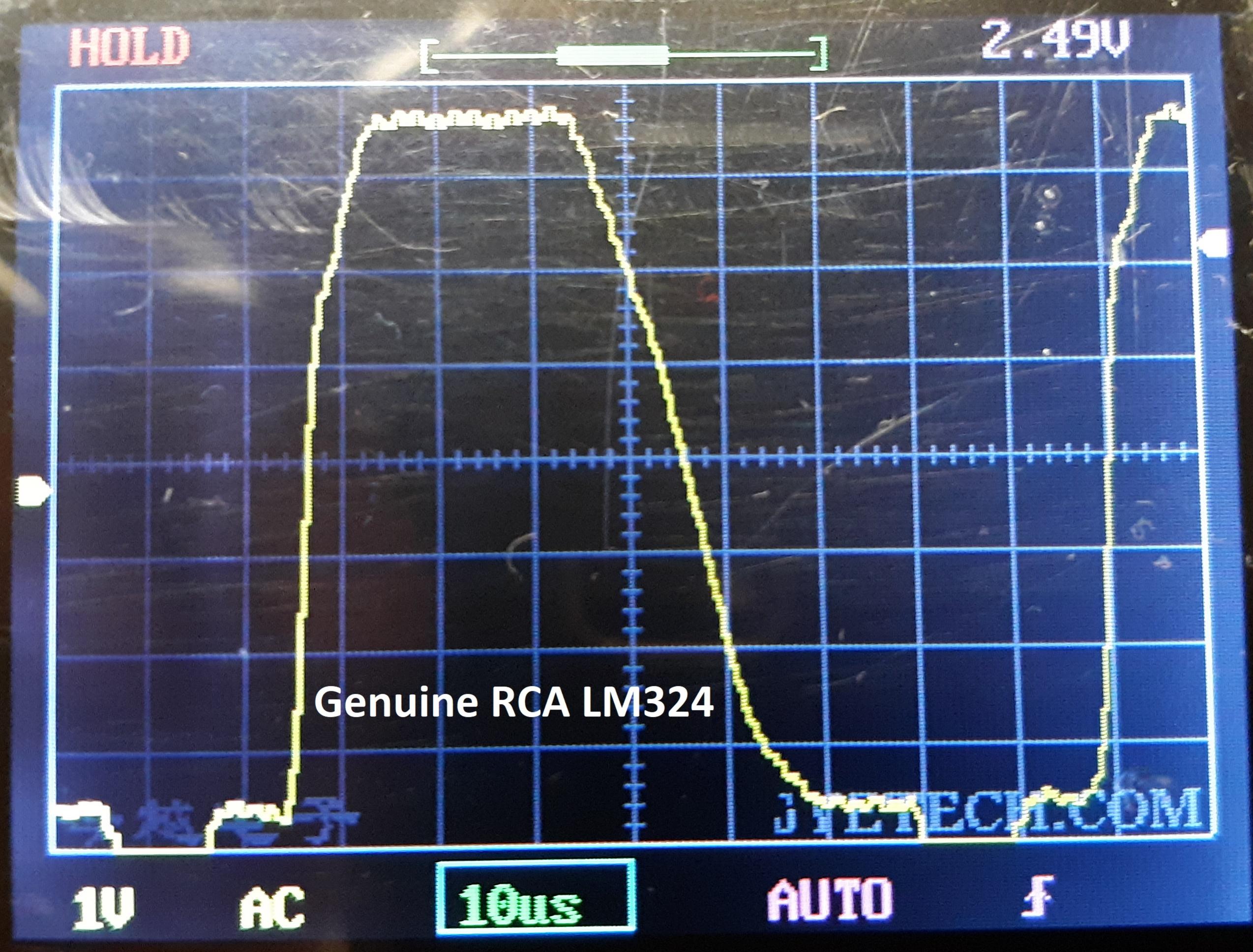

I double checked the connections and swapped the parts. Same results.

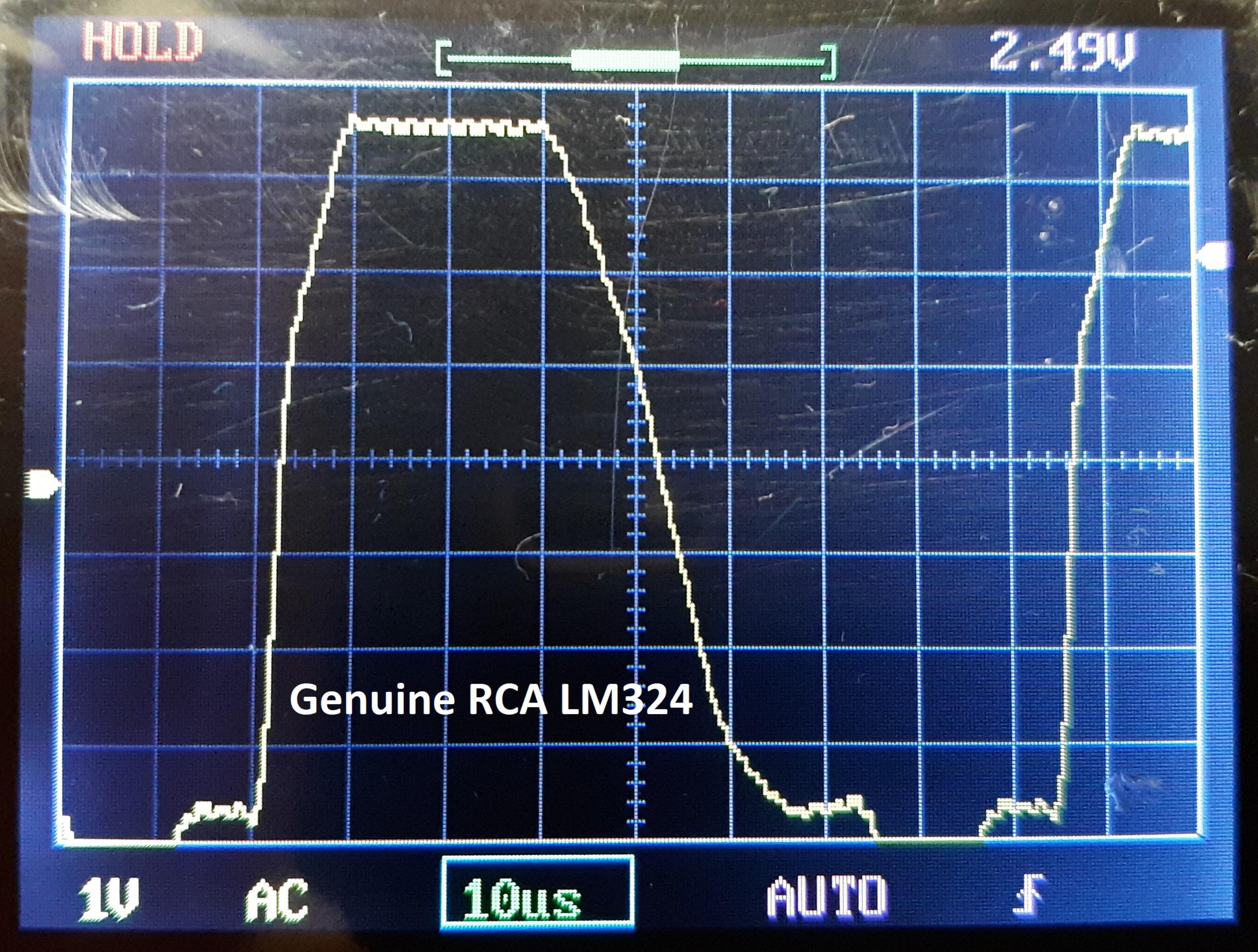

I went through my parts box and measured my other op-amps and I found that an old RCA LM324 behaves quite a bit like this AliExpress op amp that is laser marked TL074.
In the attached scope image the voltage follower behavior of the old RCA LM324 looks like this AliExpress op amp that is laser marked TL074.
Also I put a very small resistor in the Vcc lines and the current draw matches the LM324. The current draw is much lower than the genuine Ti TL074 reference device that I bought from Mouser.
So the slopes, maximum voltages, glitches and current draw very closely match an LM324. Nothing like the genuine Ti TL074 reference part.

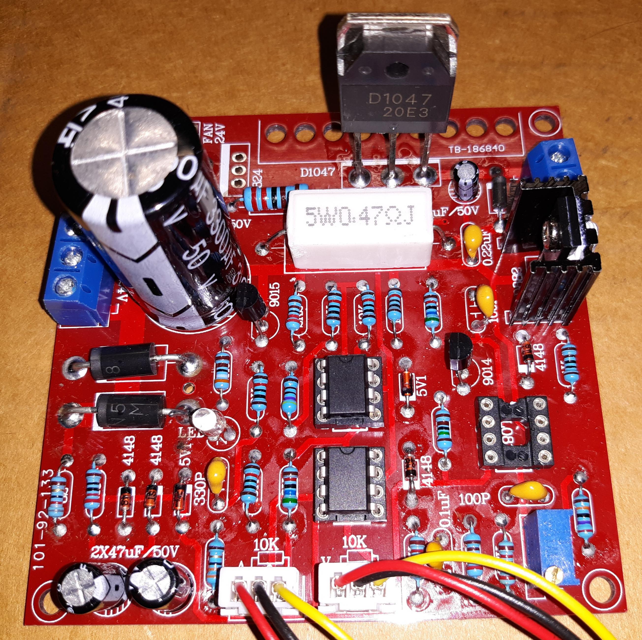

To help explain why I have enclosed images of a couple of useful devices/boards/DIY kits that I bought from AliExpress.
One is a useful laboratory supply that uses three TL081 that I have setup with two 10 turn potentiometers for voltage and the current limit.
The second is a nicely designed preamplifier that uses four NE5534.
I would like to know that both are using genuine parts. There is not much point in getting a nice preamplifier if it has slow and noisy fake op amps. Also the laboratory supply might be noisy with fake op amps and it might also be unreliable and/or dangerous to the attached equipment.
Based upon my finding it might be necessary for me to conclude that I need to discard all the semiconductors from such kits and boards. (And purchase replacements from authorized distributors.)
I also seriously wonder how many bad reviews of the NE5532/NE5534 or TL071/81/72/82/74/84 are actually reviews of LM358 or LM324 or other fake/rebranded op amps and the reviewer never knew why it sounded bad. After all a huge amount of the most critically acclaimed recordings went through a room full of equipment built with op amps such as the NE5532 and TL072.
The lab power supply, I had one, the TL081s weren't and one went up like a firecracker.
The design depends on one TL081 output being clamped to zero volts immediately when the power is turned off, to prevent any spikes in output voltage, and in my case, this was happening continuously due to a bad zener diode.
Genuine TL081 has output protection and therefore it survives. Whatever they'd put in did not. Also on this board they run damn close to the absolute maximum specified rail voltage.
Probably if not for the faulty zener, it would have been ok for a while.
I changed the power transistor at the same time, on the assumption it was also fake.

The op amps have two local bypass capacitors and then a low value sense resistor to Vcc and then there is another bypass capacitor for each chip.
However I considered your advice and to be safe I soldered ceramic (monolithic) 4.7uF bypass capacitors directly to the leads of the NE555 and to each of the op amps. I did not observe any change in the scope waveforms so I believe we are ok on the bypassing.
My guess is that these are just LM324 type.

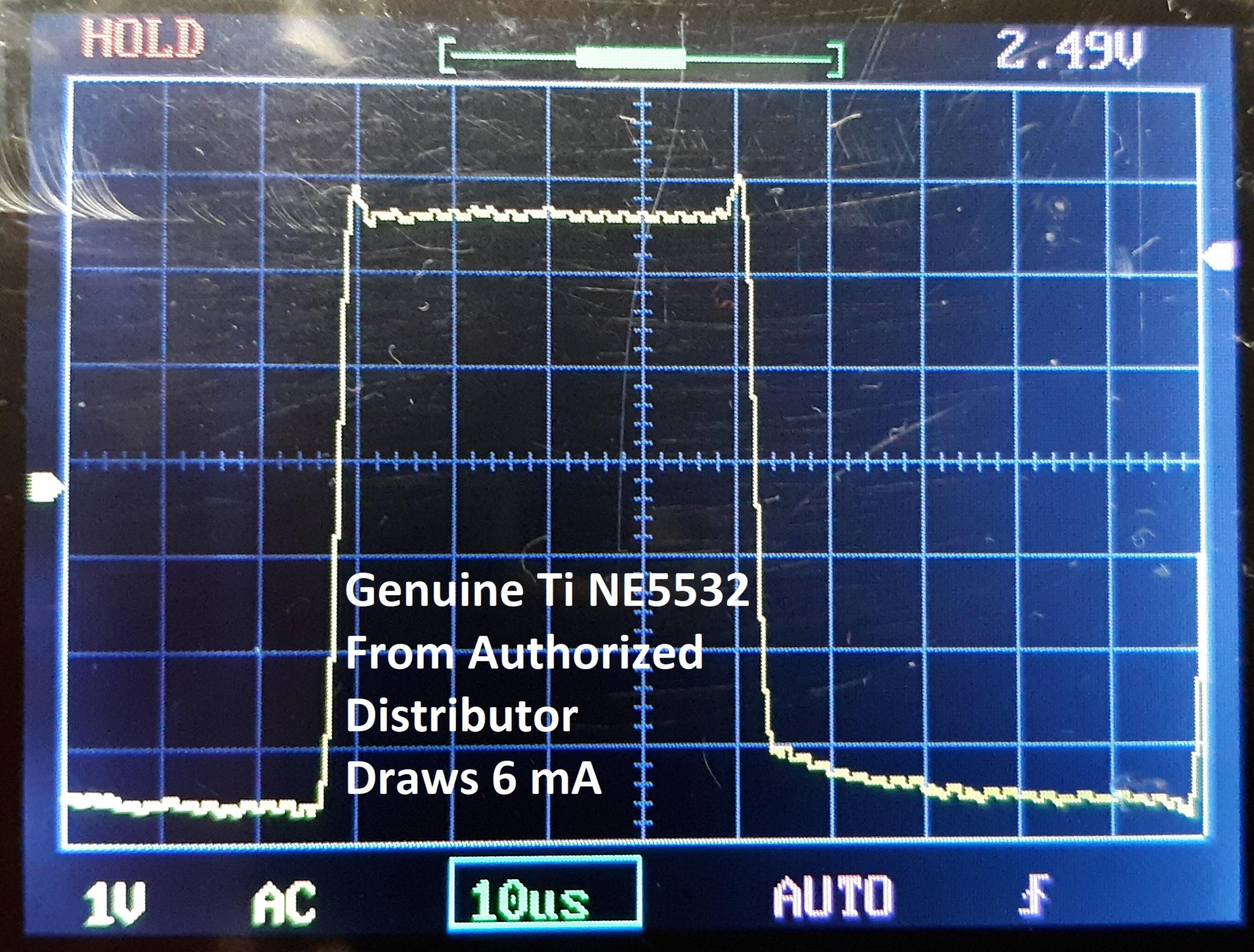

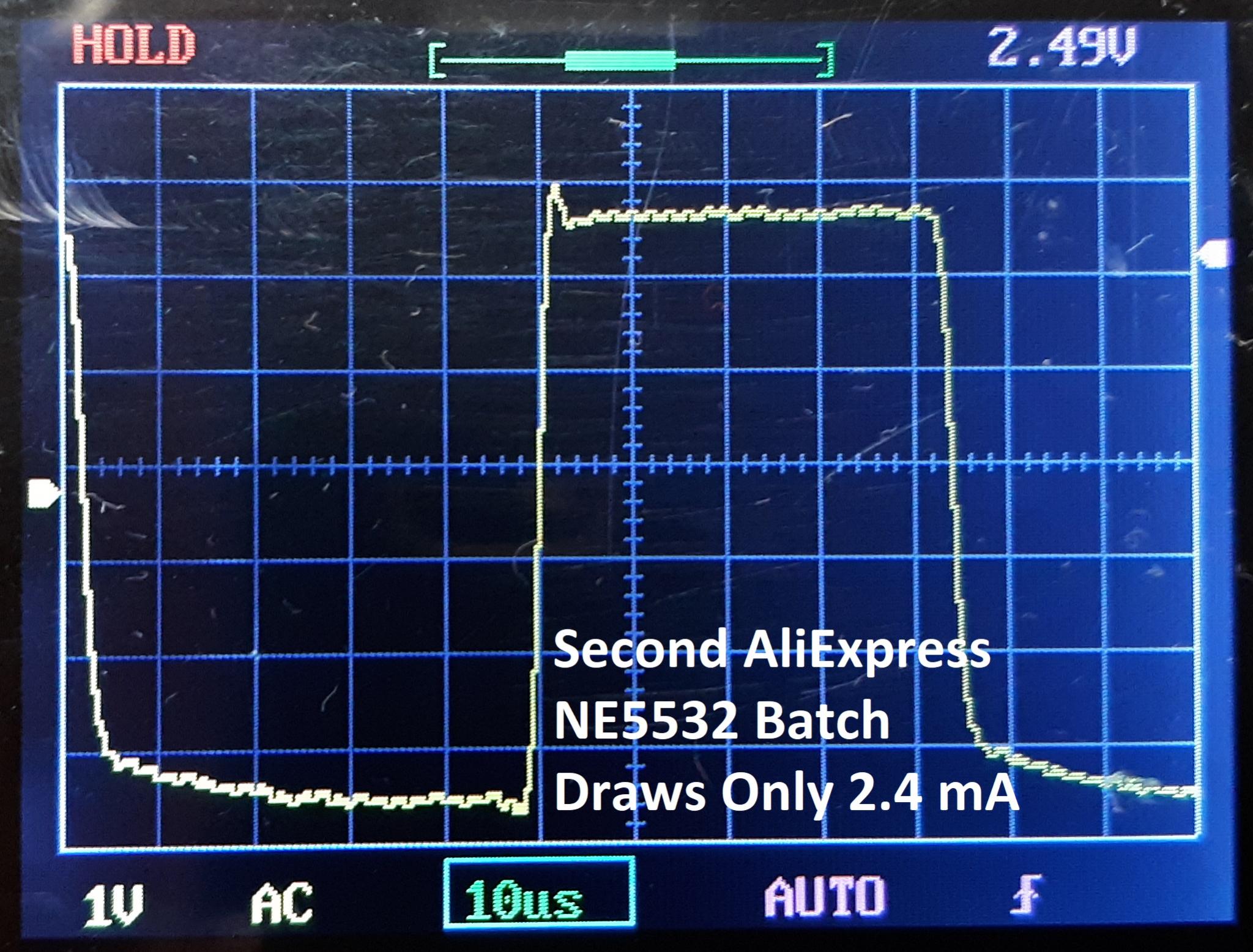

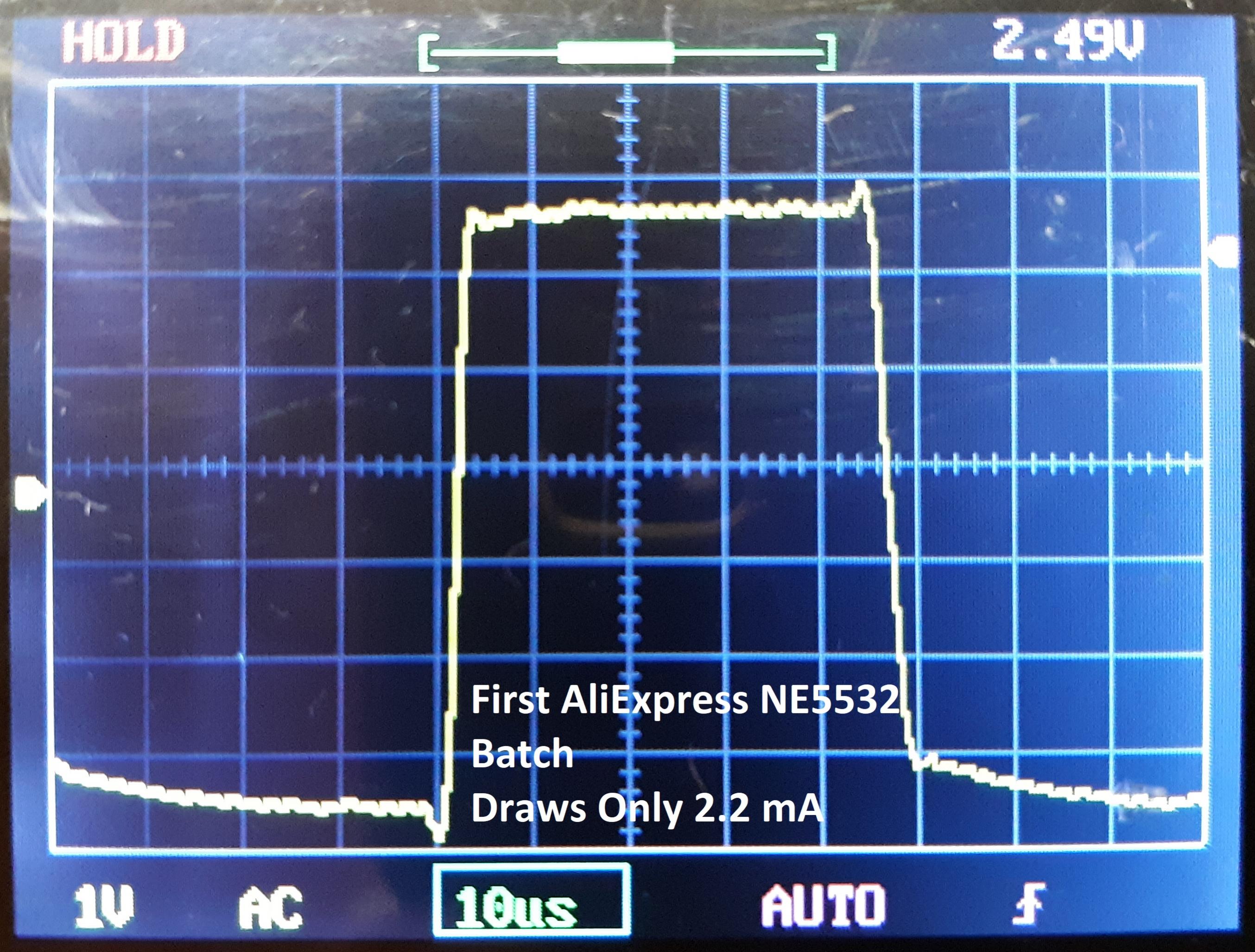

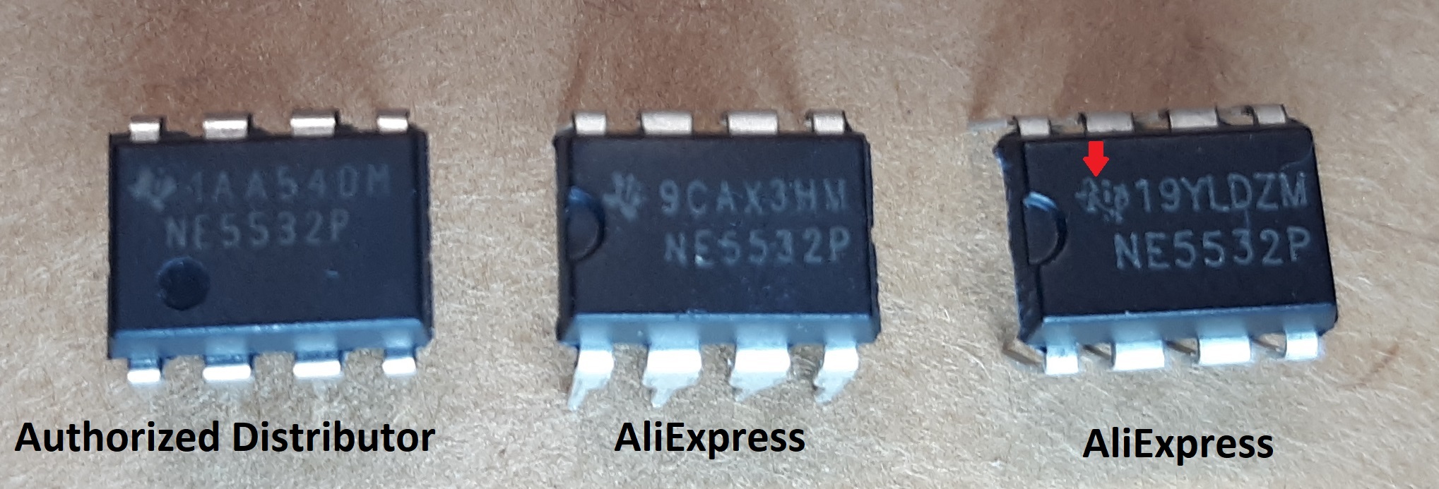

Today I got around to testing two batches of dual op amps marked "NE5532".
They are marked 9CAX3HM and 19YLDZM. (Anyone else seen these?)
At first they look quite a bit like genuine Ti NE5532 from an authorized distributor. The signature of the voltage follower output looks really similar to an NE5532.
But the real NE5532 draws 6 mA. The ones purchased from AliExpress draw 2.2 mA and 2.4 mA. That seems to be too much of a spread? What do you think? Ever seen real NE5532 with such low currents?
From the laser marking (attached) and the very low currents should we conclude that these are fake too?
Nope, definitely they're fake. I only a couple of days ago checked the supply current of some Taobao AD811JR I'd bought a while back. I measured about 7mA - I concluded they're fake as the DS typical is over double that.
