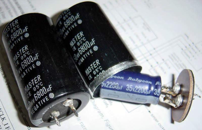

Im not going to address the veracity of the image. I have often heard that image is from an example on how to retrofit a cap into an older larger one for restoration purposes.
You can also ask NCC's sister company United Chemi-con .
Why would you go to all that trouble, if you were restoring something youd get the correct cap or just solder a new cap in the circuit... not go to all the hassle of opening up a cap adding the new one then closing the case again
There are some purists who want to hide new, non-original parts in order that the restored unit should LOOK completely original.
Personally I don't subscribe to that way of thinking. I want any tech who looks at the machine subsequent to my having worked on it, to know EXACTLY what I did, in order to make his life easier.

Don't matter, its like going to all that trouble to put a smaller cap with different voltage, value etc in a larger cap body... its pointless unless you are going to fake some one, you would not do it on working equipment... if you wanted it to keep working.
