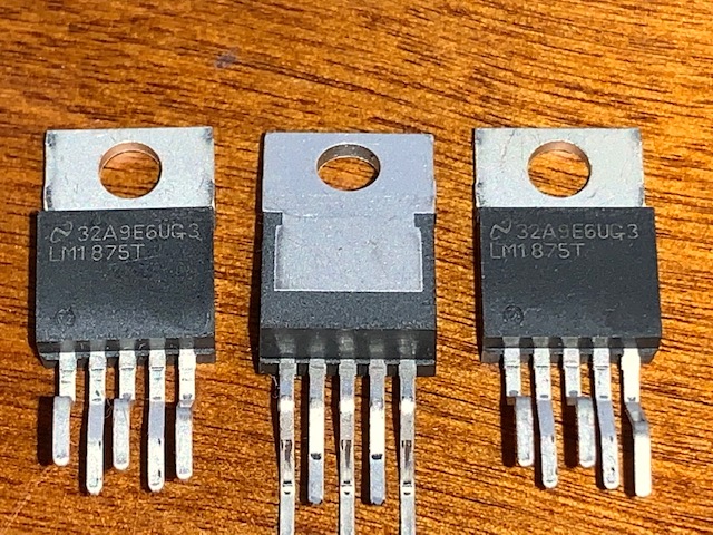

this chip looks used = 2nd hand. the pin legs are not conform with the original LM1875 because the legs starting bigger at the case and get smaller at the end.
on the top you can see some black ring and this looks definitely used.
as you can read in the other thread https://www.diyaudio.com/forums/chip-amps/341675-ebay-mono-lm1875-kit-12.html#post5916658 its not easy without lab equipment to check which kin of chip you get here. the safe side is 18V per rail!

I bought some LM1875T chips from America - wrong they came from Bangkok.
Reading on the web there's every chance these are fakes..... would be grateful if you could have a look here IMG-0119 — imgbb.com and let me have your thoughts? I just can't recall or find the logo brand.

Have you been had? Perhaps, if you paid a price similar to what you could have bought them for at a reputed US dealer.
If you, like me, have bought 10 or more at a ridiculously low price my opinion is you have not "been had". Most chips are manufactured in Asia, both genuine and fakes. You hardly get exactly the same product for 10-20% of the "genuine" US price.
The logo is National Semiconductor that is now owned by TI.
My LM1875s (probably not genuine) can handle rails up to +/-29.5V (I did not test higher) but have some stability issues above +/- 24V, which is also known from genuine LM1875s. Perhaps worse than for genuine.
I made a well sounding amplifier with these LM1875 and for a very modest price. THD seems correct. This is an experimental amplifier for trying out the LM1875, not an amplifier I will use many years ahead as my main amplifier. LM1875 is a very nice IC to work with because it has only 5 pins and is simple in implementation for a good result. For what I paid, I do not feel tricked.
If the LM1875 is not "genuine", what do we then get? A die-optimized (shrinked/shrunk) IC based on the original design? ICs that were discarded in the original production batch due to some spec. deviations? Reworked old items? If they actually work you can take a guess - but you may never know for sure.
If you want to be certain what you get, buy at a reputed dealer for the genuine price. Else, accept they will probably work for what you need and keep the rail voltages down to 18-22V as suggested by Chris. Sitting worrying afterwards will only irritate you.

Tapered sides or not may be an indication but not firm proof. Semiconductor manufacturers use varying wafer sites around in Asia. The documentation may have been issued with tapered sides while a wafer site later used a square house. As I recall it, mine at least have tapered sides.

these are 100% authentic , bought from TI.com .
Where did you get yours?

I have purchased from Tayda many times, and to the best of my knowledge, everything has been genuine . I have not done extensive testing but everything has measured and functioned correctly with no failures or issues. This includes chip amp ICs, voltage regulator ICs, transistors, resistors, capacitors, and many miscellaneous hardware items. The only issue I've experienced was getting NXP branded transistors (BD139 & BD140) when the description shows STMicroelectronics (formerly SGS-Thompson) as the manufacturer. Not what I wanted but they seem to function acceptably.

I got them from Tayda Electronics USA and was a little surprised when the package came from Bangkok.... address given earlier in thread. Glad to know they are genuine. Thank you to you all for the replies.
