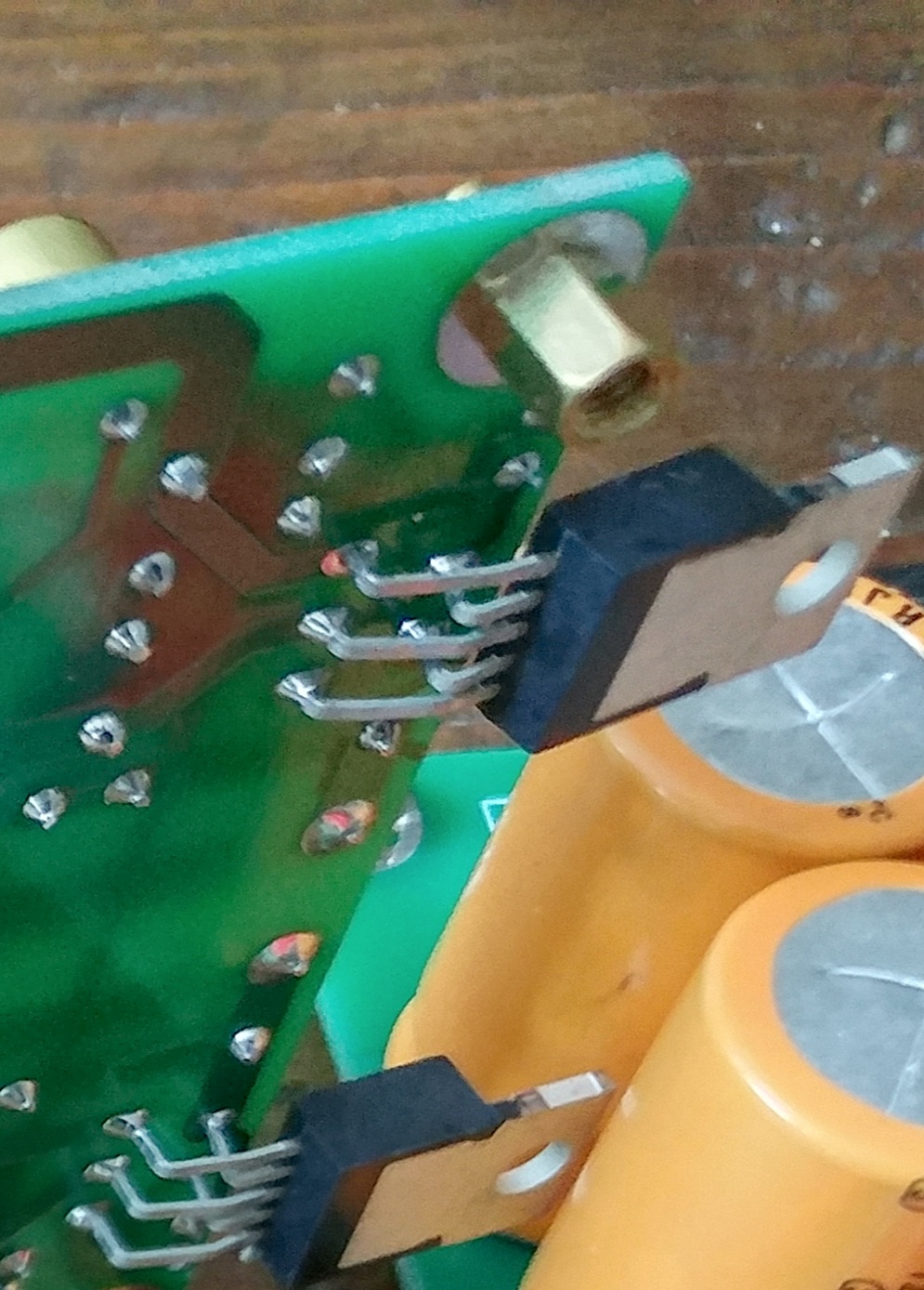

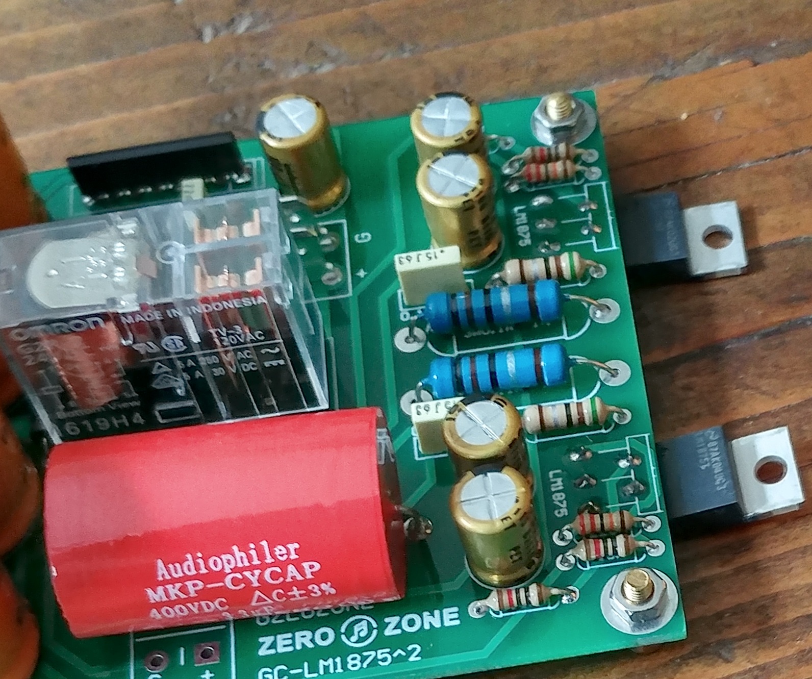

i built 2 identical circuits using this chip, and they behave vastly different. The one that was built using chips that were suspiciously cheap (this guy was selling em little under $2 a piece. I just had to bite the bullet), and this amp not only runs wayyy too cool but sounds tinny (read: thin, not enough drive) and it was much harder to tame. I had to up the gain to 30 to kill the oscillation where as the other amp works fine at gain of 10 and sounds better.
Now the chips look completely identical. I even cracked open the suspicious ones and their crystal was the size its suppose to be. Maybe the one thats running hotter is the fake one and lm1875s are suppose to run very cool?
I plan on going into the town tomorrow, pick up some different lm1875s and also tda2030s to compare their behavior.
What are your thoughts?
Will post pics upon request. Thank you.

Thoughts... measure the quiescent current of each chip and look and also see if any obvious distortion is present when viewed on a scope with a 10kHz test signal.
Identical circuits but physically two different amps. I would swap the chips between the two boards as 100% confirmation something with the chip is amiss.
The LM1875 data sheets suggests around 70ma quiescent and the TDA 2030 a little lower at typically 50 ma. In practice both would feel pretty similar heat wise with those currents.
Sadly i dont have an oscilloscope or a microscrope. The only data i have to go by is this website, which according to it the 'fake' chip i have should be genuine because of the die size and the package appearance.
Which makes me wonder if the website is wrong or what i have is just different kind of counterfeit.

^^^^^^^ THAT.
Any decent speaker is worth more than 5 or 6 bucks so your "savings" can become very expensive.
Don´t even waste time testing the bad ones, you already know they are.
FWIW I was also bitten, in this case with 100 TDA2050, which I bought at a local supplier, guaranteed to be from the last batch made and paid full price for them.
When subject to +/- 20V rails (perfectly fine for 2050) they overheat even without load or signal, clear indication of internal semiconductors breaking down.
They supply dirty fuzzy audio and after a couple minutes they self turn off.
Now they are perfectly happy with +/- 14V , work perfect, clean sound ... which makes me think they are actual TDA2030 or equivalent dies.
So it´s not a total loss, but I couldn´t make the 25W guitar amplifier I was about to launch, and I am not interested in 15W ones, where the market is *crowded*, and importing LM1875 (not available here) becomes expensive for the target audience I expect.
