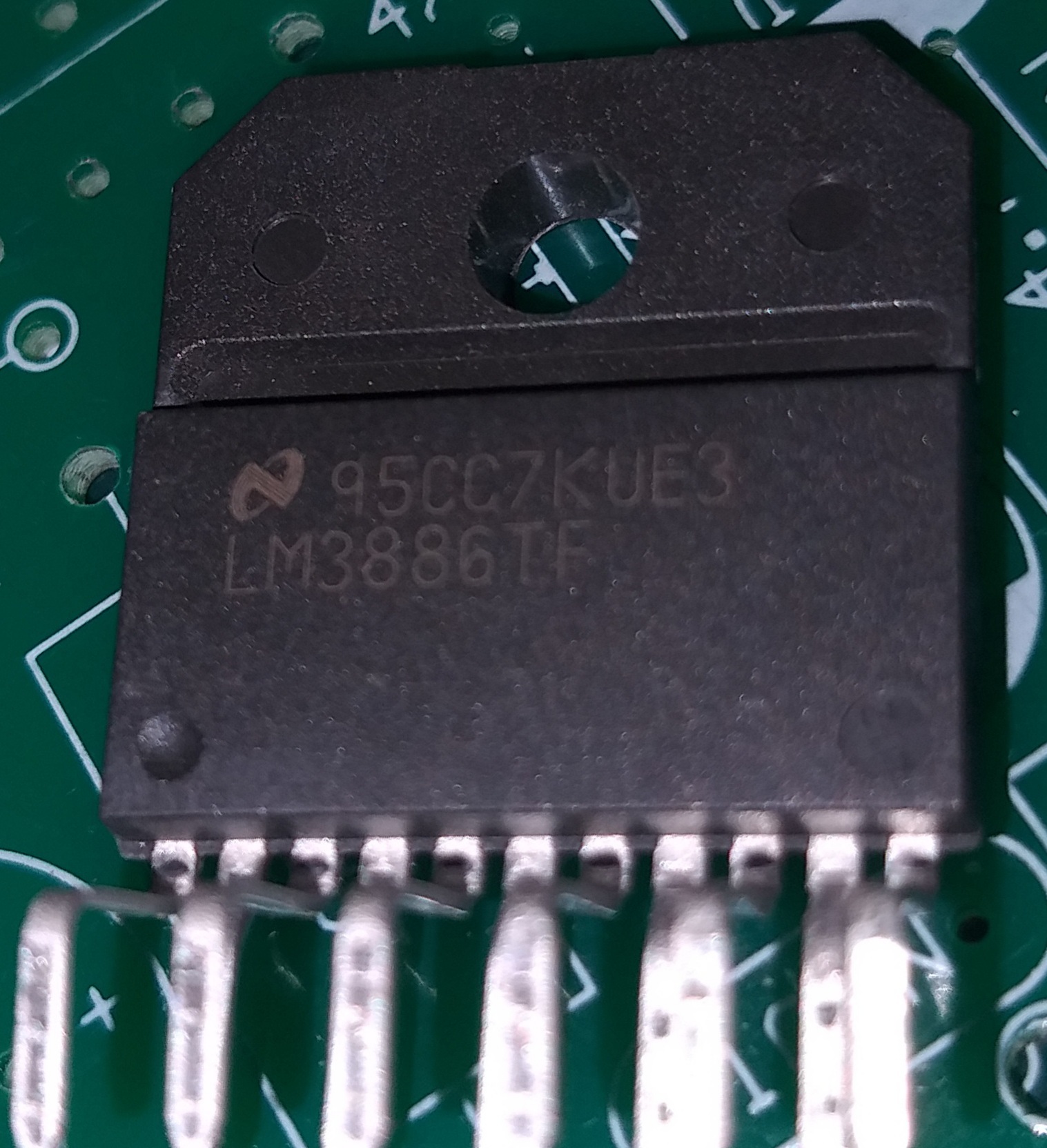

Got some LM3886TF locally, checkout quality,are the original ICs or fakes

There are small round marks on the plastic, some engraving is there at times in those ejector pins in original chips
I have never handled them, so wait for replies from those who actually did.

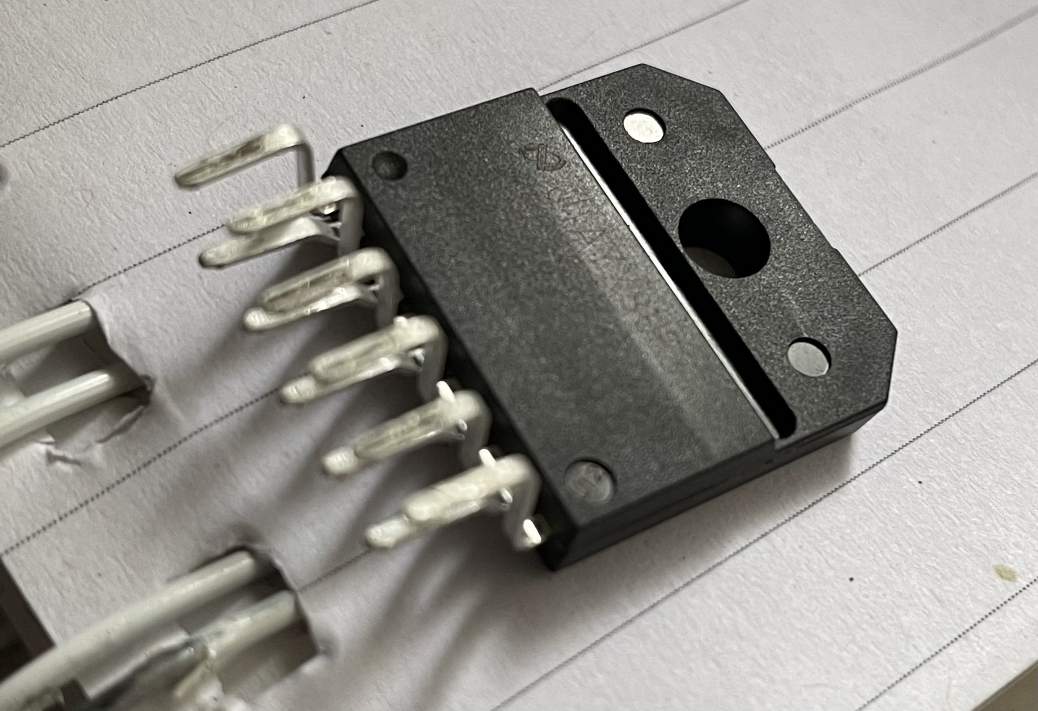

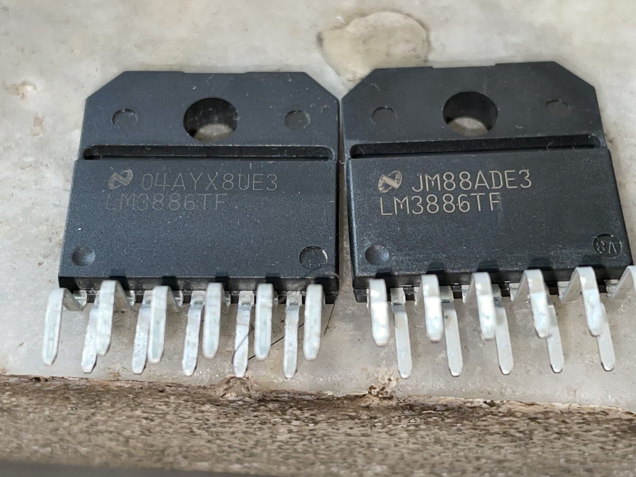

have bought from DiyAudioCart but compared to my LM1876 TI Sample and LM3886 ( Micheal ) it doesn’t look good.
First image of single LM3886 is from DAC, second is comparison of DAC and USA purchase ($20 a pair) bought 4pairs and using one pair works 😍.

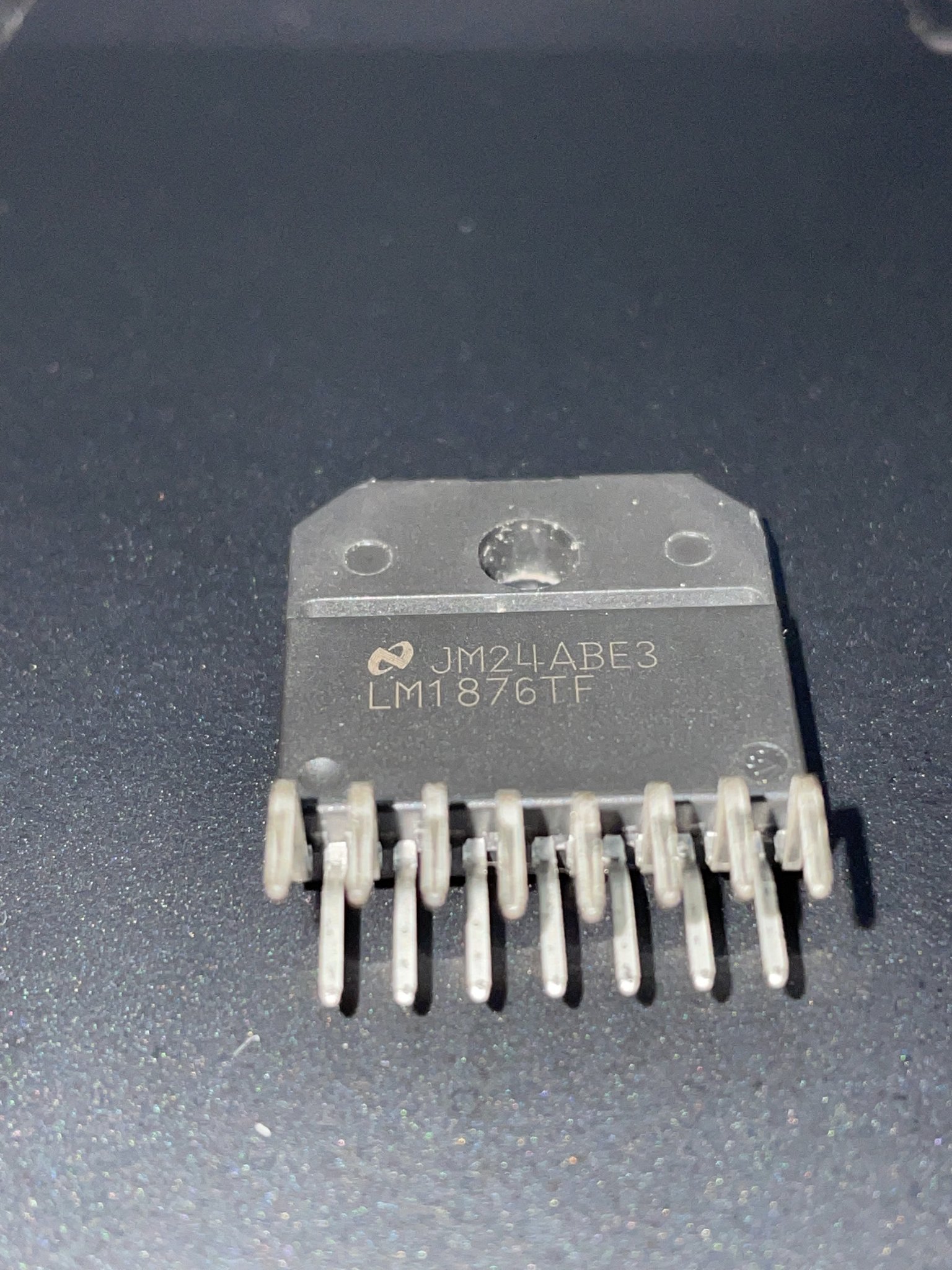

third is the LM1876 Texas sample.
the thing to see is DAC chips has a rub mark where the serial # is printed and laser etch is not as bright as the other two. Not used them yet but planning to test them in a different board. Currently using a composite amp LM3886 My Rev Ref A
