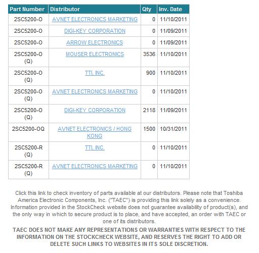

There are only a few official distributors of the genuine 2SC5200 according to toshiba.com webpage. There are no official distributors in EU listed as having them in stock on toshiba.de
