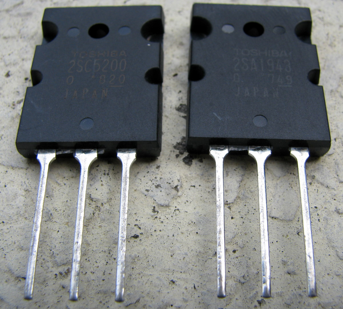

One way to test them is to build a little test rig and see if they survive at close to their expected SOAR.
Can't say for the pictures you show.
I have been had on two occasions in the past (both times buying off ebay). As noted above, there are two ways you can gain confidence:
-1- Build a test jig and drive the devices at a good fraction of their rated current. At the same time test the DC Hfe as you wind up the current. This tests bonding and die current limits, and allows you to plot the DC Hfe as a function of collector current. You should find the HFe is very similar to that published for them (usually greater Hfe).
I found that one batch of fake devices firstly has low Hfe, and secondly failed at a small fraction of their rated current.
I also found that some of the fake devices had NO die in them at all - have a photo somewhere - I was laughing so hard when I found that I almost forgot what I paid for them.
As part of this crank up the voltage such that the devices are operating somewhere near max dissipation at a fair VCE. Obviously you will need a heatsink etc. Remember to keep the device inside it's SOA, but don't be shy to really test it.
If the above are OK, then I suggest you are OK.
If you are worried, and especially if a device fails:
-2- Crack a couple of samples open.
Most of the fake devices I had used very small dies. I also cracked open a "known good device" to compare. (seems stupid, but I really wanted to know what I was looking at)

Running at high current with sufficient base current to just saturate ON is another good test that does not dissipate enormous power. This will find small high voltage die
Boscoe,
why do you think they are fake? I don`t think they are.
That's what I also think. They look real to me unless they are super-fakes which I doubt. The markings are a little bit different but that's OK. They are probably manufactured in 2 different Toshiba's factories. As far as I know, there is a factory in Japan and an authentic Toshiba's factory in Thailand. 🙂 Here is a simple circuit for testing 2SC5200/2SA1943. There is an adapted version for 220V mains as well. Try it. 🙂

Just test the base-emitter capacitance and see if it's around 7 nF. If it's fake it will be less than half that.
If you get them through regular distribution channels, the chances of a fake are less than 5%. On E-bay, about 95%.
Yours actually *look* good to me, but I test samples from every batch from distributors, and every single device from surplus outlets.
