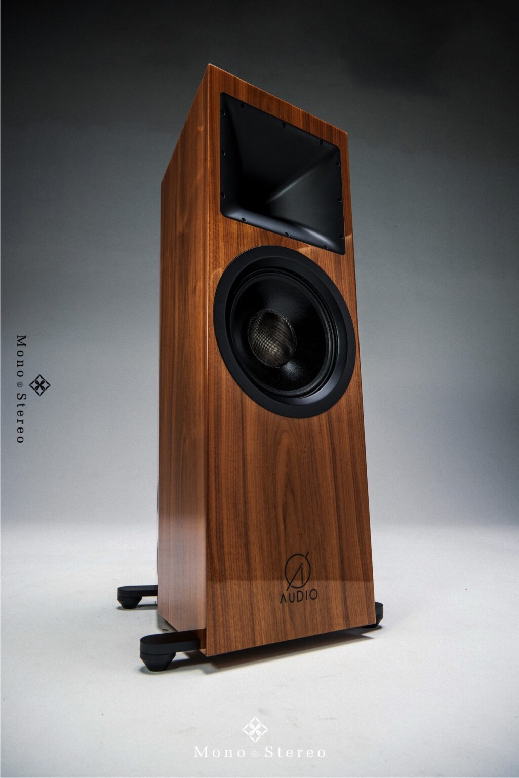

There is a new rave review of home speakers using 1.4" TexTreme CD, Oaudio Icon-12. Only candidates seem to be FaitalPro HF1460 and Eminence N314X, with the former at double the price at $730/each. Any experience with either one? (Rooting for cheaper one to be as good...)
BTW, anyone recognize the horn or the 12" driver used in that speaker? Hoping for DIY/oem alternatives.

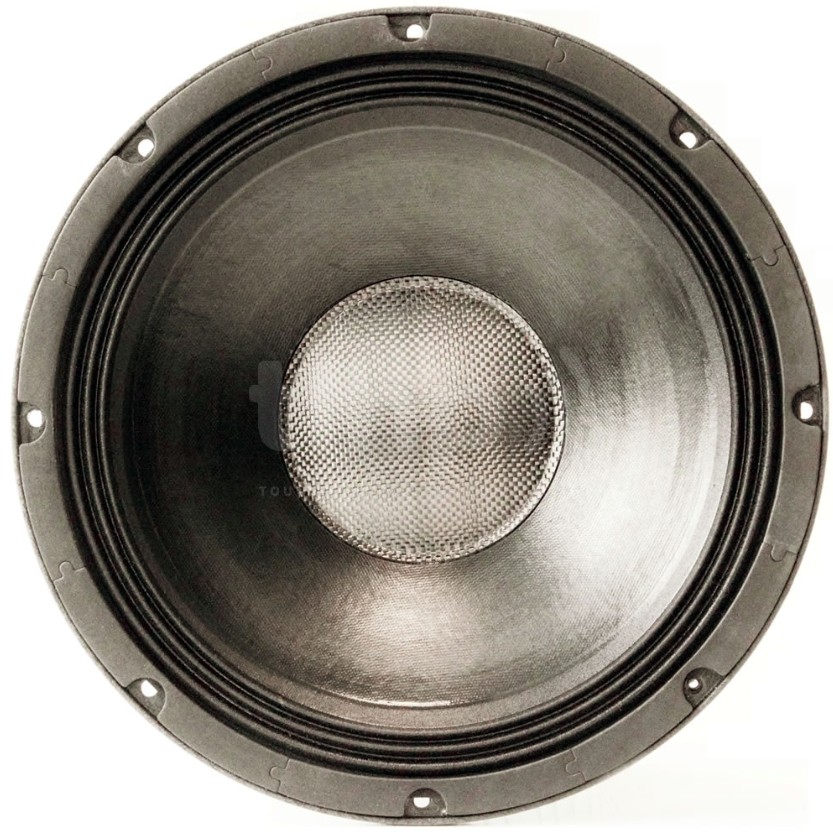

The 12" looks like the Kartesian wom300-vdiy
I don't think that's the right woofer. The triple surround doesn't match. Besides, I've heard SEAS custom builds these woofers for Oaudio (makes sense, both Norwegian companies).

Not avaiilable publically.anybody has an idea which horn they are using in Icon 12 speaker?
it is not. OEM driver.The 12" looks like the Kartesian wom300-vdiy
The "prototypes came with AE TD12xxx.
