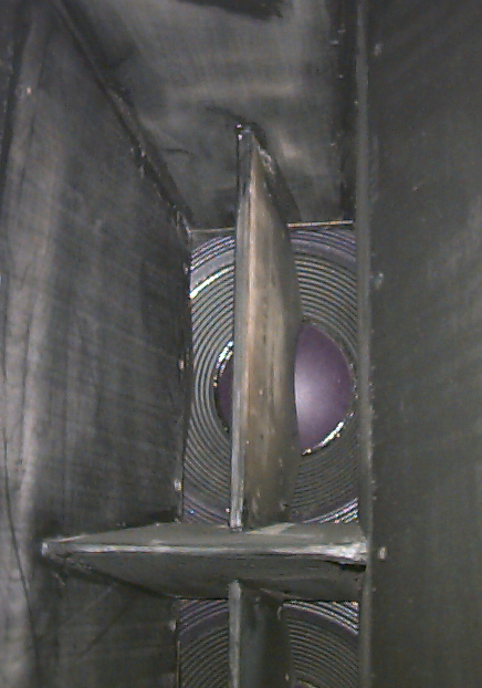

Jennygirl,Hopefully you are not facepalming too hard. I still have some learning with synergy's- gotta start somewhere! I am also not opposed to using the 10" 10CL51, I have those on hand as well- mounted in an older project
To figure the throat chamber size (ATC), it is necessary to accurately measure the volume the cone itself takes up, since a difference of as little as 50 cc can make a difference. This can be done by putting some thin plastic wrap over the cone and filling it up with water up to the gasket, then pouring the water into a measuring cup(s). Your 8" might be as little as 125cc, while the 10CL51 may be 2-4 times that. A cross sectional drawing of the cone is also useful to determine the shape needed to reduce ATC, if needed.
Gasket depth is usually not deep enough to prevent the outer perimeter of the cone from striking the baffle at Xmax or Xlim, so a ring around that area must be routed out, which increases ATC slightly. An example of the ring below, and a phase plug conforming to the cone shape. Offset drivers would need the plug to be circular.
Could you please measure the 10CL51 cone volume?
Thanks,
Art
