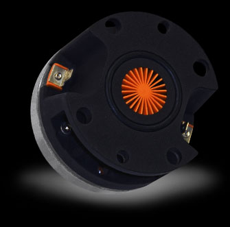

Hi Tinitus,
I did see the ribbon and waveguide on the Beyma website when I was looking into 18" drivers. I wish I had seen it sooner, as it may have been a neat tweeter to try. The performance looks truly incredible from the datasheet. They are prohibitively expensive though, at over $600 each.
My favorite thing about them is that the distortion doesn't seem to rise at lower frequencies like it does with the NeoPro5i. It looks like you could actually cross them over below 1500Hz which really opens up choices for the midbass.
