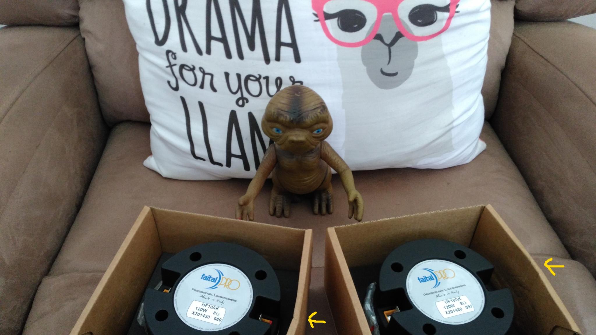

Just decided and pulled the trigger on two of this HF10AK's since all the positive reviews and that TD-2001 performance similarity, however one has a RE of ~6.3 Ohms and the other ~5.8 Ohms(tested with a cheap DMM), I though considering the price of this CD's I would receive a matched pair or at least close, but that's not the case.
Also not having much luck with USPS lately either, the box was smashed on one side like if they were dropped
, and its clearly visible on the small HF10AK's packages, luckily they had a nice foam padding there, not Part Express fault though.
Hopefully this is no big deal as I will using them with DSP, and not worry about RMA them.

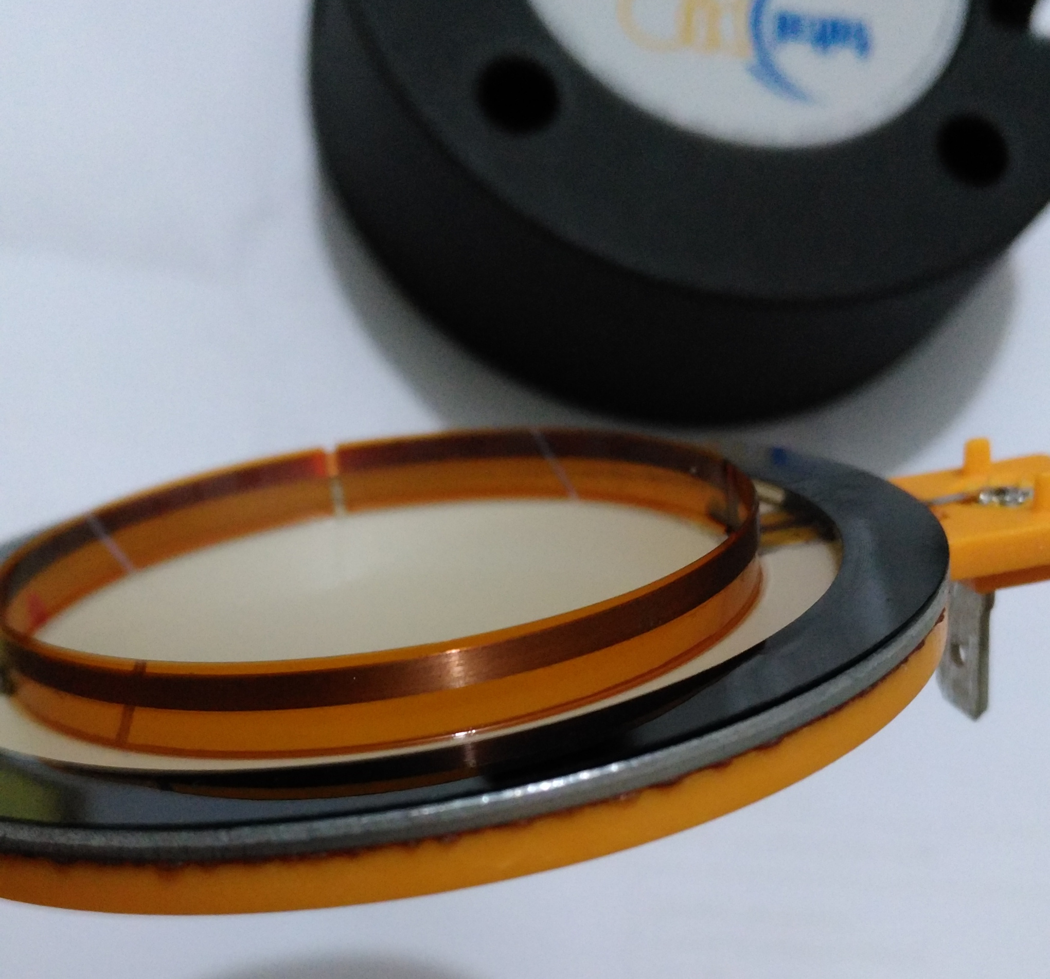

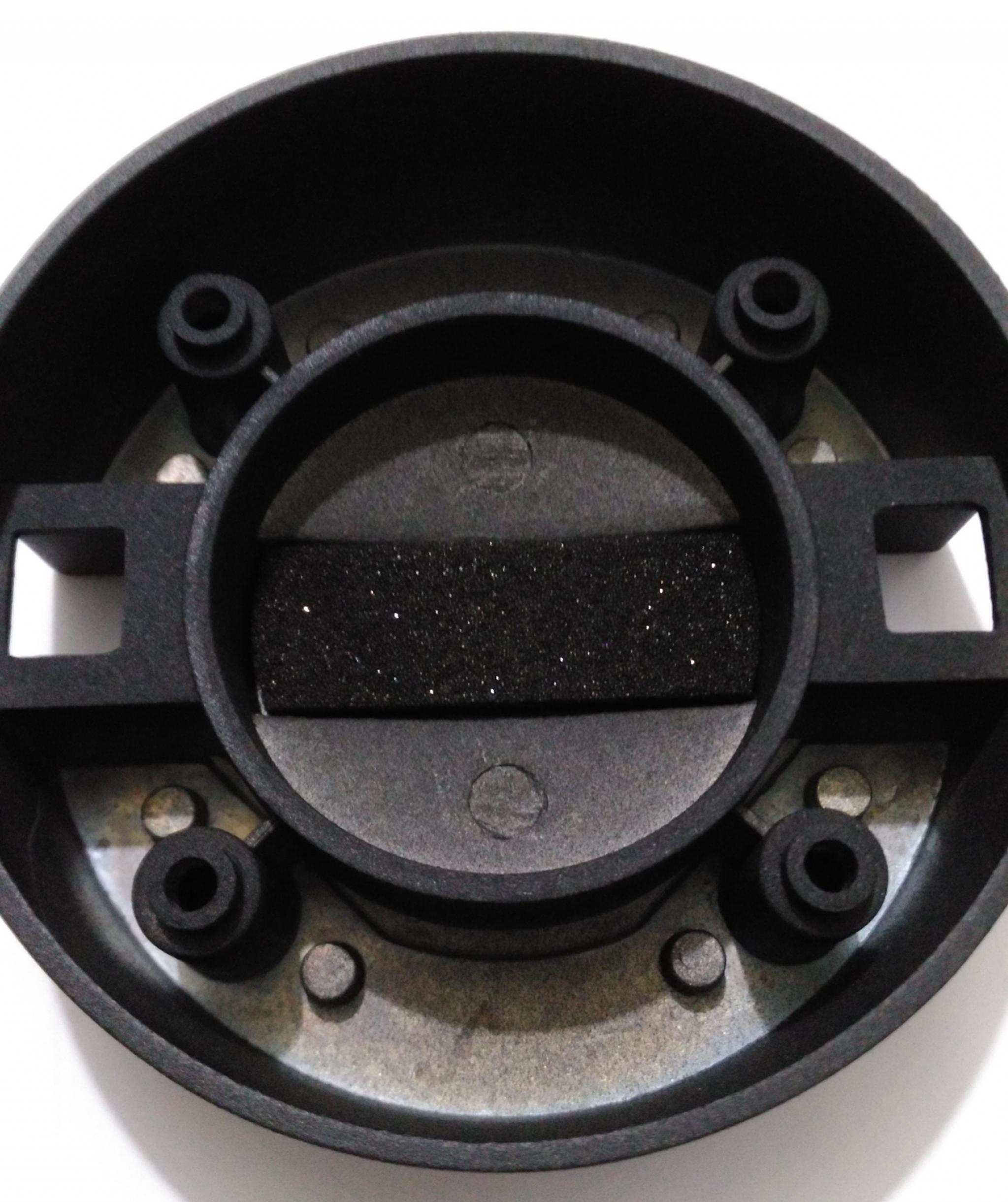

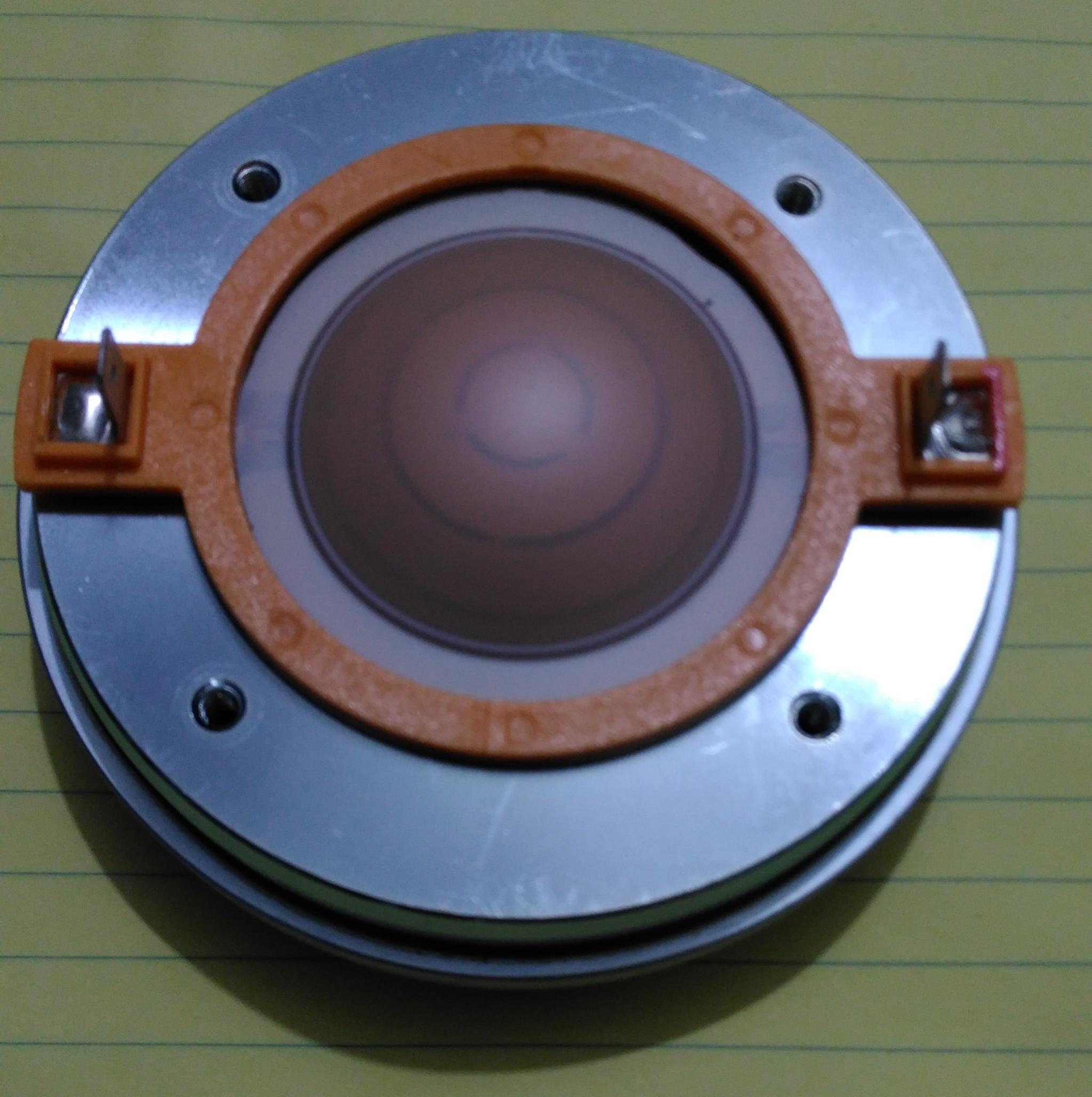

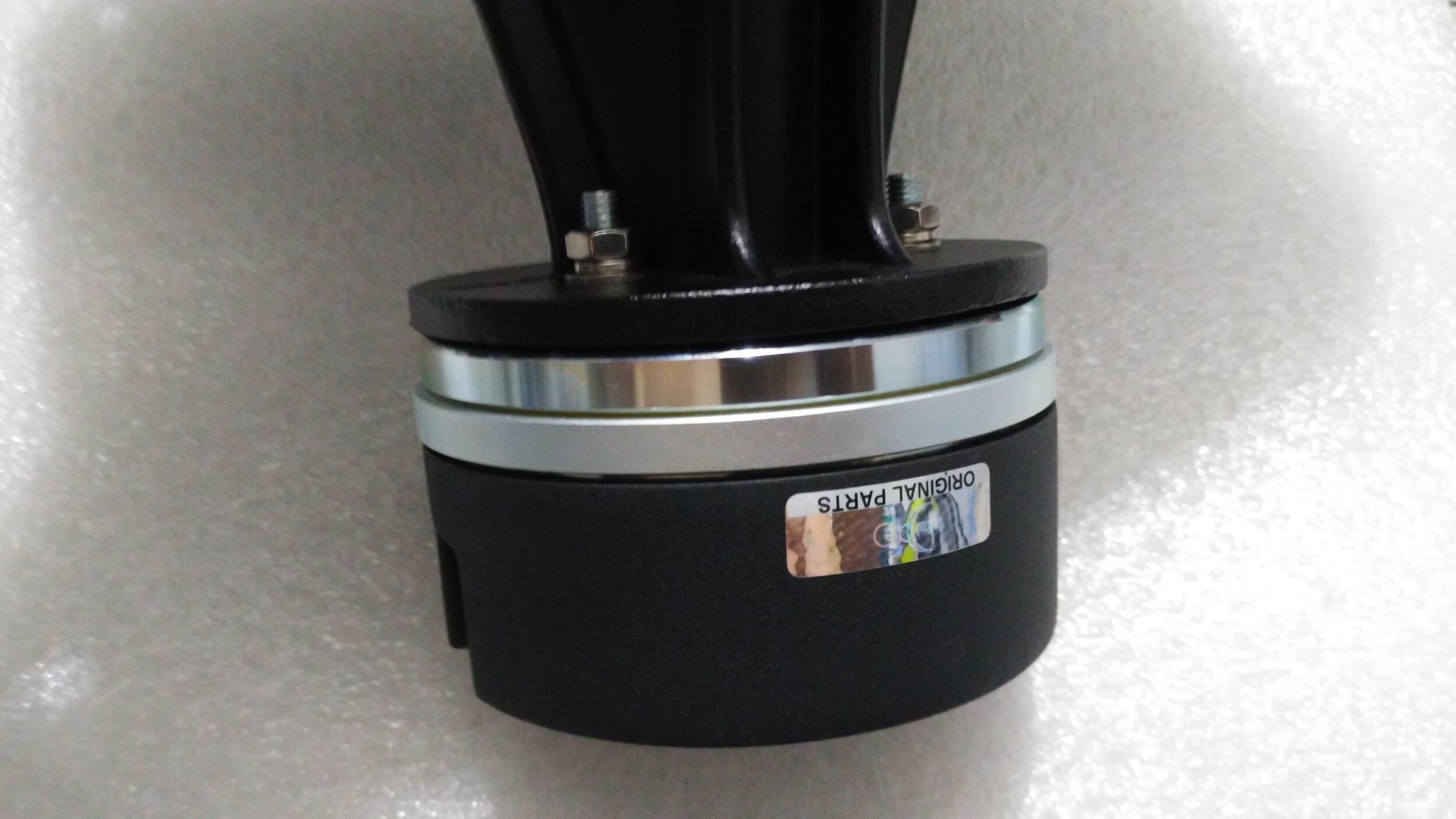

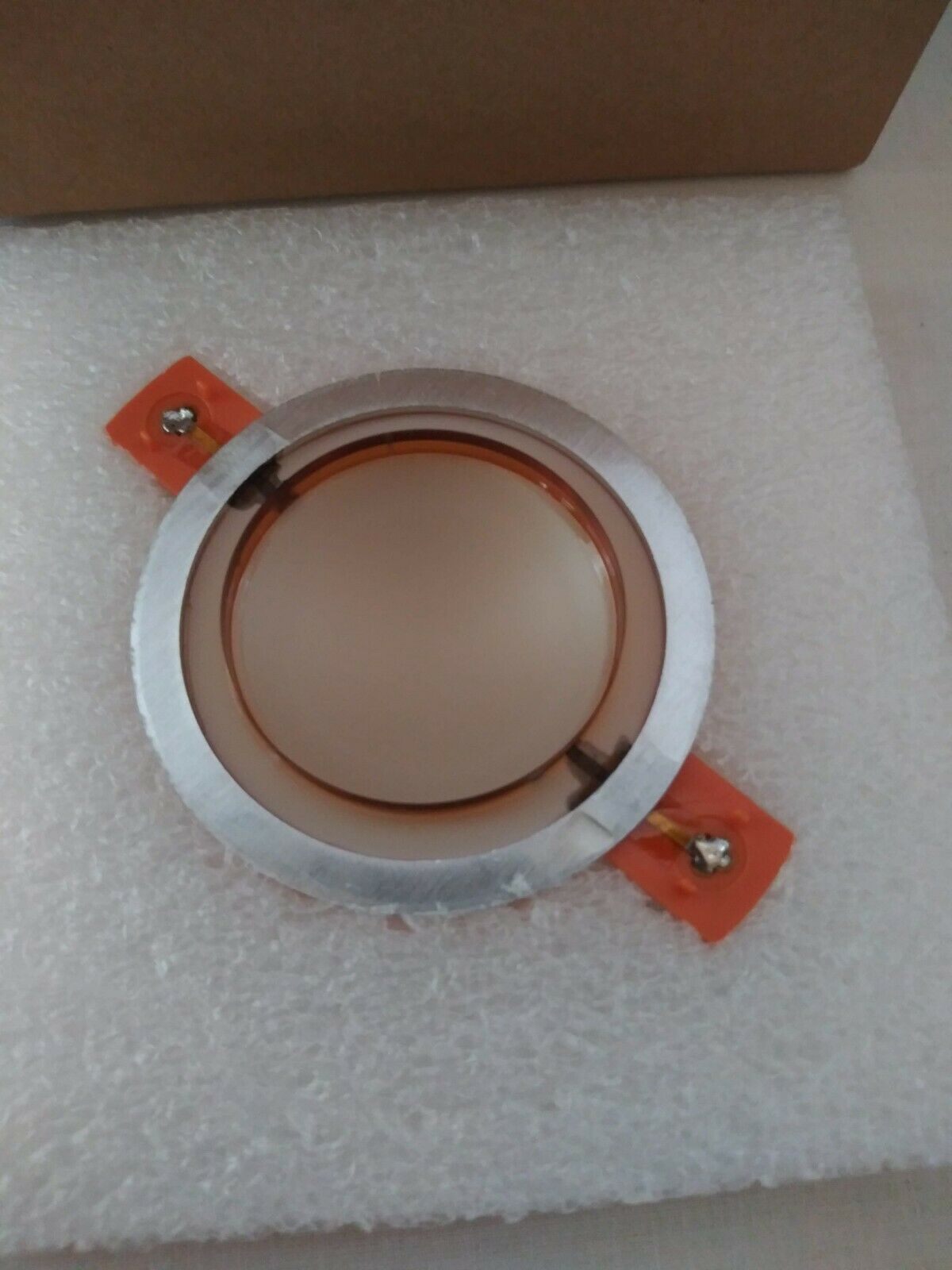

Hi thanks for the response, since one of the CD where not aligned with the mounting holes pattern(one had the brand upside down), I've decide to carefully open them and carefully inspect the diaphragms and internal construction, just found that both exhibit the same internal quality and the nice cast aluminum basket with a foam inside.🙂
However I've also noticed that both diaphragms had an black tape on top of the aluminum ring
, so as a guess that tape may be to add an extra clamping force and/or to reduce vibrations between the metals, but like I said just a guess, since I've seen others Faital Pro replacements that does not have this black tape on them, for example the replacement "HF10RK L192260" the 16 Ohms version like shown below:
Regardless I will try to quick test them just to see for performance similarity but not with precision either, hopefully during weekend.

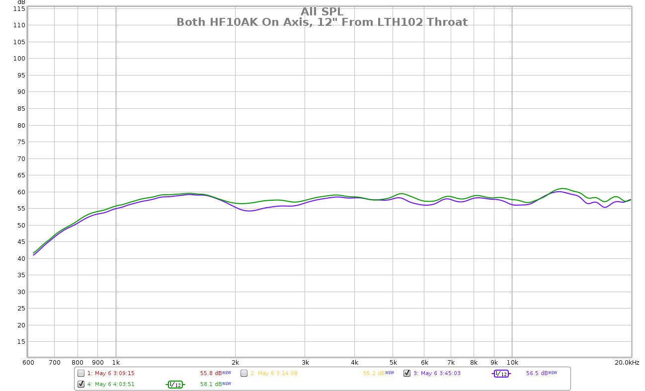

By the way I could not sleep thinking on this so took the hassle and quick tested each HF10AK against the PRV D280Ti-B.
Here are the REW quick tests:
Violet: FaitalPro HF10AK #1 RE 6.3ohms
Green: FaitalPro HF10AK #2 RE 5.8ohms
At this point non sure if I should ask for a replacements or an matched HF10AK pair, as the later lead that they need to open the original packages to take measurements, and I should had to pray for USPS not to drop the package even harder than they arrive dancing and sparkling inside the box lol.
Regards

Here is a less scaled image topping 115dB, they look pretty much same but have about ~2dB'ish diff, interestingly the D280Ti-B both measured RE very close and they still had about ~1dB'ish diff and about ~2dB in the 6KHz region like shown on the previous image.
Still unsure if I take the risk again with USPS(as UPS/Fedex overcharge to my location for few pounds) and return for a replacements, or keep dreaming that some company will sell the HF10AK or others diaphragms in true matched pairs(like wen buying tubes), so I can get a pair on the future when replacement time arrives.
Between sounded the same by hear(pure speculations) but a tad of level adjust may fix this, also understand that this is not like buying matched TAD driver$$$, but I still think when drivers past they $200 tag, they at least should put a label of they actual RE wen factory packed
, so distributors can at least group them in pairs or at least sell them based on they closest RE to avoid this kind of issues.

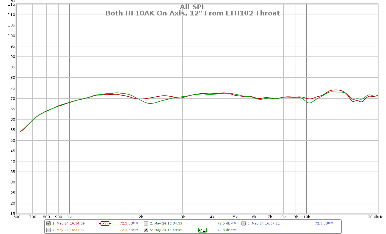

REW testing(Room environment changed):

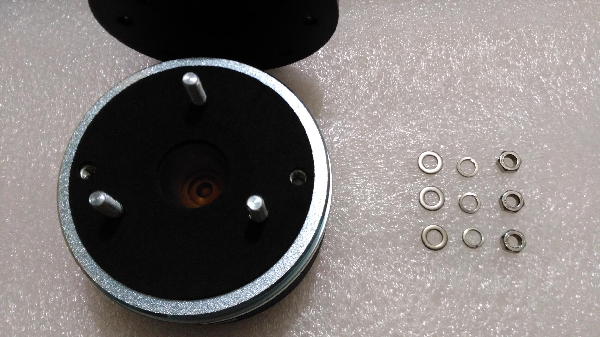

Drivers inspected and ready to be mounted with third party stainless steel hardware,the washer, lock-washer and the nut.🙂
REW quick test on the new CD's:
This drivers looks alot more balanced across the Fq and only small PEQ in the 2.1~2.8Khz and 10~12Khz is only needed to perfect match them.
Old CD's REW test for comparison:
This older drivers requires some level/peq in the 2~3Khz, 5~8Khz, 9~12Khz and 15~18Khz, however the audio image still suffers when cranked to high volumes.
