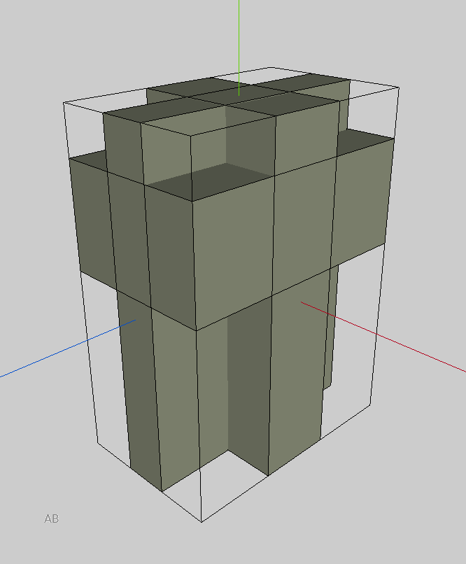

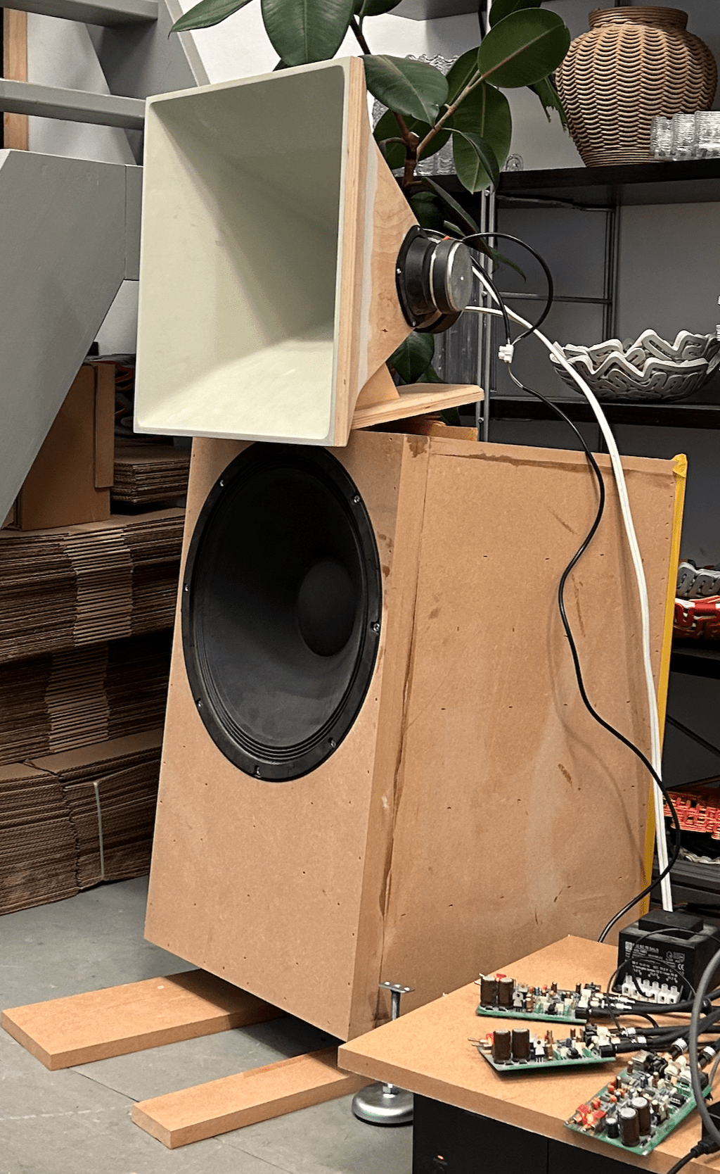

I am working on a speaker set for home use. I've already build the unity horns a while ago and pairing them with Faital Pro 15pr400 bass drivers (see pictures)
The cabinet is a bit over-constructed but it was fun making it... I finished one of them and filled it with damping wool. BUT this is where I need some help; The inside walls are just plain mdf, not covered so a lot of reflections inside... The cabinet is too dense with bracing to be able to reach all spots to cover them in any damping material... and I can not open the cabinet; everything is glued and nailed into place..
Ideally I would cover the inside walls with some bitumen pads but that would just be impossible due to the above reason... I could stuff it and glue the reachable parts with melamine sponges or something similar..
Any tips on this?

Is the internal skeleton pressed against the magnet? What frequency range do you plan on running the woofer up to, and what XO slope?

Hi, it’s not pressing against the magnet just a small clearance of 2cm approx. It’s crossed at 300hz with the horns, no definite slope yet; I’ve had no time measuring them so did the crossover by hearing.

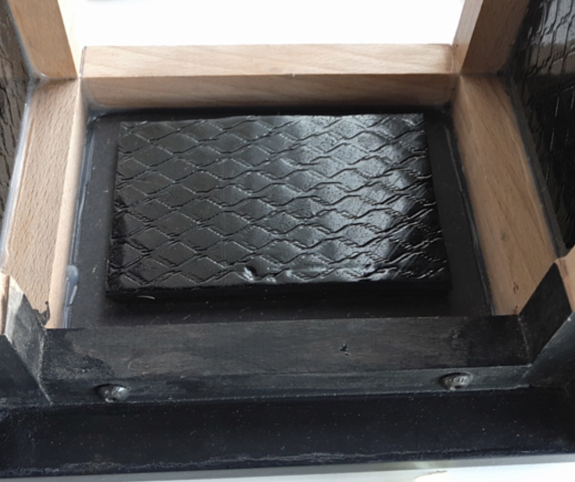

I think I can reach a good part around the driver with these bitumen slaps. I’ll give that a try.. the rest I can fill up with polyester damping (from pillows). The cabinets are about 115 liters netto, what is a good amount of infill for that?
What I mean by bitumen pads see picture:
Thanks for all the reply’s
Don't expect too much from the bitumen. You build a perfect enclosure and it does not help much in the low region you will use it.
Just stuff polyester pillow inside, this will enlarge the virtual volume and damp any echo. Stuff means fill it completely, but do not compress it too much.
To find the best amount used, do some impedance tests, the lowest Fs is the optimum, giving the largest virtual volume.
If you have polyester in sheet form, cut a piece that separates the driver from the loose stuffing and position it before closing the cabinet.
