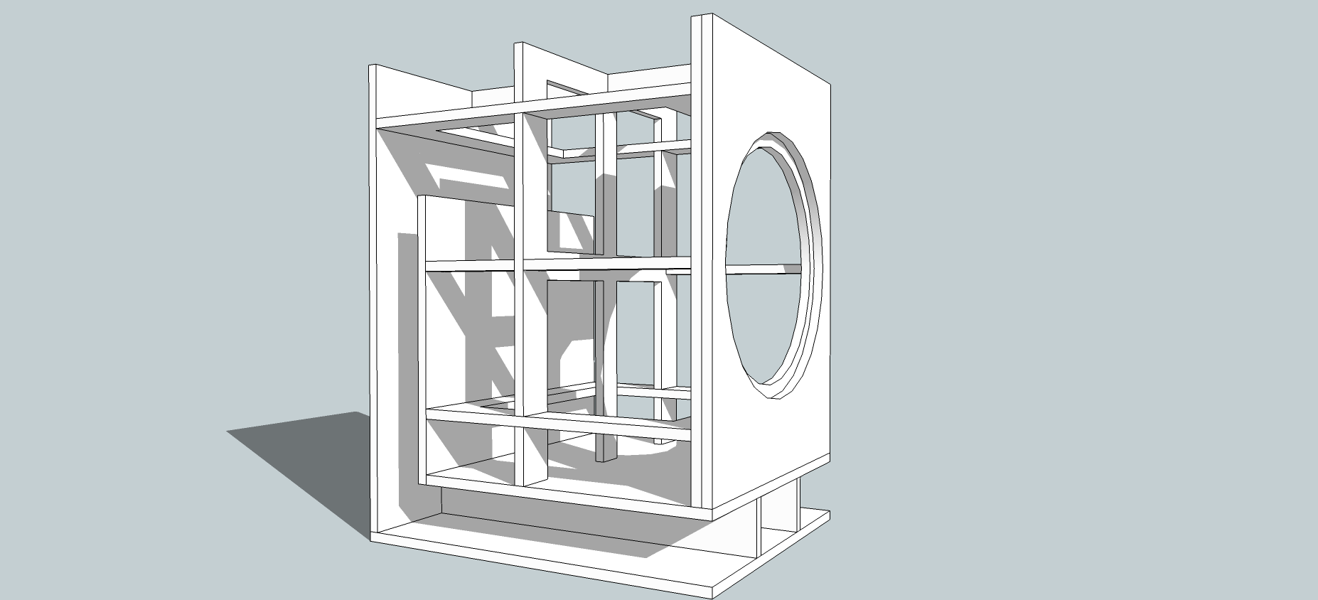

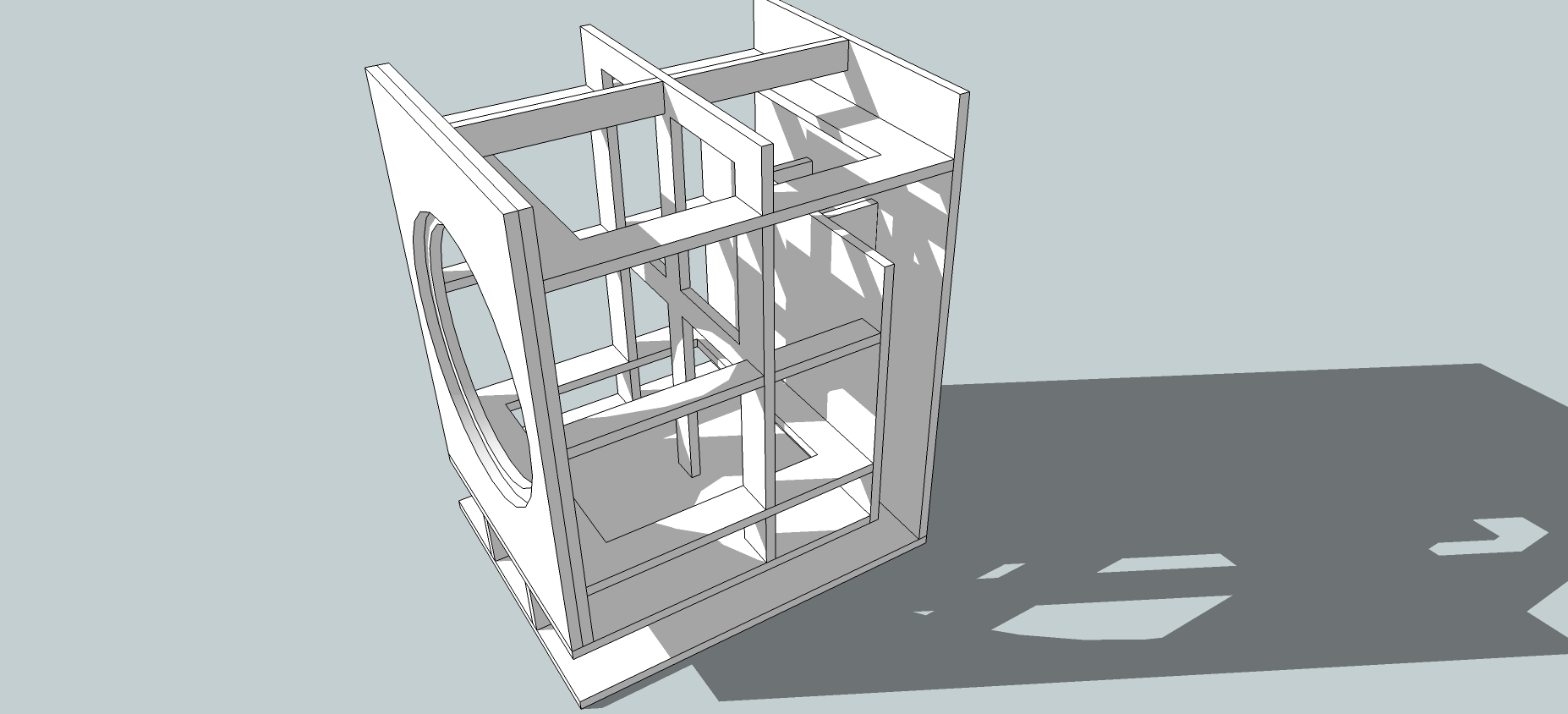

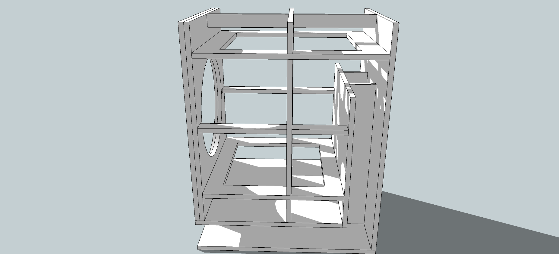

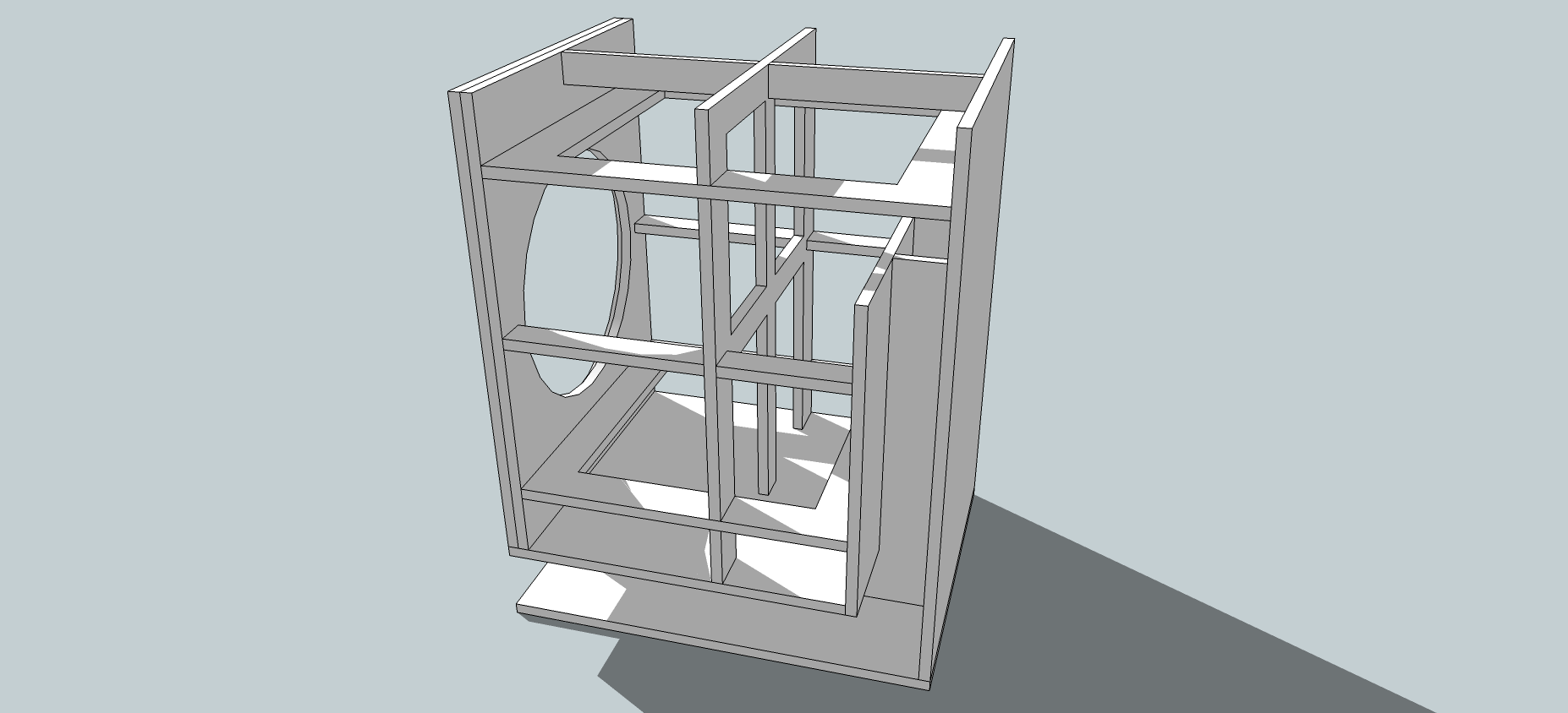

The sim is just a start point, a new sim with 220L. and increased backwall damping has cleared out the box resonances in the graph. Diaphragm displacement at 30hz is 0,7mm.
Sir,
Are you 100% committed to using a sealed enclosure ?
FWIW, I went back through and read every single post of this thread. Many posters have made some excellent points, and there is also some needless bickering. You know, there is somewhat of a difference between a voltage SPL spec (aka sensitivity) verses true system efficiency.
I have sim for this driver for BR with (250L + 61L-BR = 313L) and it is quite linear 1Pi, 2.83V
19 Hz = 96,96 dB
100 Hz = 100,83 dB
19 Hz = 96,96 dB
100 Hz = 100,83 dB
Very interesting design, similar to the one on eighteen sound site, which woofer did you used for the simulation? Have you built it?
This is my own design I was using SketchUp8 program, sim have done for Faital 18XL1800 and for BMS 18N862 and for BC 18SW118 and for Faital 18XL1600 they are all good with almost the same frequency responce and SPL +/- 1 dB. I have 4 big TH subwoofers this design I have made for one of my friend, hope to built it this spring for him!
hello love your desine i am new to forum and dont udestand your chart measurement.This is my own design I was using SketchUp8 program, sim have done for Faital 18XL1800 and for BMS 18N862 and for BC 18SW118 and for Faital 18XL1600 they are all good with almost the same frequency responce and SPL +/- 1 dB. I have 4 big TH subwoofers this design I have made for one of my friend, hope to built it this spring for him!
coud you tell me the dimentions of the desine. i have a pair of faital18xl 1800
and if you agree would like to build your desine.
