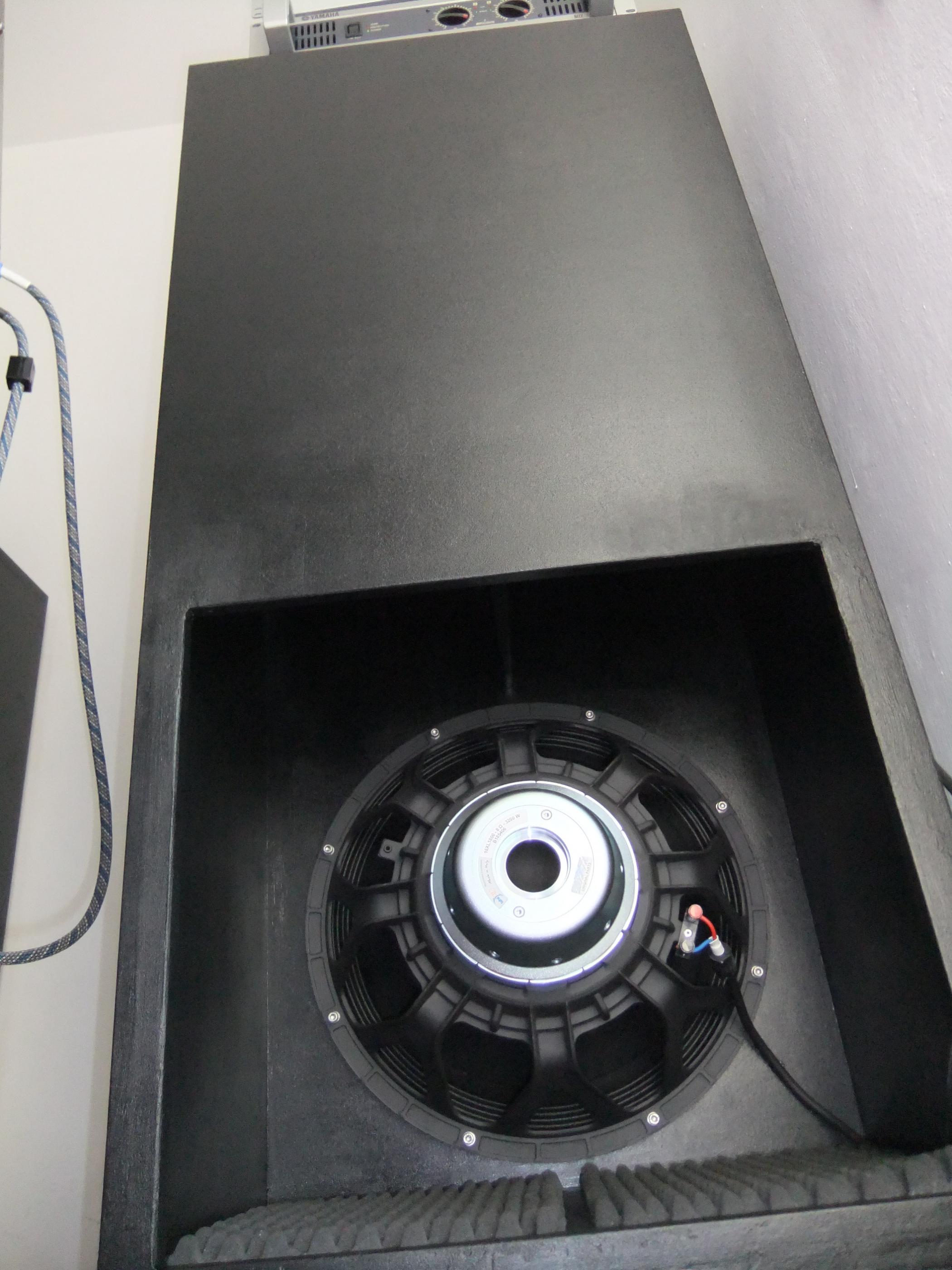

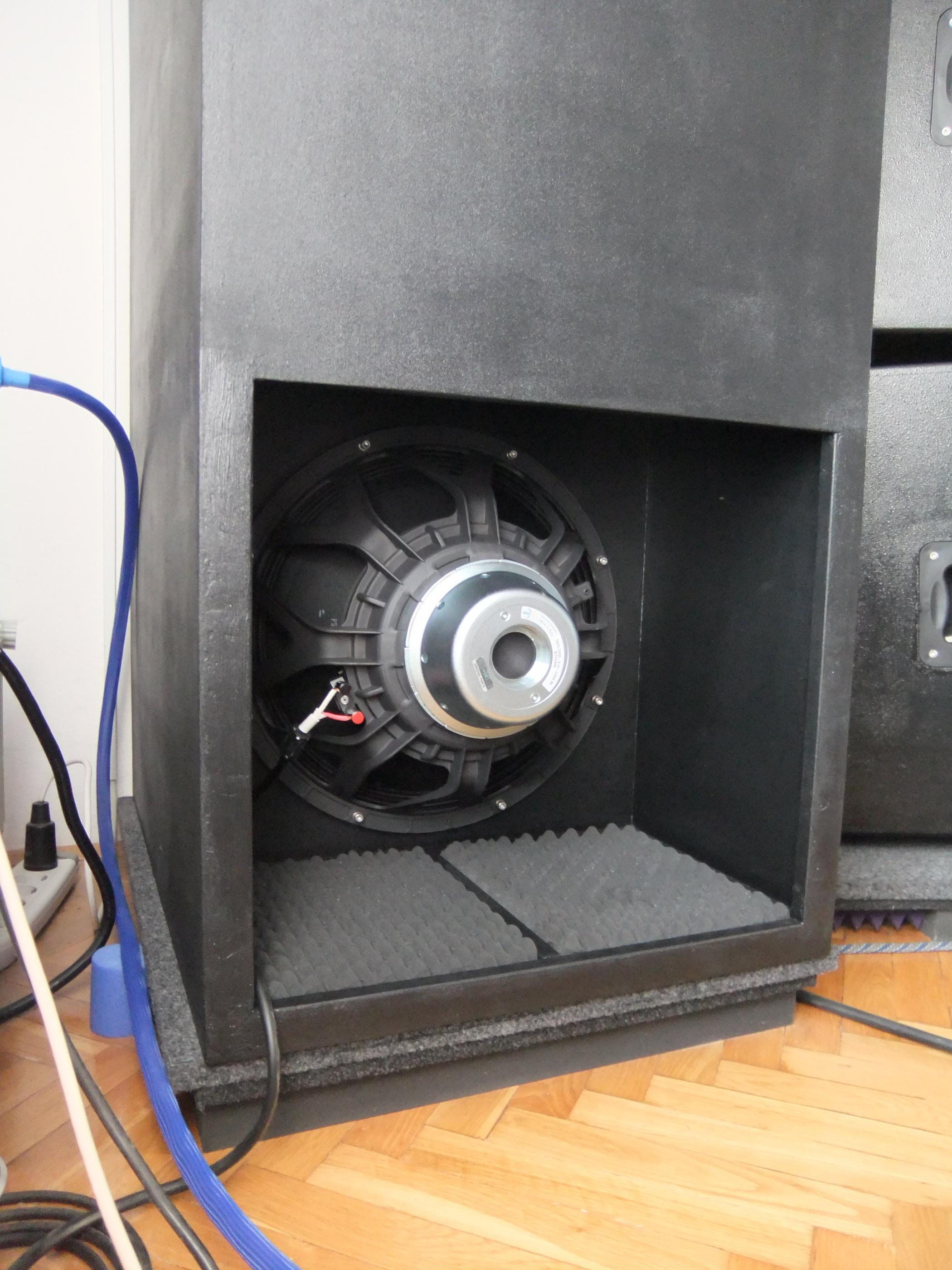

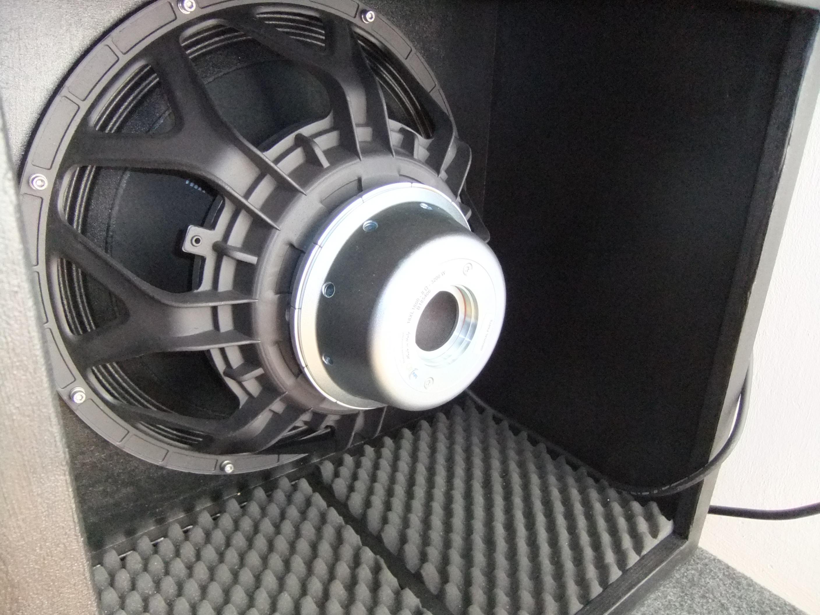

Yes a lot of fun with 2 x TH with this drivers. 🙂

Wow!
Can you share some impressions? Do the drivers live up to the 20mm Xmax?

Did not try that yet (20mm Xmax) as I am always listening at the same time 4 x TH_1819 two with Faital 18XL1800 and two with BC 18SW115.
