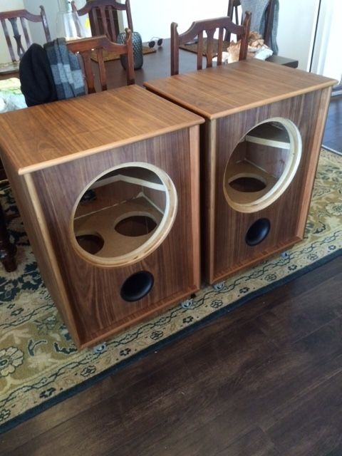

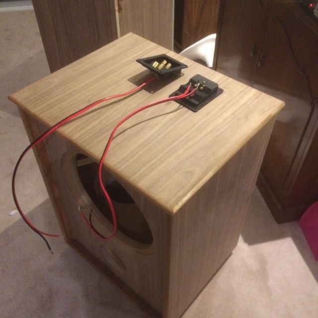

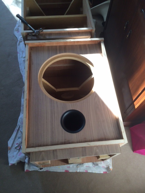

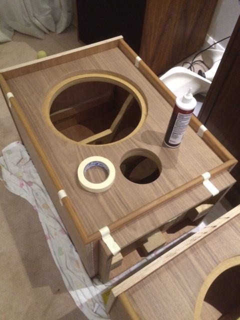

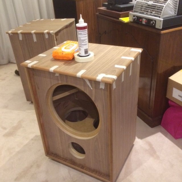

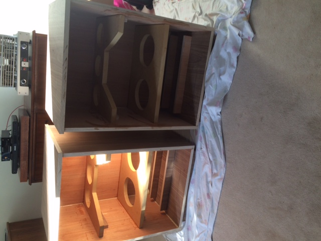

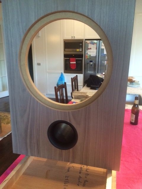

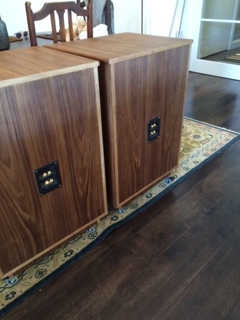

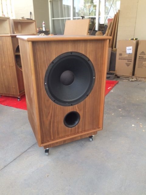

This is a new project, using American Walnut veneer over Euro Birch ply.
25mm MDF rear baffle.
Cedar trim being added tonight.
Double braced.

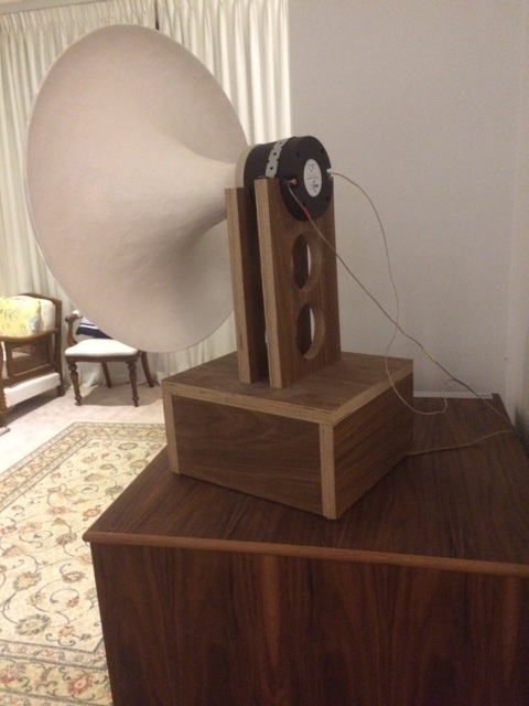

The bass cabinet will be used with Azura 340HZ horn, with matching Walnut stands.
High grade custom xovers.
Double braced.
Beautiful craftmanship...the edge trim creates a piece of furniture instead of a speaker.

Thanks Linesource
What is C to C?
Also, we're not set on 600Hz xover...my xover guy is very good at getting the optimum point, then building a great unit based on measurements and quality parts.
I said 600 as this was double the cutoff of the horn, plus the FP HF200 driver can handle it....but it could just as well be 1,000 or 1,200Hz....but then why use a big horn...?
Cheers
What is C to C?
Cheers

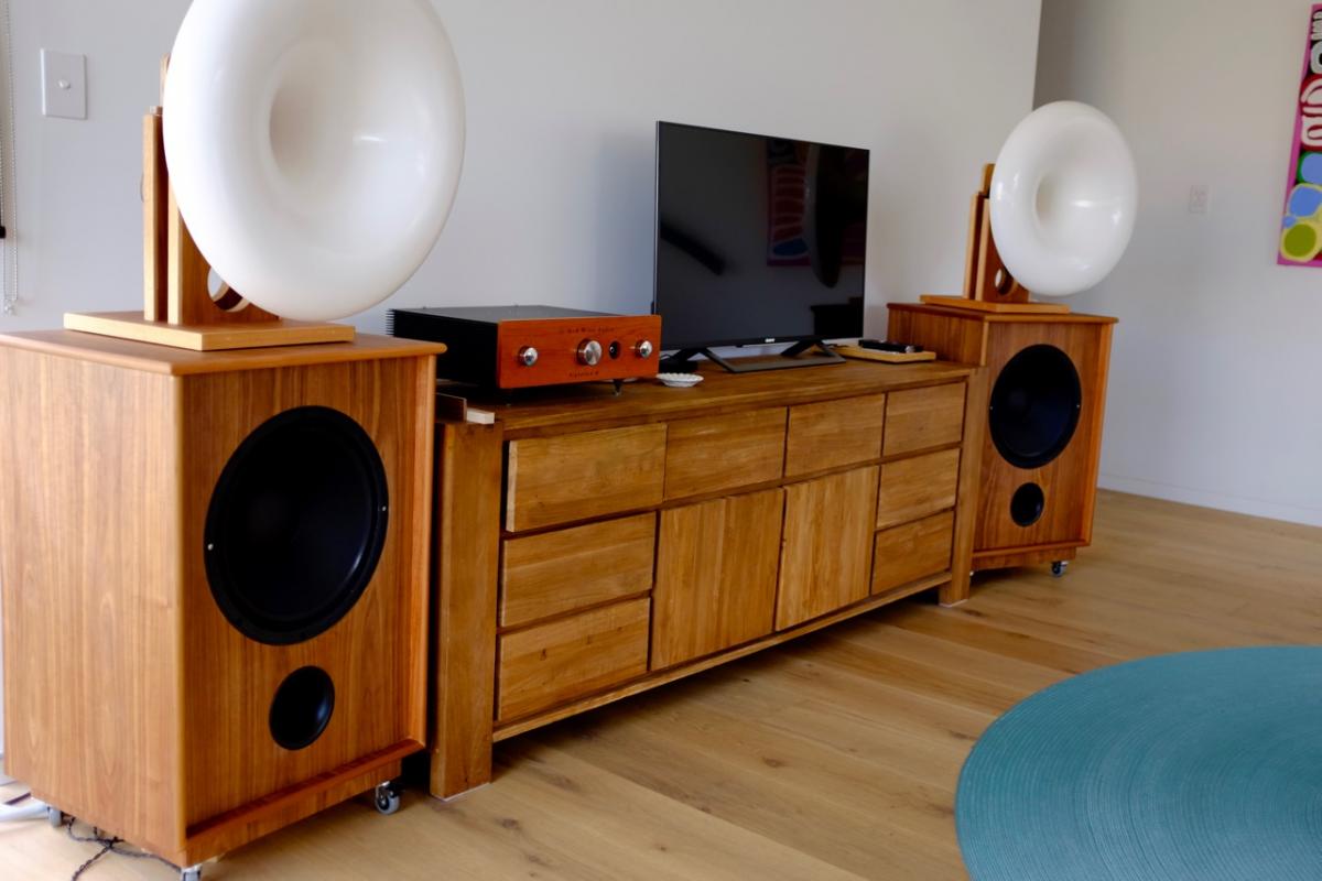

Very good looking. In the pic with all the horn speakers Dan and I built the horn for the center lower one. They sound great.
