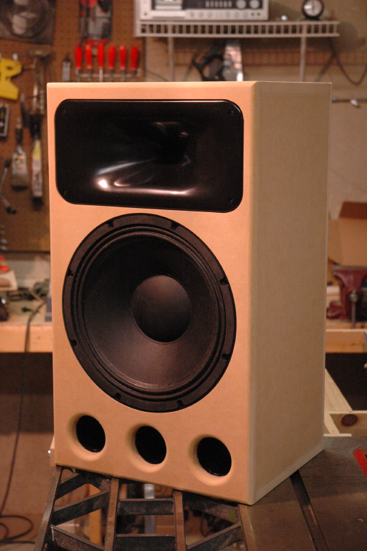

Faital Pro 12PR300 + SEOS-12/DNA-360 Comments?
I am having a hard look at starting to pick up the parts for this build. I really want to try the SEOS waveguide and I am looking for a high efficiency two-way with a largish woofer.

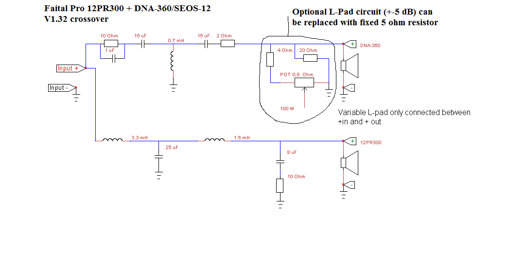

I am looking for comments or criticisims on the design especially concerning the crossover and box tuning. I am a diehard fullrange fan but I am trying to broaden my horizons😱
Anyone built this or anything similar?

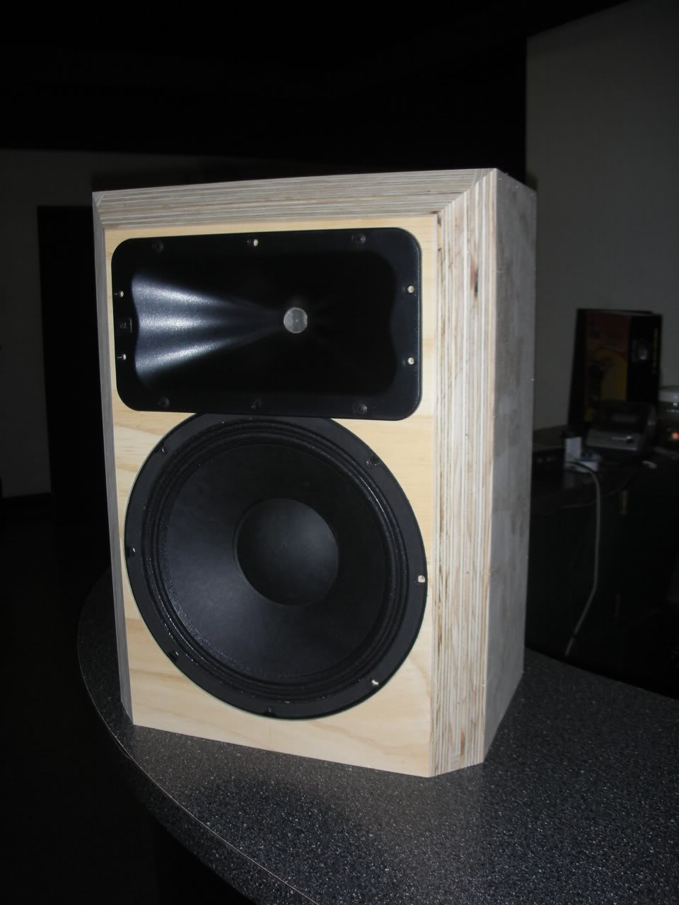

This may help you get a little more out of the pr300 as well as improving the impedance response, making crossover work a little easier. box is 16" wide x 15" deep and about 28" tall. Should be able to add horn on top in separate enclosure and have about 36-40" tall speaker with mid point between horn and woofer at about 32". Could look a lot like this, at least that is what I was thinking. THe TD12s goes even lower in a smaller enclosure. THe next best, LF wise in similar cabinet, is 3012LF
Thanks for the reply buzz. I think I have decided to go with the MiniDSP to have more flexibility in tailoring the response to my room.
