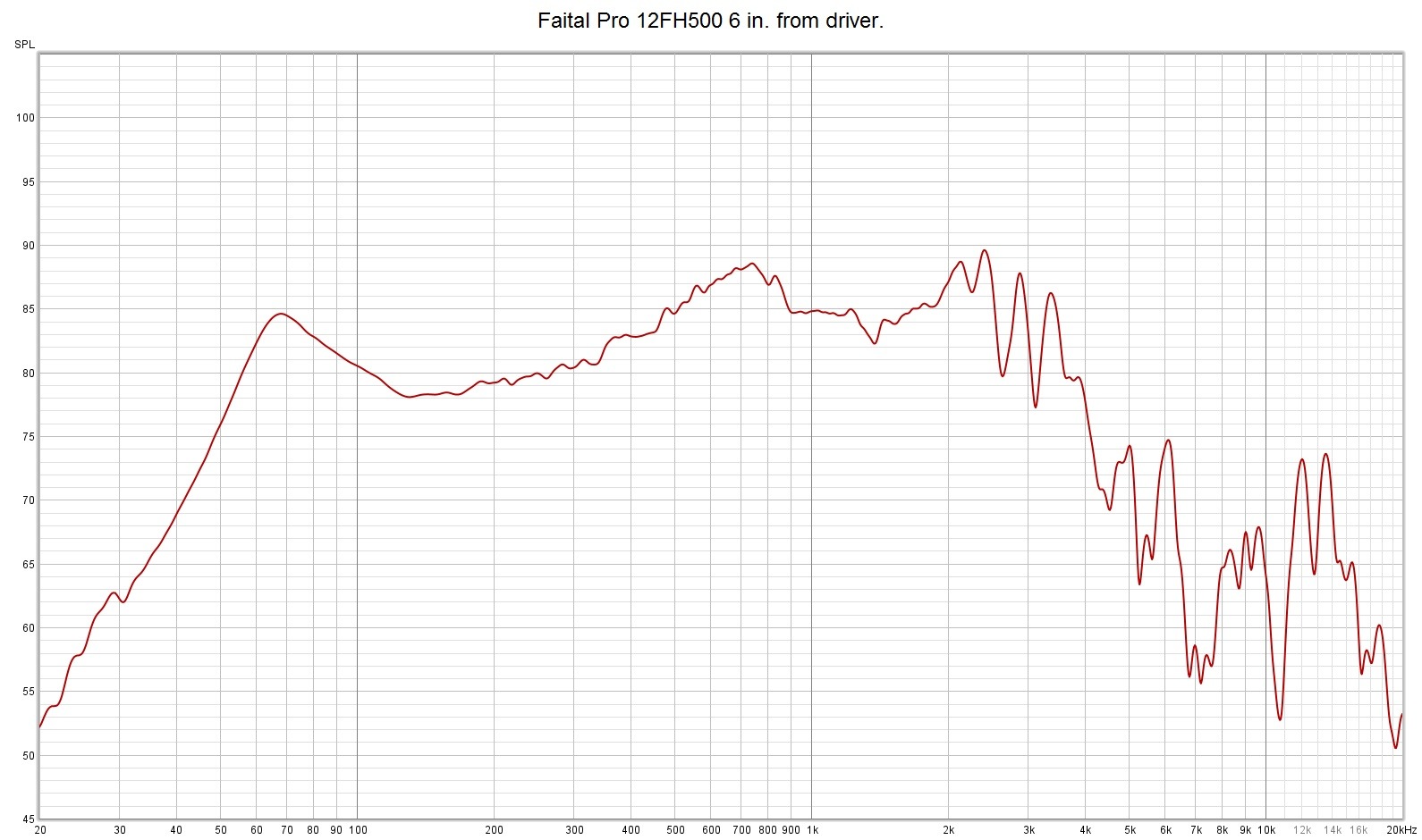

Madisound had a special on the Faital Pro 12FH500 12" Woofers, so I picked up a couple. The measurements in DATS are quite different from the mfg published specifications. For example I measured Fs at 67 hz. and the specification is 45 hz. See my DATS measurements below.
But, both drivers measure very close to each other and I have not broken in the drivers. For my purposes I am not too troubled by the discrepancy in measurements, I was interested in experimenting with a neodymium magnet driver with high efficiency and low Q and I always planned to use measured values. But, this might suggest this driver might not provide as much LF extension as some might be expecting from the published specs.

Here's an SPL plot from REW taken 6" from driver. Just a quick look, but confirms the Fs value.

Fairly common with prosound drivers. Fs will drop with use. I think DATS can test at different voltages as well. That might give you more accurate numbers.
I had the same issue with some SB Audience 12's. Took quite a few hours of high power use before they made the bass I expected.
Fully expected. According the the developer of the DATS it guesses teh T/S from the impedance curve, decreasing accuracy, the QC on these seems poor, and they collapse the T/S curves in a different place.
I have not had any experience with Faital Pro woofers, but in general i will use the factory numbers first for modeling.
DATS is useful for matching drivers, if you use the numbers generated you will likely not design as good a box.

You are gonna do two things: break it in, and put it in a box. Break-in reduces the stiffness. Box increases stiffness. The mass is not going to change, and the BL can hardly change.
Changing the stiffness changes Fs but not mass or BL, so is not real important, except that we like to work with it. The Q (all of them) will change with Fs in predictable ways.
As a practical mechanic, I like to know Fs/Qts, a high-order figure of "merit". If I put it in a box so small that in-box Fs doubles, Qts also doubles (nearly).

The test and factory numbers are within 5%. The worst discrepancy in real life is half a dB over about an octave. That's close enough for anybody. (If you work to sub-dB precision you want detailed EQ and a magic room).
DATS does not tell Mass? It will if you get Fs, add an ounce or two of modeling clay to the cone, and get Fs again, do math. I'd be shocked if DATS does not tell you how to do this.
Knowing actual Mass against spec Mms we can know if they gave you a heavy cone or a weak magnet. It makes little difference in the midrange but the bass may tune slightly different.
If you "need" response to 50Hz, the 67Hz driver need a lot of break-in. But 600 Watts (even 100!) at 50Hz from a hot Twelve is silly.
