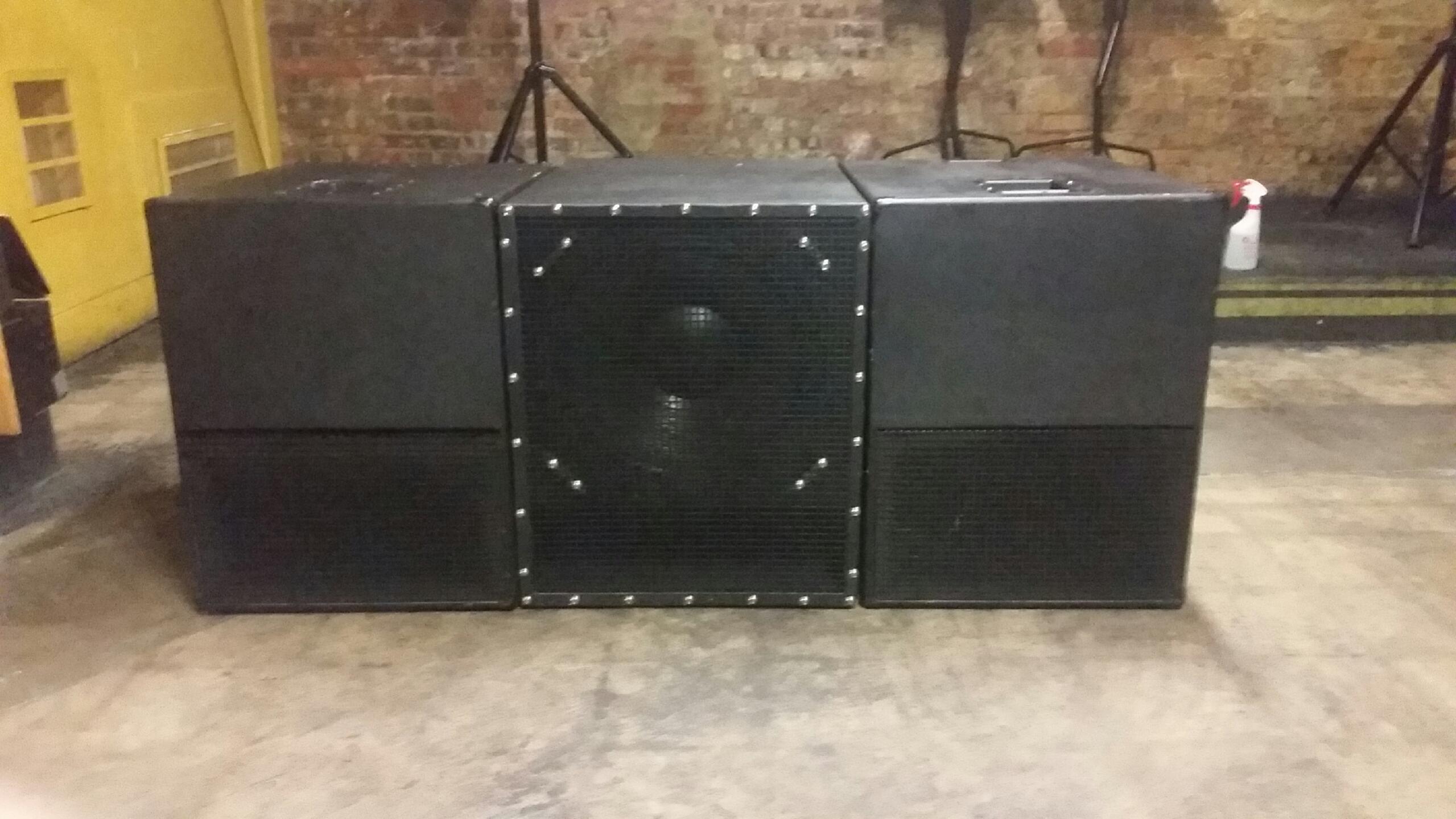

I'm *very* happy with this bass reflex box. It absolutely bangs, and has been entertaining an average dancefloor of 100 people since its installation, with a bridged ancient crest amp on it. (think about 1kw into 8 ohms).
I recently paired it with my 2 OTH40c (not in the fashion shown in the pic, ,that was just a beauty shot) at the venue its installed in. took a little work with the delay, filter settings, and placement (ended up with about 40 ft between the 2 different designs, both of them wall loaded) for a party we hosted (Innamind Recording US tour featuring LAS and Kursk). bass was clean (not muddy as I feared it would be mixing TH with BR) and coverage was surprisingly even throughout the bassment venue (about 45ft x 75 ft, 12 ft ceilings)
