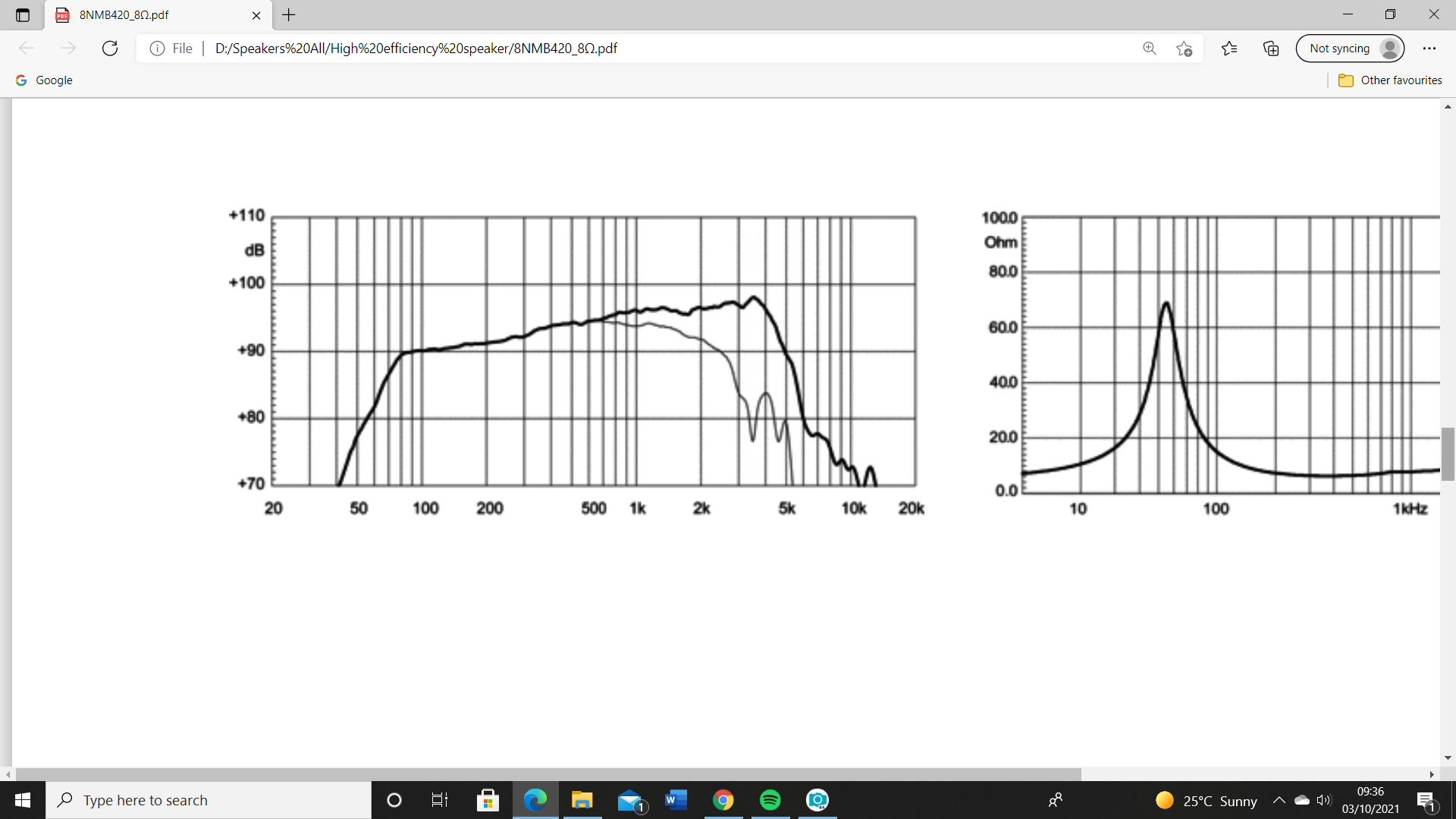

Woofer: Faitalpro 15FH500 8 , Mid: 18 Sound 8NMB420 8, CD: 1 inch Faital HF108R. Horn: Faital STH100.
I am aiming for high efficiency even though I really don't need it. I am chasing the fabled dynamics and detail that I believe these systems can give. And I miss the sound of a large woofer (had many years ago) 🙂
woofer volume: 140L net. Mid cabinet volume: around 18 L net, for closed box Q of about 0.54 Tweeter should be good to cross over around 1500 to 1800Hz I think.

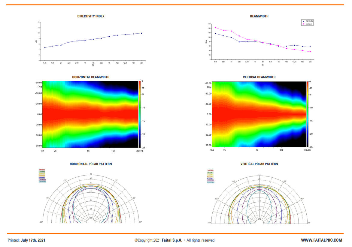

Question. I am looking at the off axis response of the Mid and the horn response. from the Faitalpro gaphs of the STH 100 its a bit difficult to see exactly were the -6db point is. The -6db point of the 18 sound 8nmb420 seems to be around 1800. so I am trying to match these. Is this the correct approach? which graphs should I be looking at please

Hi, the pattern control of STH100 collapses higher in frequency on vertical than horizontal axis. You'll find best xo frequency in simulator after you have built and measured the speaker.

You might not get all the info from a simulator, but looking at the factory beamwidth plots suggest that you begin to compromise if you go below 4k or 5k. If it wasn't for the vertical being narrow, that might come down to 3k.

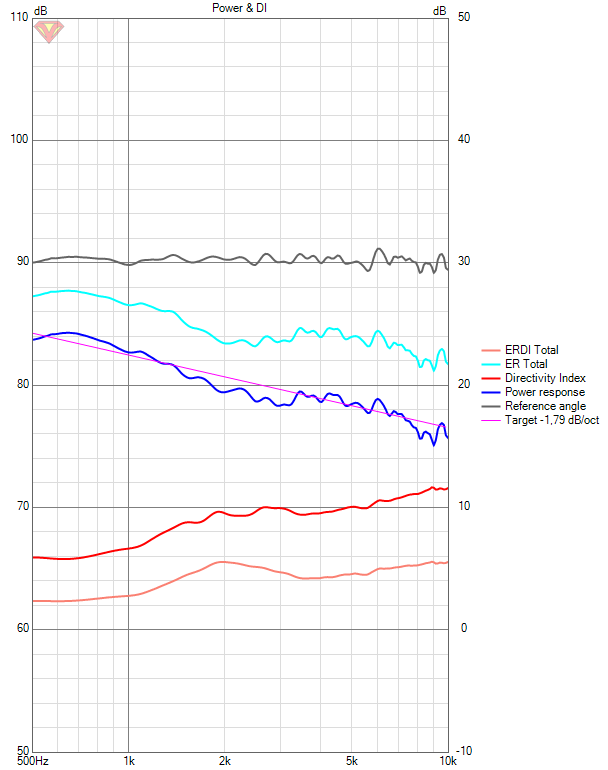

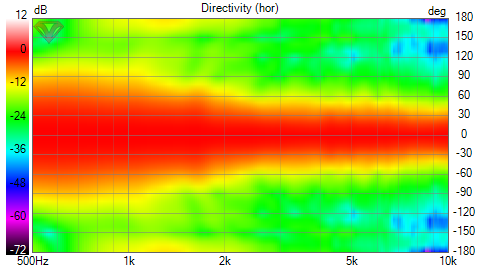

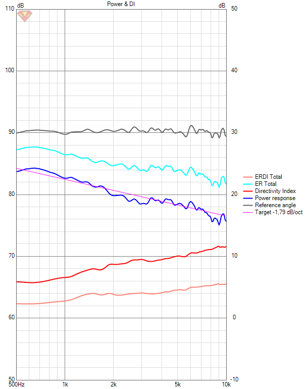

I've been preaching too much on the center to center distance (c-c) at crossover wl lately but here is another because it relates to the statement that seamless transition between STH100 and 8" is possible. The seamless transition to woofer happens in the horizontal plane with xo roughly at 2kHz. In the vertical plane the DI is affected by the interference between the two drivers which the distance between them in relation to xo frequency defines. When the c-c is increased from "as close as possible" physical position to something more, the DI is smoothed and early reflections as well because the first early reflection point in the ceiling and floor have the xo off-axis null or not.
Attachments are,
1. normalized horizontal polars between 8" at 2kHz with with no baffle (as small as possible) and STH100 freestanding on top. The horizontal pattern is not related to the c-c, only to xo frequency. One can make xo somewhat lower and the horizontal polars stay pretty good still.
2. DI, early reflections DI and power when c-c is as close as possible (around 15cm).
3. c-c is increased to ~25cm and the vertical interference is "bettered" to make very smooth transition, almost no hump at all around xo frequency on the transition between the woofer and waveguide. These graphs include effects of both horizontal and vertical off-axis response, horizontal didn't change much with c-c so the "improvement" is due to "better" vertical off-axis response.
If xo was lowered, the vertical interference would change as well as the horizontal. Lowering xo would require even more increasing in the c-c to smoothen the hump in early reflections DI.
All these graphs could be nicer if there was no diffraction, in other words better acoustical properties on the wooferbox and better waveguide. Still, the STH100 is pretty good already.
Attachments are,
