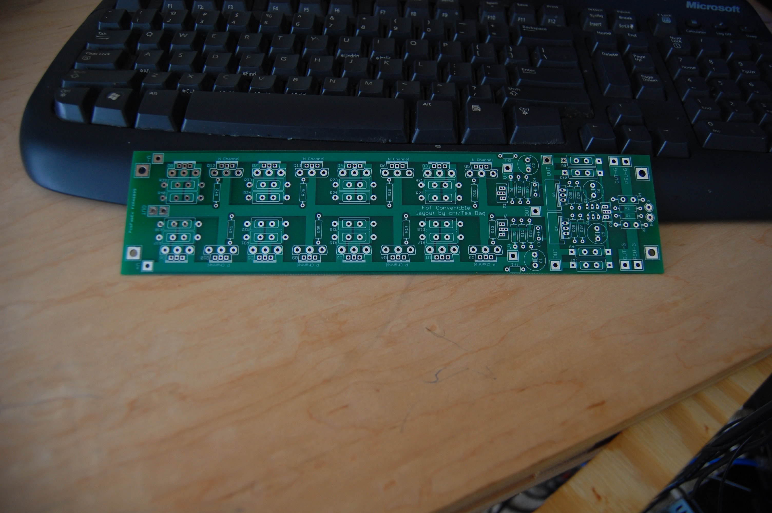

Jacco, Would it be a better idea to sink the diode seperately vs with the fets in order to keep it from the effects of the heat generated by them, or do you want a degree of thermal tracking. With the thermistor you have this already, so it seems that seperation may be a good thing. Sorry to myself for OT comment.
Personally, i'd favor the diodes to track eachother, not the power FETs.
(separate heatsink, lowest possible position in the amp case, likely with a small fan added)
I guess this accomplishes two tasks. Seperates the diodes from the fet heat and at the same time allows for thermal tracking among the diodes. Thanks.
So how much heatsinking does each diode need? Could you just turn them up and mount them to an aluminum bar running between them? What size bar?
Would a bar like this work: 50mm wide x 6mm thick and say 300mm long for 4 each MUR3020?

I'm in the middle of planning the heatsink layout to test some V2 boards and this is new information to me that the diodes should not be mounted on the same heatsink as the MOSFETs.
I keep changing direction and going nowhere.

I understand compromising, don't have enough time to redo it, so I would like to do it right the first time. If I can figure out what right is.
Nothing wrong with that.
Papa takes the safe approach, adjusting the bias setting with the amp as hot as it will ever get.
In effect, conditions will at all times be such that the diodes will never stampede.
Couple of downsides, one is that temperature across a large heatsink varies considerably.
