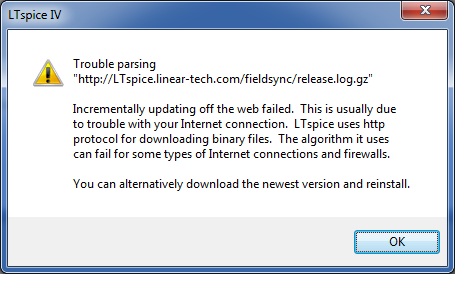

My latest update attempt failed: I ran LTspice as an administrator, as usual, but I got this message:
I tried two more times, with the same result. I made no change to the machine since the last successful update.
I then disabled the firewall, antivirus, but to no avail. Ideas? similar problems?

Can't see the contents of your link, why not attach a snip here?
A number of people seem to be having problems with LTspice lately, but this is the first I have heard of the updater not working. I updated on Friday night.

Interesting, there is a large update downloading right now. Somewhat surprised.
Perhaps the thing to do is uninstall and reinstall the program.

Oh!
I thought you were talking about the latest version XVII.. LTSpiceIV is no longer supported, there will be no further updates as far as I know.

So it looks like I'll have to move to version XVII, but judging from comments gathered on the net, I may have a rough time.
Do you think it would be possible/prudent to keep both versions on the same machine?
If not, how to migrate smoothly and easily from one version to other, transferring all the personal libs, data, etc. I have added during many years.
Does the installation process take care of all this?

LTIV and LTXVII can exist quite happily alongside each other as each will have its own program folder. There is no overlap which means you will have to copy any unique models over.
You might want to look at this and the earlier posts by myself:
